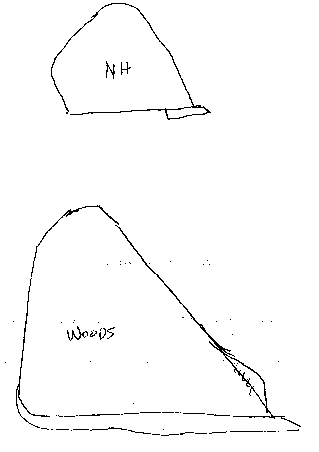

There is a lot of slack in the bucket and cylinder pins. The Woods didn't have that much slack until 300-400 hours of the total 525 hours on it. The scoop bottom is too short or shallow making it remind me somewhat more of a deep dozer blade than a scoop. I find it impossible to skim soft dirt and get a nice heaping scoopful so far. Scoop capacity is very small for the 72" length.
Why NH chose to put a false bottom in the scoop is beyond my comprehension. Ding concealment perhaps? Why not add the metal to the scoop thickness and be more ding resistant?
Up/down modulation is very imprecise. It's hard to skim an inch or 2 withoug gouging or breaking out. The scoop will not touch the ground in the full rolled back position, making smoothing/packing impossible. I will miss this important function. Back grading is also limited if not useless. The scoop fully uncurls mushy, just hanging on the linkage. There are no positive stops! No nice BANG against a stop to dislodge the last clinging dirt. Neither is there a bang at full roll back to jar the dirt level inside the scoop. Just little things for sure, but very important when you move dirt all day long.
Scoop level rod rubs against hydraulic lines when going to full roll back. This will definitely wear holes in the lines. Duct tape to the rescue until the dealer returns with my grill guard and my new hood parts (which were damaged in shipment). I think he can twist or loop the lines to avoid rubbing, but I'm not sure. How about yours?
Shifter is very stiff, 4WD lever is stiffer than stiff. Shuttle shifter is OK...I love it!
See, I've already wrote a big page, and not even warmed up yet. /forums/images/graemlins/crazy.gif
A soon as day breaks, I will hit the pond and see if the FEL is salvagable. Too bad NH put this bucket on the end of such an elegant boom.
Here's my main gripe (see attachment). Drawing is grotesquely exaggerated for clarity. /forums/images/graemlins/tongue.gif
Mind you, this scoop is probably fine for the average dirt slinger, but I move so much dirt that I need good productivity. My TC29 and little 60" Woods loader puts this package to shame so far. I will either have to get better at using it, or work out a trade for another Woods FEL.

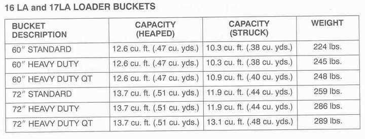

<font color="blue">There is a lot of slack in the bucket and cylinder pins. The Woods didn't have that much slack until 300-400 hours of the total 525 hours on it. The scoop bottom is too short or shallow making it remind me somewhat more of a deep dozer blade than a scoop. I find it impossible to skim soft dirt and get a nice heaping scoopful so far. Scoop capacity is very small for the 72" length.
Why NH chose to put a false bottom in the scoop is beyond my comprehension. Ding concealment perhaps? Why not add the metal to the scoop thickness and be more ding resistant? </font>
Wow! Are you sure you got a New Holland bucket? /forums/images/graemlins/shocked.gif You and I disagree very much on this point and it's got me
scratchin' my head for sure. /forums/images/graemlins/confused.gif I've attached the specs for the NH bucket. You said the Woods 60 in bucket had more capacity, but I checked Woods data and the capacity of their bucket is 11.0 cubic ft. the NH bucket is 11.9 cu. ft struck and 13.7 heaped. Woods doesn't give the heaped capacity. The Woods 66" bucket does come in and 12.1 cubic feet, but that's very close to the 72" standard and heavy duty NH capacity of 11.9. If you had chosen the NH quick attach bucket, it's capacity is 13.1 cu. ft. struck and that exceeds both of the Woods buckets. The Woods 1012 does not have a recommended 72" bucket. You have to go to the 1016 to get the 72" bucket and it's capacity is 13.3 cu ft struck, which is very close to the NH quick attach bucket. I think your sketches are wrong. You may feel that way, but the numbers don't agree with your impression. I sure hope you didn't get the standard bucket. I do agree that the NH standard duty bucket is best suited to hauling manure. It surely can't do any real dirt work. My conclusion is that the 16LAs specs more closely parallel the Woods 1016, but you weren't planning on buying that loader. Also, the NH bucket is just under 300 lb, so that leaves a lot of your loader's lift capacity for the load in the bucket. An 800 lb bucket would mean I lose 500 lb of lift capacity. I'm not sure I'd want that. Do you have any idea what the Woods bucket weighs. The Gannon buckets for skid steers are very heavy, 800 lb ++. /forums/images/graemlins/tongue.gif

Ya, I got the standard bucket. Ya, I wish my bucket was configured like the Woods. I also wish the capacity was as high as the 66" or 72" Woods.
I'll have to try that shaking technique, and get used to the linkage. I have several large conical mounds of of topsoil that I piled with my little TC29 and Woods 1009 loader, and can't for the life of me add to their height. Seems the NH bucket and the linkage combine for a pivot point that is not really at the bucket hinge. My TC29 is gone, so I can't compare side by side. My memory may in fact be defective. /forums/images/graemlins/confused.gif
In my sketch, I did not mean to say the NH bucket was very small compared to the Woods. It was the shape that I was pointing to. The bottom of the Woods scoop is long and flat, and it would skim cleanly and effortlessly. My guess is the NH will perhaps do this too, once I am used to it.
See, when I would level the Woods scoop and skim loose dirt, the bucket would fill and the dirt would heave upward, causing the bucket to fill nicely and round off. The NH doesn't do this, and I'm struggling to learn to round off my scoops. When the Woods would accidentally dig in, I could raise it and keep scooping without breaking rhythm. I must clutch and stop the tractor to raise the NH scoop. I don't know why this is. Perhaps the wider bucket takes way more power to break the dirt loose.
I'll see my dealer and ask him about a deeper bucket if one indeed exists. If he won't trade, no big deal. I'll just buy it. I need a new BBQ pit anyway. /forums/images/graemlins/wink.gif

I think you "nailed it" on the wider 72" bucket taking more power to push. When working in the deep loose sand of my creek bottom, I found myself spinning both rears and both front wheels trying to push the bucket. If I could get the depth just right, it filled and flowed to the top just as you stated. The loose sand made it a challenge. My neighbor has a Kubota 34xx with ag tires and the one time he took it into the creek bottom, he got stuck with an empty bucket and had to use the bucket to pull himself out. I couldn't have cleaned out my creek unless I had the R4s, 4WD, and differential lock. I would have been stuck several times because the loose dry sand gave me very little traction and the wheels tried to sink. The thing I like abut the bucket is that it cuts a swath wider than my wheels. That way I don't end up suspended by ridges on the sides while the center is a narrow trench.
Someone else had a severe problem getting their tractor to engage 4WD, and it was suggested that they raise the front tires with the loader. That worked for them and maybe it might work for you too.
I'll have NH paid off in December of this year and that will give my budget some "play money" to use for tractor add-ons. I'm going to try to upgrade to the quick-attach system and bucket. I may be able to make you a good deal on a heavy-duty bucket with reversible cutter bar.(see attachment) I wanted the quick-attach setup when I got my tractor, but they weren't available. Now everyone who has one seems to really like it.

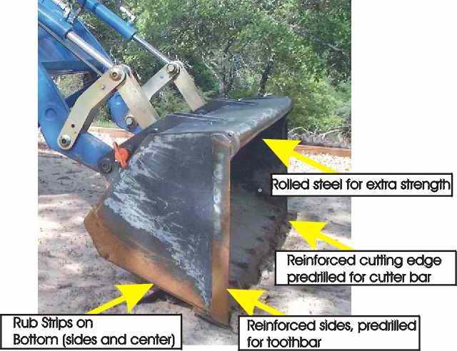

I hear a little voice of ignorance asking "What is the difference in the Std. and the HD bucket?". I can't find a doggoned thing on the Web about it, and NH's web site has nothing. Can you fill me in, just generally? I know there is a slight weight difference, but do not know where the weight is added.
I tried back grading and pushing-packing with fully curled bucket yesterday. It was not pretty. Back grading works only on very fluffydirt where is is not really useful anyway. Pushing-packing does not work at all, because the bucket will not lower fully to the ground. Maybe if I let some air out...ACK! Water, I mean...
   / Is it here yet? #18

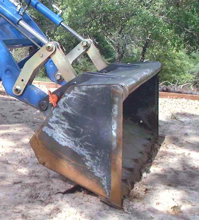

I don't know if the NH HD bucket has different mounting, but my HD bucket will touch the ground when it's curled all the way back and I lower the arms. I'm not sure on that issue, but I think I know the main differences in the buckets and I labeled them on the attached photo.
When I back drag, I normally do it with the cutting edge. I've used the back of the bucket, but I sure prefer the edge because I can change its angle as needed. If I have loose dirt, I float the bucket and vary the angle of the edge for the best result. Of course, if I want the extra weight of a full bucket, I have to use the back of the bucket as you suggest. I'm not sure if my technique is the best, but it works for me.

</font><font color="blue" class="small">( I'm not sure on that issue, but I think I know the main differences in the buckets and I labeled them on the attached photo)</font>
Doh. That's my bucket...
Thanks for the lesson Jim, and thanks for going to all the trouble to edit and post pictures. NH needs more info on their web site. Maybe they'll catch up soon.
