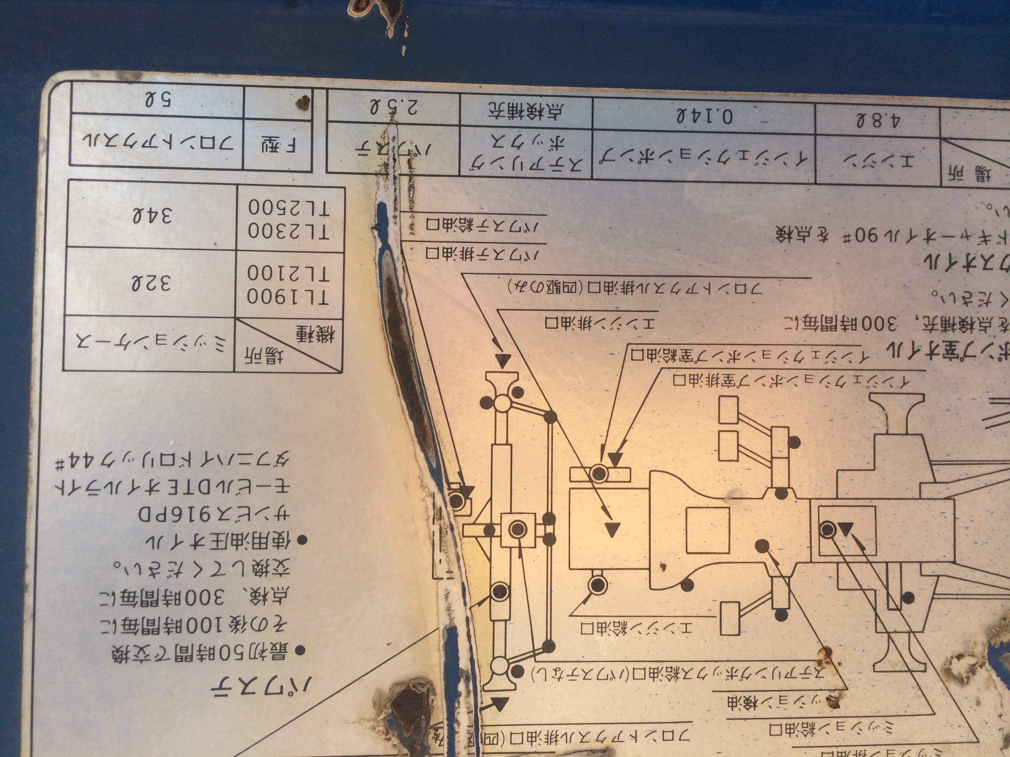

Can someone tell me what this controls.
It says what each one does right under the switches - LOL. Which then begs the question, if the labels for the controls are in Japanese then why is the Iseki name in English letters???? :confused: It would seem odd that if I had a John Deere, for example, that it would be written in Japanese and everything else on it in English.

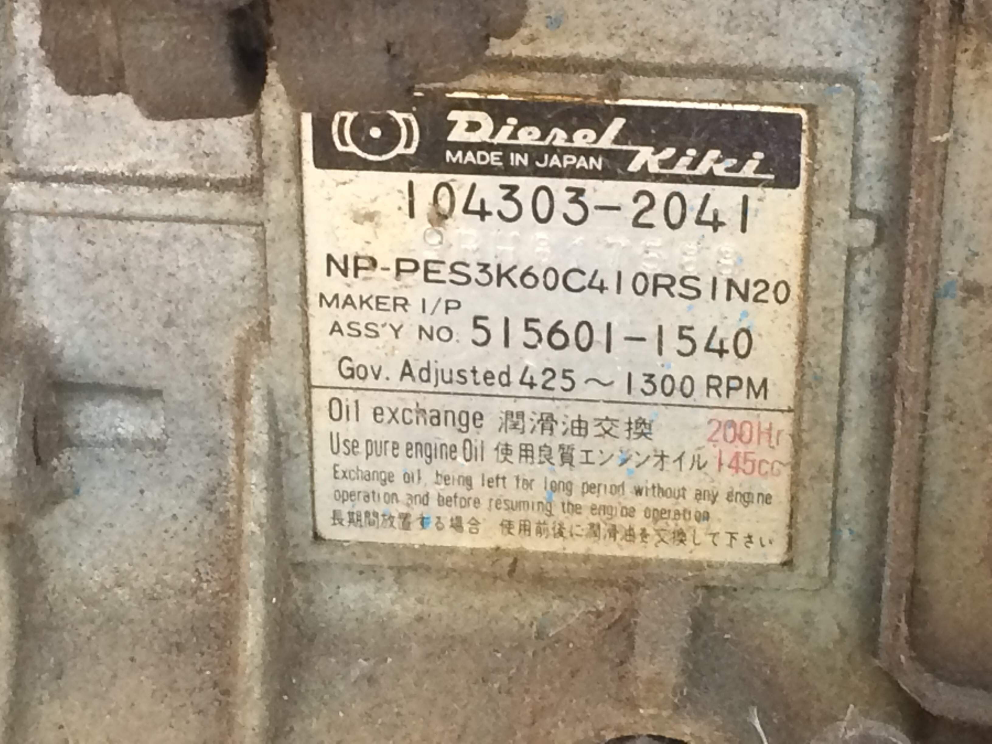

image.jpgI did not see a belly band. One would have helped. I'll get some pics of the underneath. The horse power I'm guessing is 200. Specs on injector pump. Specs sheet under hood bonnet with wiring diagram. The spec says TL

Spec under hood. See numbers an who knows what everything's right here lol

View attachment 382670I did not see a belly band. One would have helped. I'll get some pics of the underneath. The horse power I'm guessing is 200. Specs on injector pump. Specs sheet under hood bonnet with wiring diagram. The spec says TL
I think that says '200 hr' as in oil change interval. No way anyone would put a 200 hp diesel engine in that little tractor. Probably in the low 20 hp range.
As for the switch box with all japanese labels on it, where does that wire go?

200hr and 145cc sounds better. Now that is what I'm seeing. Drained the oil no metal and looked like oil. In town tomorrow will get filters and oil also getting a battery. I might just surprise myself. Would be nice if she ran. Any advice on fluids and starting fluid or not?

The electrical switches on the fender are for your 3 point hitch. The toggle switch is for the hydraulic tilt ( nice feature) the two knob switches are probably used with sensors that attached to original Iseki implements....most likely mainly for a rice paddy tiller. If you have a separate 3 point control lever to raise/ lower the 3PH, you may have to adjust/play with the knobs to get them in the right setting. If you don't have a separate control lever, they are the main controls for the 3PH raise/ lower and fall speed control.
You definitely have a TL model. It is either a 1900, 2100, 2300 or 2500. The first two digits indicate the amount of PTO HP, not engine HP ( engine will have 2-4 more HP than the PTO rating). It is probably either going to have a Isuzu 3AE1 or 3AF1 engine. The TL1900 used the F model (1170 CC) and pretty sure the other models all used a 3AE1 ( 1296CC). I would look for 3AE1 or 3Af1 or maybe 1.17L/1.2L or 1.29L/ 1.3L cast somewhere on the engine block.
