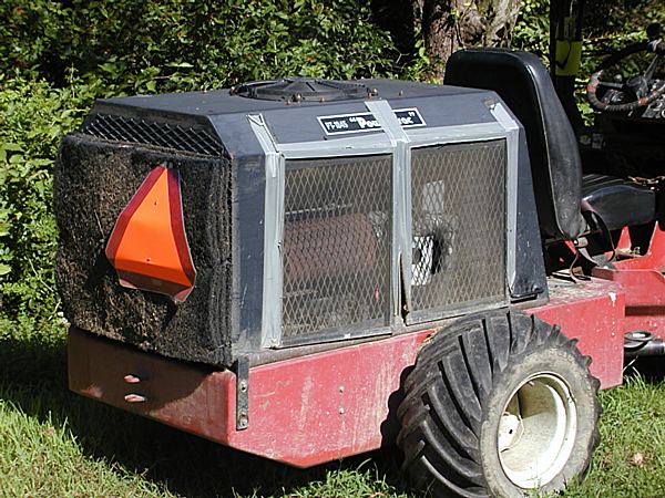

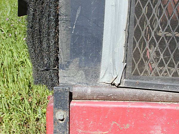

After two hours of pressure washing today, I see yet another design flaw. I do not understand why PT didn't make the belly pan removable (like most equip., bull dozers, etc.) for cleaning and access.
Just an observation about the design--the Duetz engine mounts are mounted directly to the "belly pan" in my 1845 and the front of the pan is the bottom of the hydraulic oil tank. I suppose that a larger access hole could be cut in the pan than the existing small hole to drain the engine oil but a removable belly pan would require an entirely different engine mount system.

The belly pan may contribute significantly to the structural rigidity of the machine. It strikes me as a monocoque design. It's also very simple, which seems to be near the top of PT's design criteria list.
My engine and radiator assembly is bolted to two rails which sit on the belly pan. Even though the belly pan has holes, they do not match up with the nuts and bolts. It is a disign flaw. They could just as easily cut holes right under the lockdown nuts. It is a real pain to uncouple the engine from the frame. You actually need small hands and short wrenches. I have to do this to remove my tram and PTO pump. They left no room at the end to just umbolt and slide the PTO pump off.
