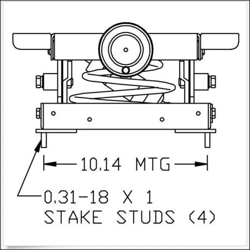

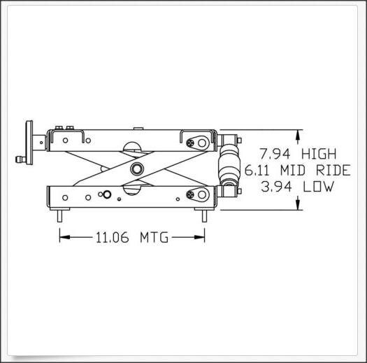

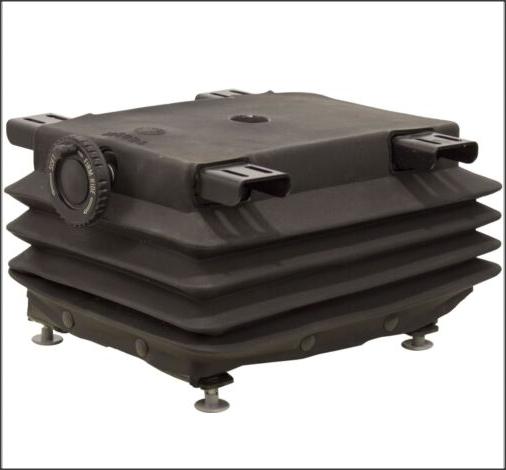

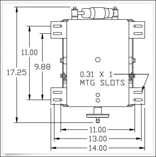

I installed couple of these in my jet boat few years ago and am tempted to "borrow" one of them in order to try out in a mower!
(They cost $330 each at a local boating seat supply specialty shop at the time)
It's a mechanical suspension with heavy duty springs and shock absorber. The height is close to 8 inches which would not be an issue, once the Kubota seat suspension was removed.
These are working very well in my jet boat.
Snap 2019-03-27 at 15.00.11.jpg Snap 2019-03-27 at 09.49.27.jpg Snap 2019-03-27 at 09.49.45.jpg Snap 2019-03-27 at 09.50.04.jpg
Question:
Have any of you tried this type of seat suspension in a mower?
