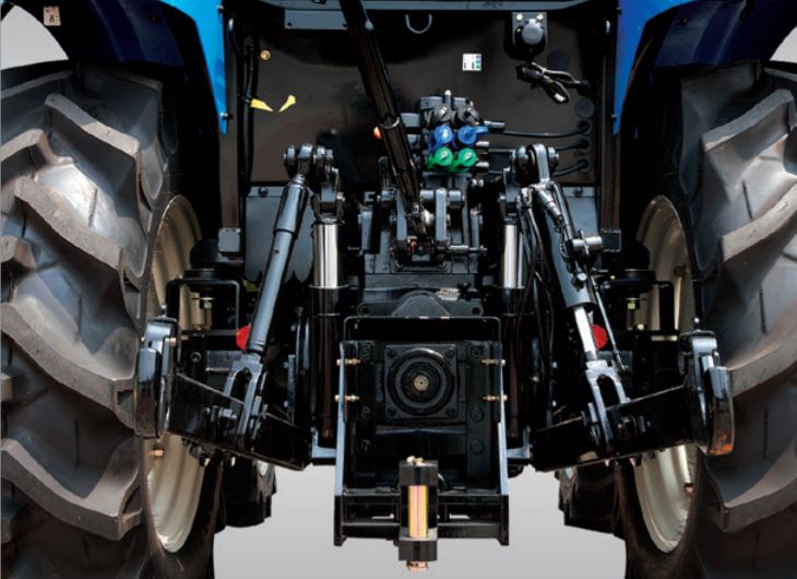

I am not familiar with the Pat System. Will it be necessary to modify my implements?
   / Is a XU5055C or XU6158C Adequate for my Needs? #18
You should not have to modify your implements. You will have to put bushings on any cat 1 implements though.
With practice, you should be able to back up and raise the three point to grab the lower pins. Then you just have to get off and hook up the top link.
Here is a link to the cat 1 version of the Pats quick hitch.
Pat's Quick Hitch, 3 Point Quick Hitch, Tractor Hitch
   / Is a XU5055C or XU6158C Adequate for my Needs? #19
I looked at a tractor with that system and the sales guy said that they can be a little sensitive to dirt and if you want to use them like a quick hitch you will probably have to modify older implements that have the pins attached on just one side. Newer stuff should be fine. A lot of my equipment is old enough to collect social security so I went with a tractor with regular extendable link arms because it gave the most flexibility and would be easier for me to hook up. A winter project for me is to take most of my old stuff and straighten out the hitch mounts and make them regular quick hitch compatible.
