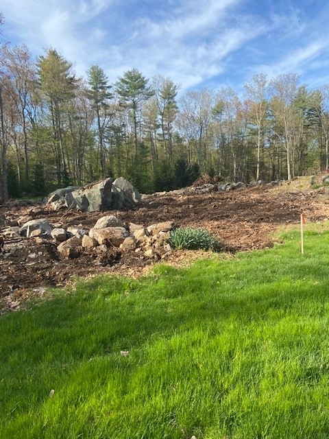

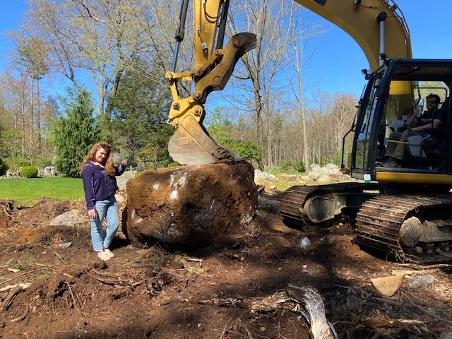

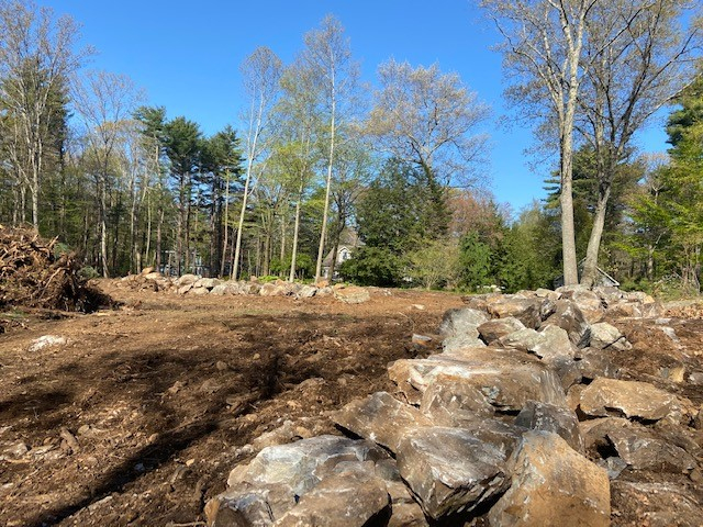

The TR3 looks great - but no rocks like we have in NH. I would lean towards this tool - skeleton grapple https://www.palletforks.com/skid-st...ade-skeleton-rock-grapple-rakes/RBFGGRAP.html
This is a sampling of our rock crop here in NH. That's a Cat 315L (38K pound excavator). This is why harley rakes or any rakes have a tough time here!
That's what I am leaning towards although I do like the ones with the bolt on sides that can be removed to create a deeper bucket for grappling. Either that or but a dedicated rock/skeleton bucket and a root grapple.
