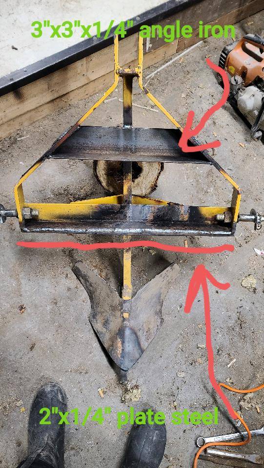

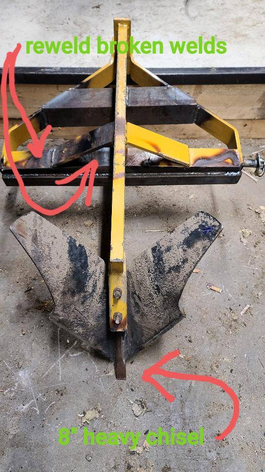

If you dont have either yet, I can recommend 1 tool to do the job, I have a middlebuster that I beefed up with some extra bracing and welded an 8 inch chisel to the back side of the 'blade', the top of the chisel is butted up against the shank of the implement and the chisel extends 2 inches below the blade.
I originally made it for busting up ice on our mountain road in the spring so the water from the melting ice had a path to flow, but it works great for trenching for shallow utility lines in our rocky soil just as well or better.
Here are a couple pictures before I cleaned it up and painted it black so it looks nicer now, but it gives you a general idea of what I am describing. 31341.jpg31342.jpg

Nice job Homesteader13! For my purposes this may be the best bet.
Unfortunately I'm not a welder. Fortunately I have friend who is a very good one. 😄
Thank you for posting the pix
