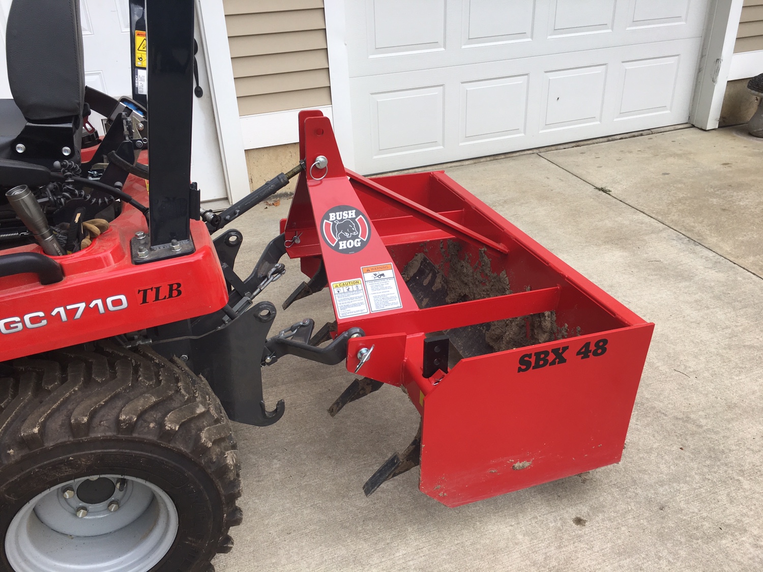

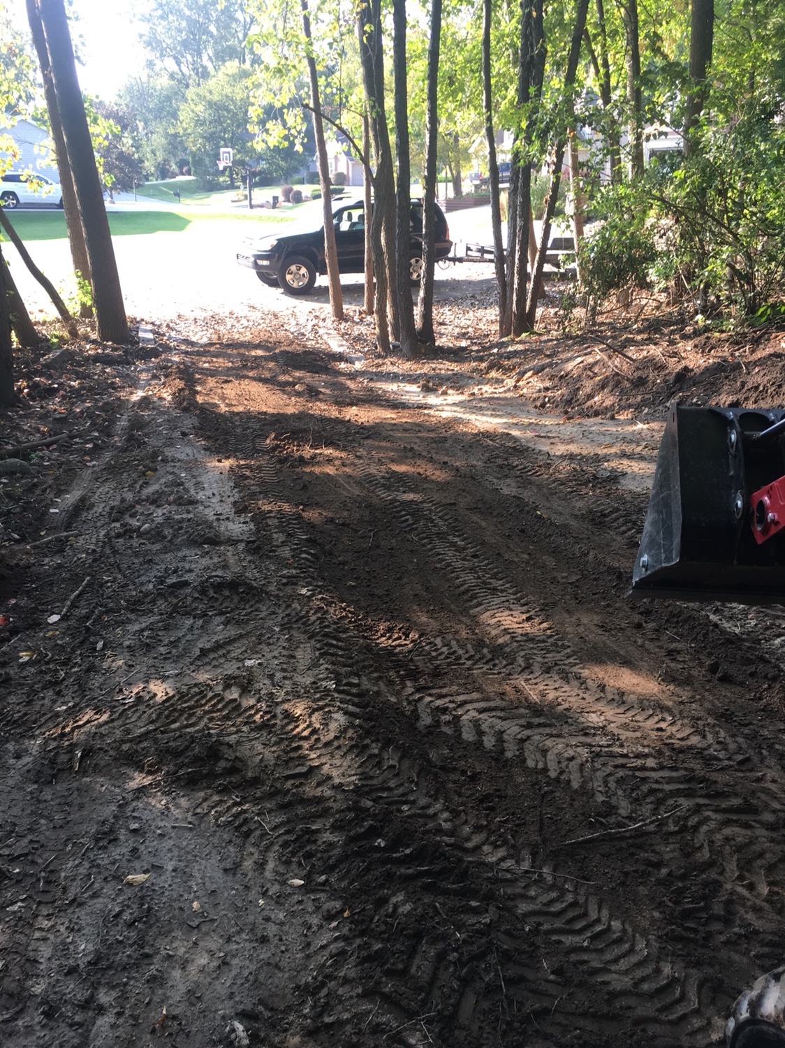

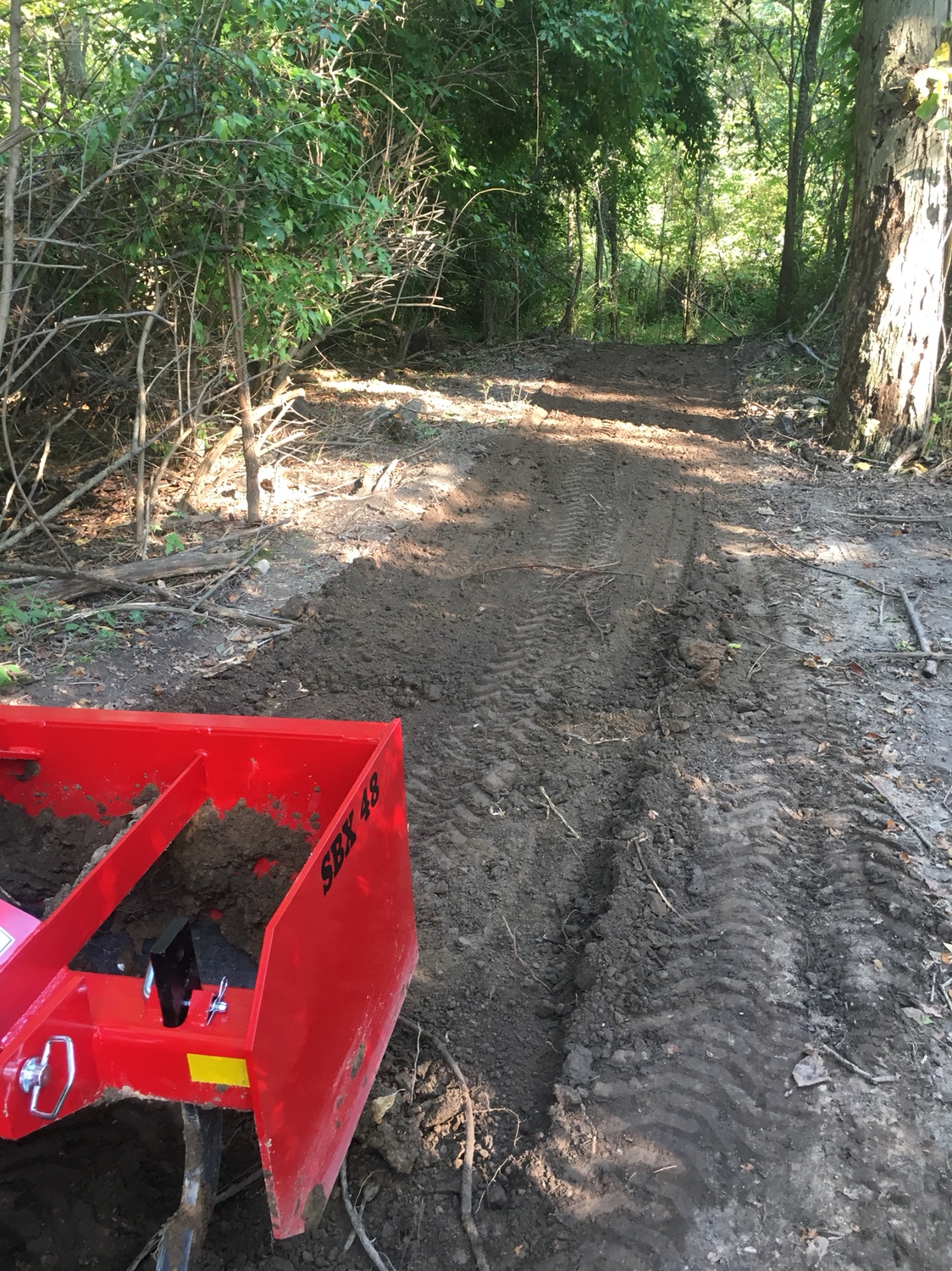

I ended up getting a 48” SBX which for the dirt work I planned and plan on doing with it works well, granted if I fill that box up I have trouble pulling it. If I was going to be working a driveway I’d probably get the lesser weight version. Box weight is a balancing act, you want weight on the shanks for ripping but too much and your tractor can’t pull it full. Doing it again I’d go lighter than the sbx line and add weight if needed.
If you find yourself spinning the rear wheels you’ll need to add weight. I have a 130lb weight in the mower arms, beet juice filled tires, and an additional 130lb weight by my feet when I’m pulling the box blade. If you are stalling your tractor at full throttle you’ve found a good amount of weight!

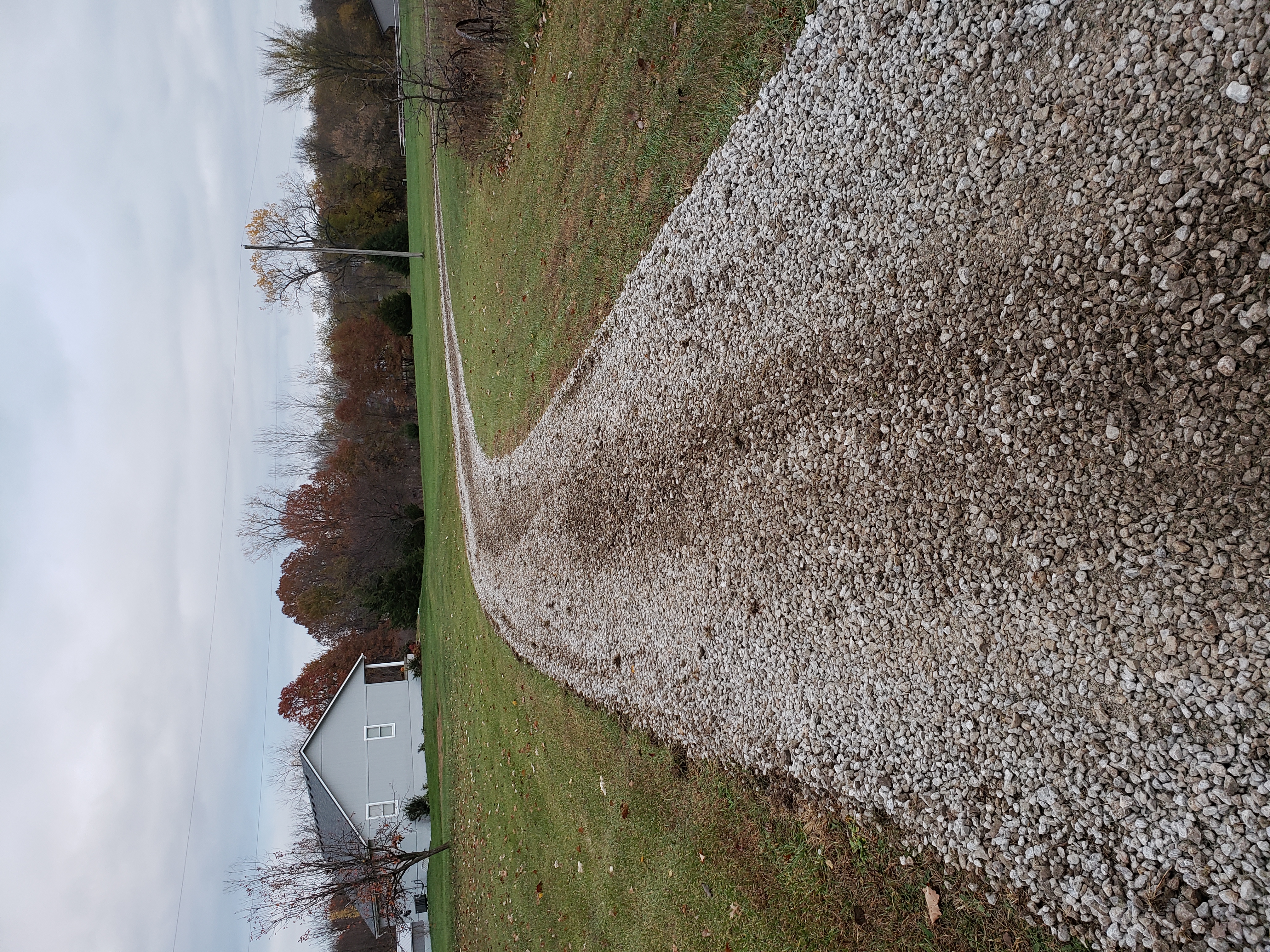

I have a Woods 54" road grader that I use with my 1720. I leave the scarifiers off normally, it pulls fine, we have about 1000 feet of gravel drive.
