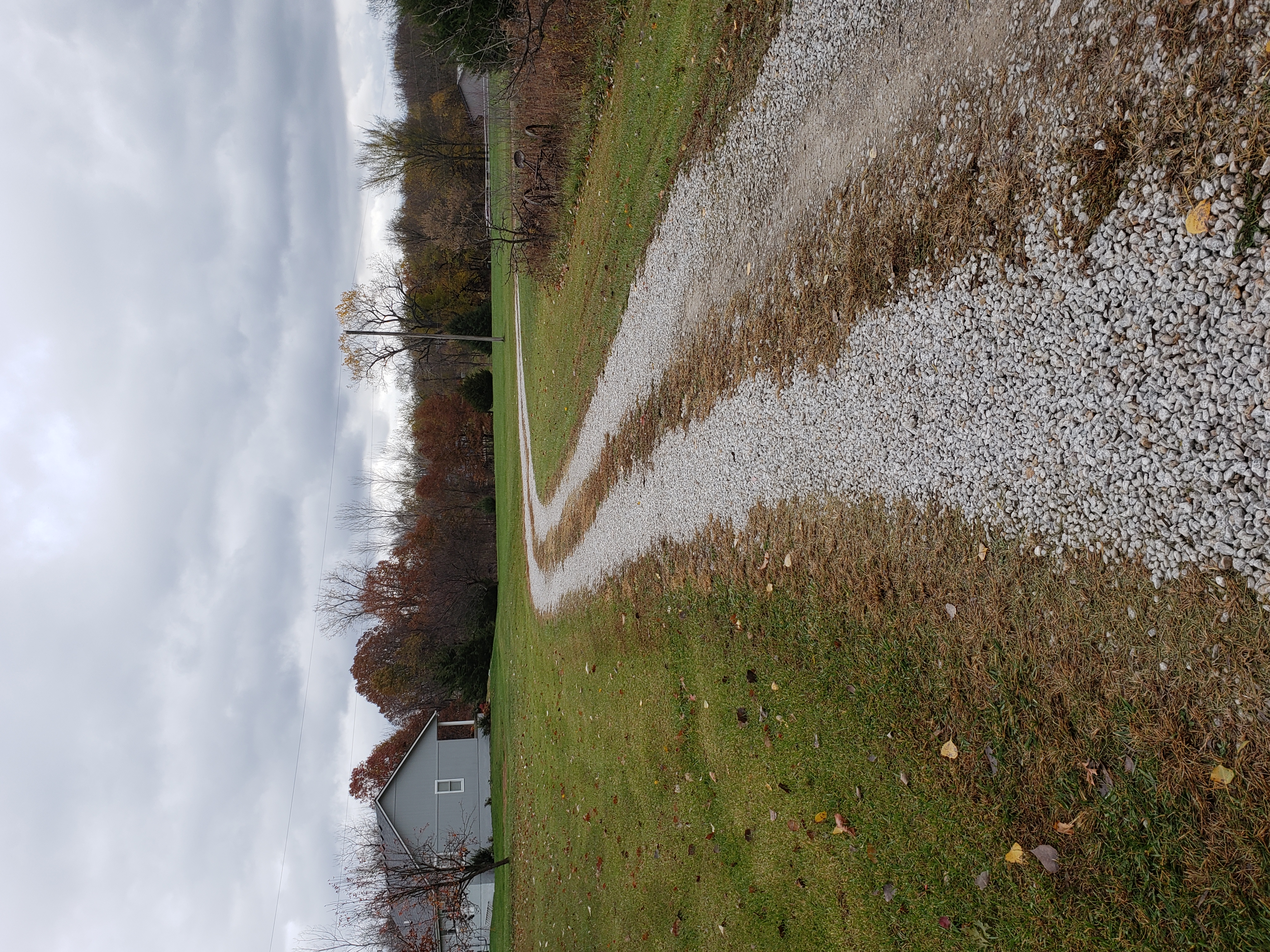

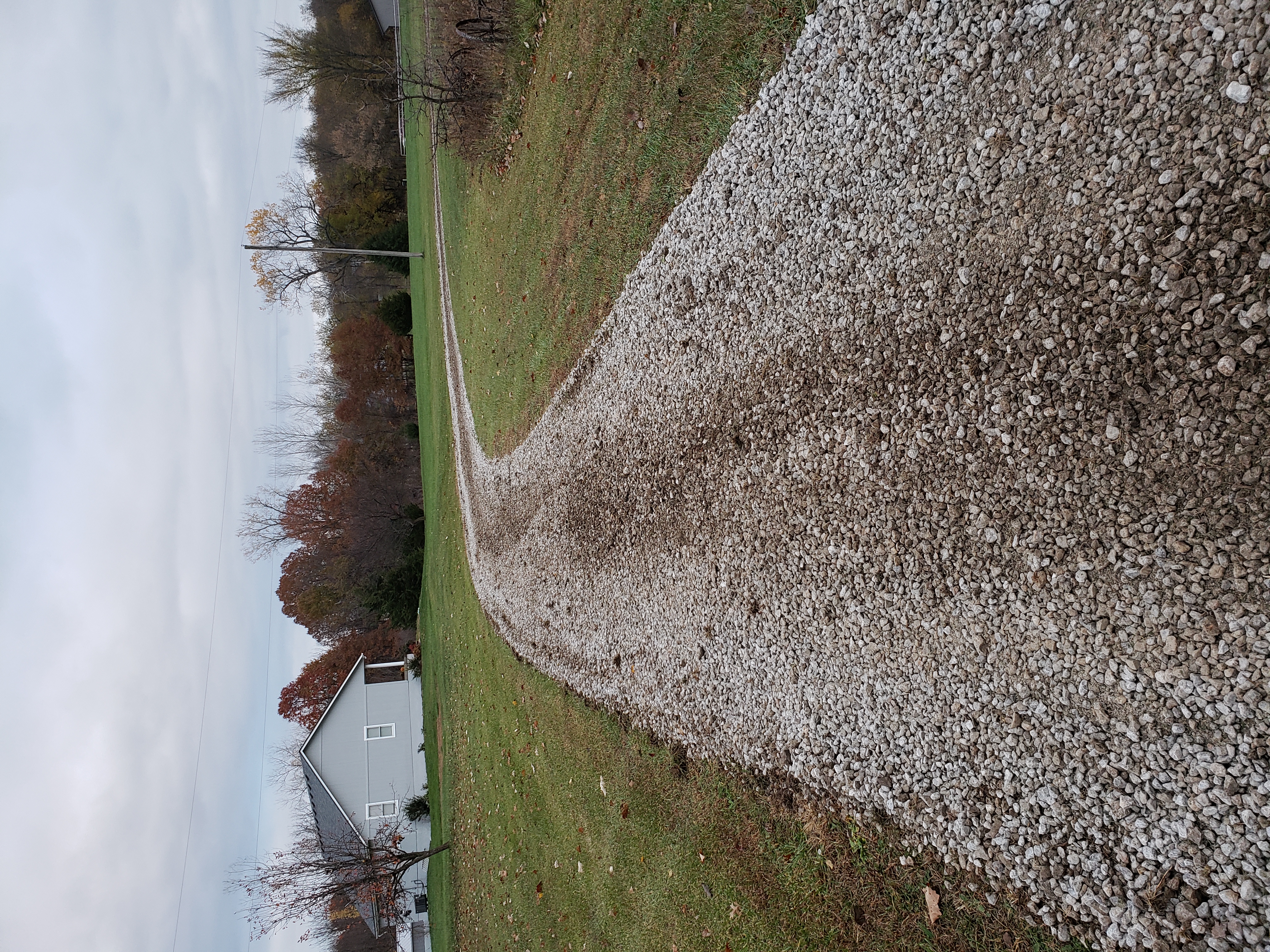

Thought I would post a before and after picture using the 48" box blade I picked up used. Makes you a little nervous as you are working it because it gets worse before it gets better.
Would have liked to keep going but I ran out of daylight then it snowed. The strangest part is it feels like you are just dragging gravel back and forth. In reality you are digging up the old gravel.

Looks good!
