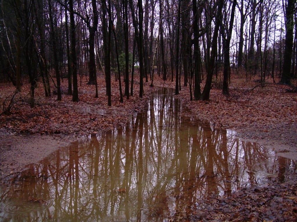

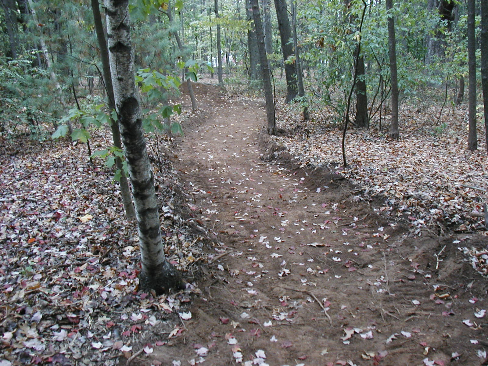

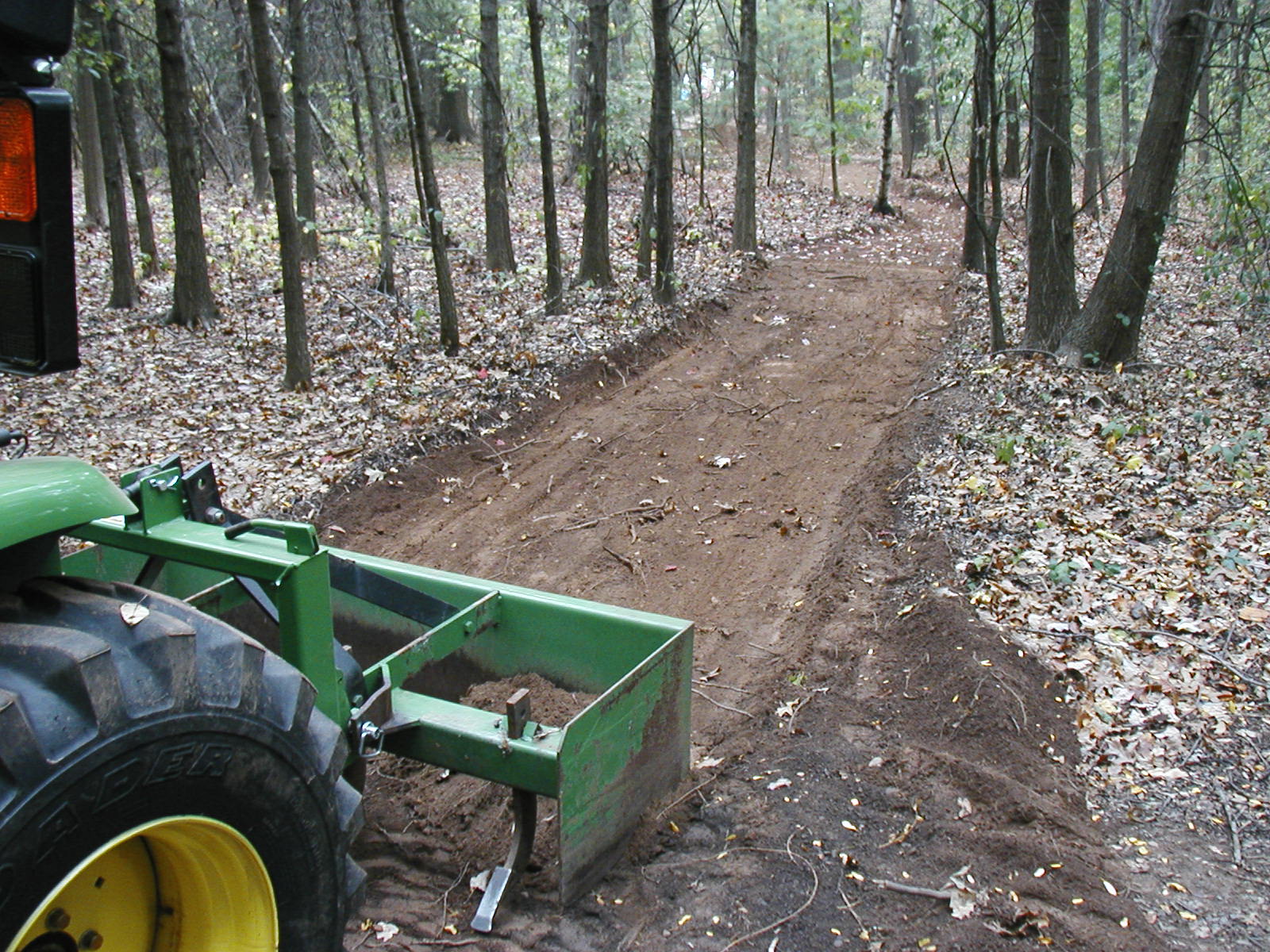

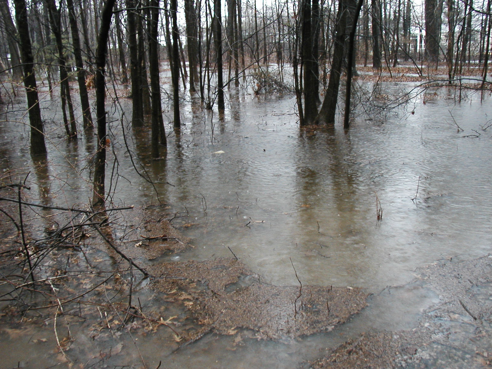

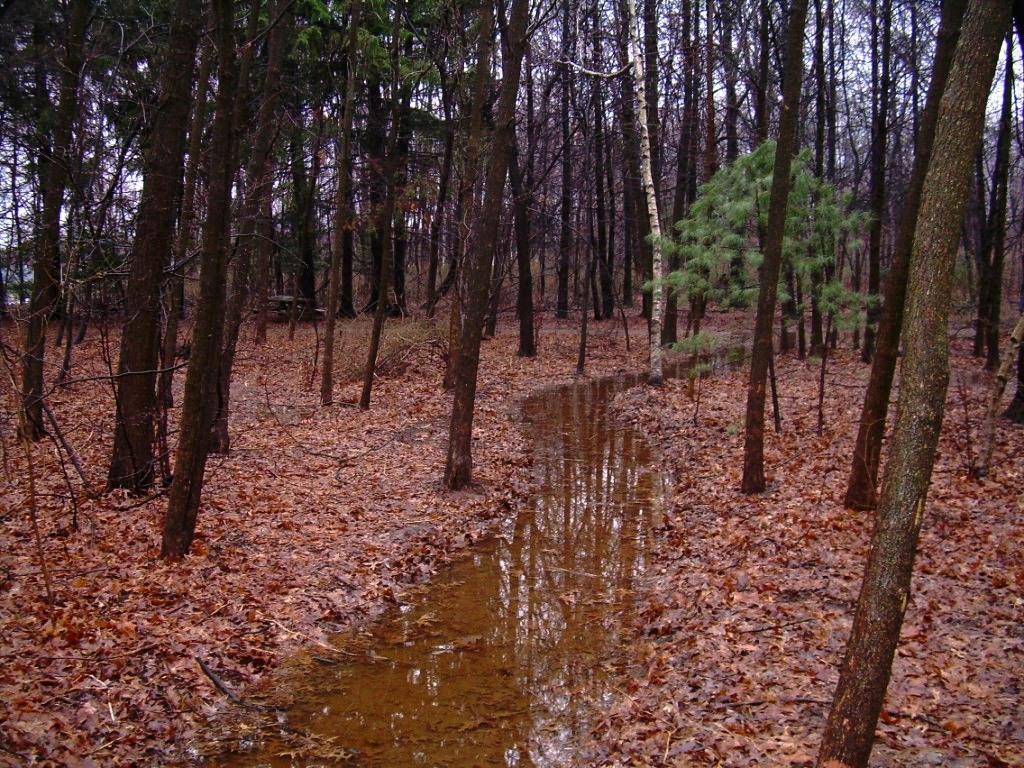

Coolslug,
I have a 5 ft BB for my 32 HP, I think a 7 footer might be to big, would the 6 footer cover your rear wheel width? if so that might be a better fit. I'm by no means an expert so others here may know better, or the dealer you bought the tractor from.
From the little experience I have with the box, I found that the longer the pass the better, when you first start to pull it it might try and dig in to much but once the box is partly full then it's smooth sailing as it kinda rides on the surface more, filling the low spots and scraping the high, leaving a very level path. of course once the box is full then your not cutting as much so if there is a real high spot then once the box is full just drag it off out of the way, unload it and go right back to that high spot till it's close to where you want it.
That filling and scraping makes it self leveling, I tried my 6 ft rear blade to do some grading and made such a mess, put the box back on and straightened it right out, just might have to make several passes over the same path.
A few pictures of a small project I did with the box. The flooded woods, the drain swale and the not so flooded woods.

JB, if I can make trails half as nice as you've done I will be one happy camper. Tomorrow morning I will measure my wheel width before heading out to buy a BB. Thanks!
