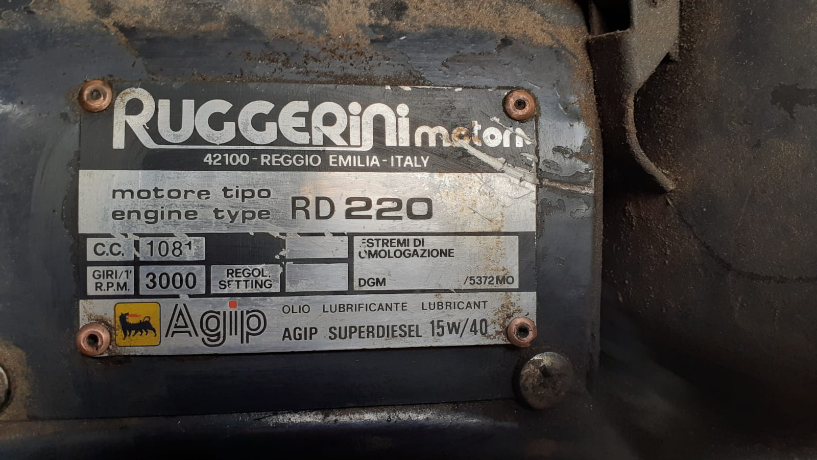

It's a Ruggerini RD220.
Couldn't find info on it but found a slightly smaller RD211 rated at 17Kw, so I suppose it's just short of 25hp.

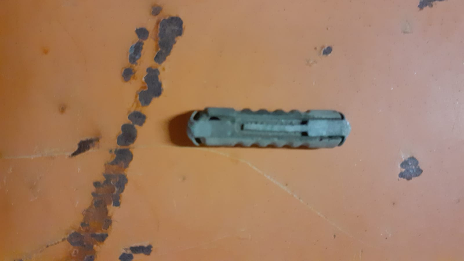

There were some bad contacts which I figured was just corroded connectors, turns out it was the fuses. Never seen ones like this. I lightly sanded the tops of them but some broke as they were very fragile. I did a garage fix but maybe the Carraro dealer will have some of these, if not I think the rounded household fuses might also work :unsure:

Looks like indeed a 22 hp tractor. Still a nice improvement I think, specially considering the extra weight this tractor has versus the Hinomoto.

The fuses are an older style. Still easy to find though. I bought an assortment of those on Roady a few years back when I had the Toselli tracked tractors. They used the same style and most classic cars also use these. I believe I've also saw these fuses on those Chinese stores and also on the Auto accessories section on the common Continente, Intermarché, etc stores.

I'll try that with the pto, it does make sense as the pin prevents you from accidentally selecting it, and thanks for the fuse tips.
