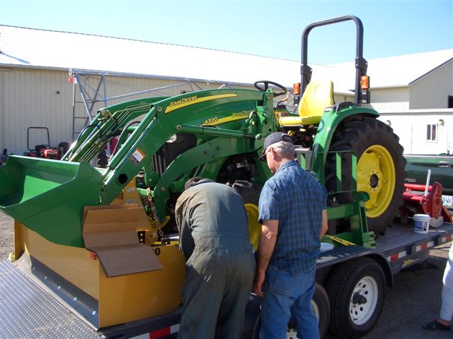

I would think so. Attached is a picture showing how I loaded a new JD 4320 with various attachments onto my 16' flatbed.

wow that looks pretty good and compact. I gotta get a trailer with more capacity (GWVR), so i can tow my tractor around, after I get something strong enough to tow it!:rolleyes: - Ever since I traded my 4100, I neglected to upgrade my trailer and well i am just lucky that my dealer is only 10 miles away and does not charge an arm and a leg to pick-up for service. But to help buddies out I would need to drive the tractor over to their location - not gonna happen!
