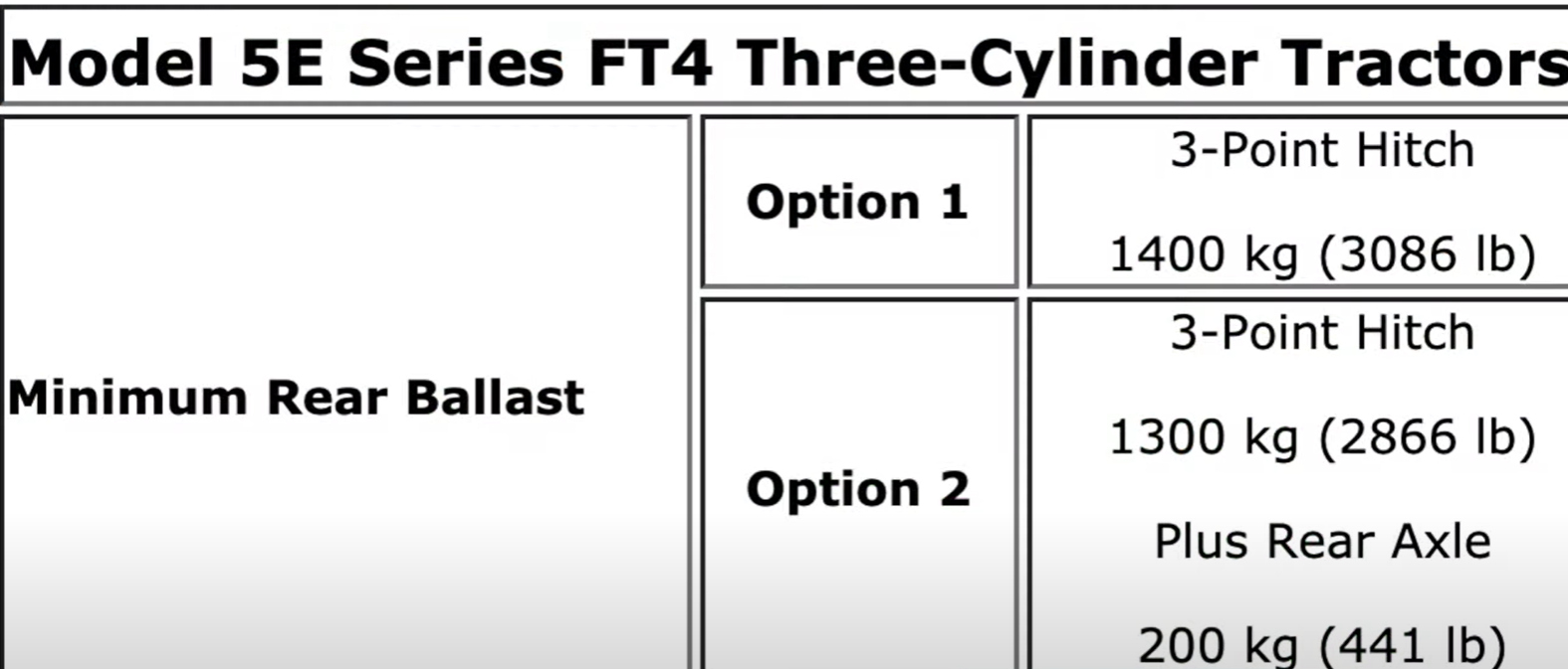

Above data makes no sense to me.
I think responders later tonight will concur the numbers above make no sense.
   / Is 5065E a good deal for me? #12
The source on the other was actually from your youtube suggestion, tractor time with tim video, his review stated requirements for that 520M loader. Granted it's not the same loader, but I'd expect somewhat similar. I've View attachment 698408
I watched the Tractor Tim review of the Deere 5075E, which I enjoyed.
HERE:
I note that Tim stated his personal recommendation as 2,000 pounds TPH counterbalance for the very powerful Loader in the video.
In addition to Rim Guard filled rear tires, which Tim said weigh 1,500 pounds combined, the cab on the 5075E weighs somewhere around 800 pounds, of which 600 pounds will weigh on the rear wheels; 2,100 pounds of additional weight on the rear wheels, relative to the bare tractor. In my opinion for the Deere 512 Loader 1,000 pounds of TPH counterbalance would be ample with a cab + Rim Guard in the rear tires. For the more powerful Deere 553 Loader 1,300 pounds of TPH counterbalance would be ample with a cab + Rim Guard in the rear tires.
