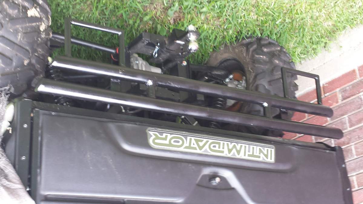

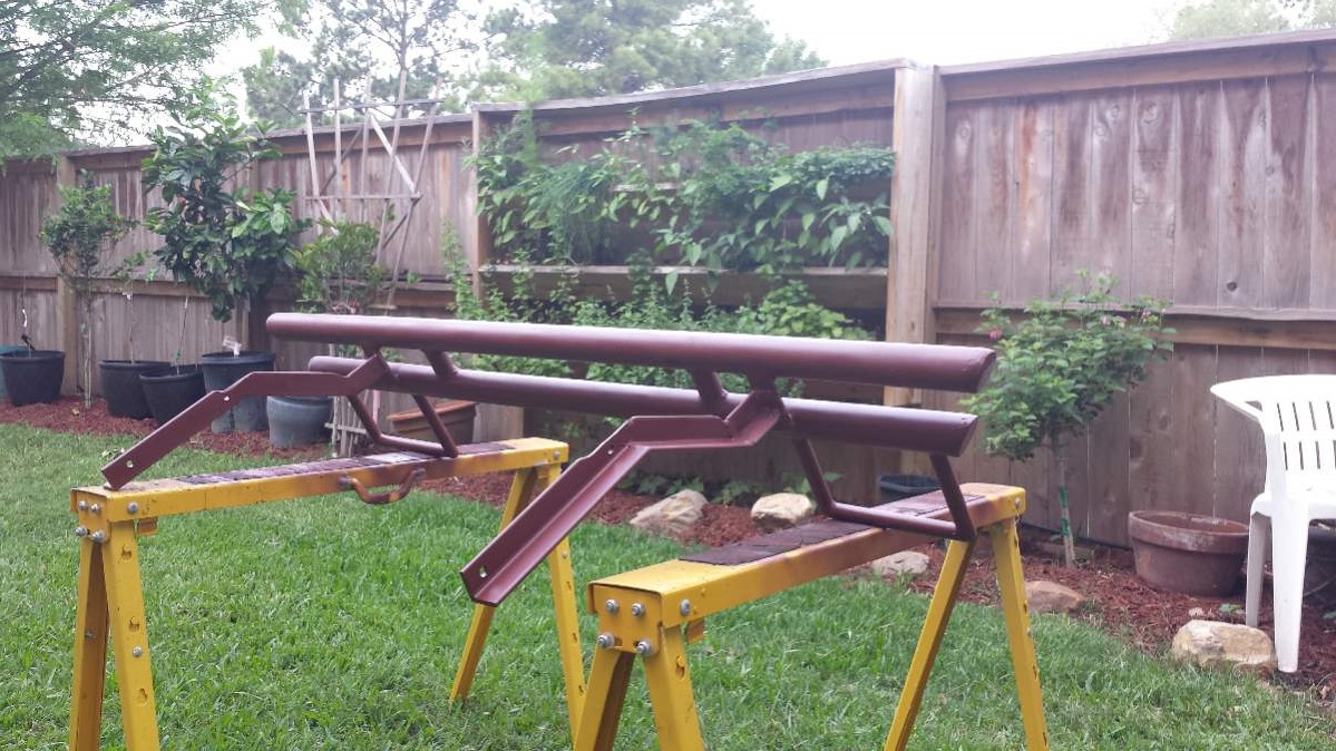

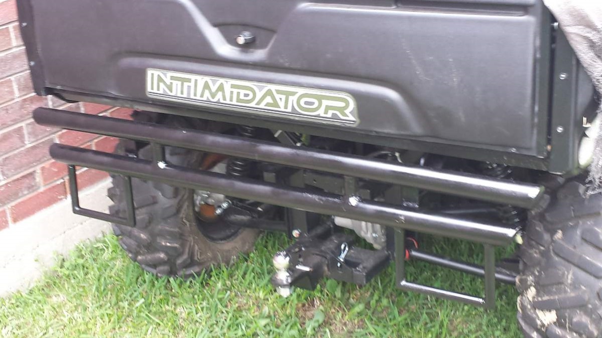

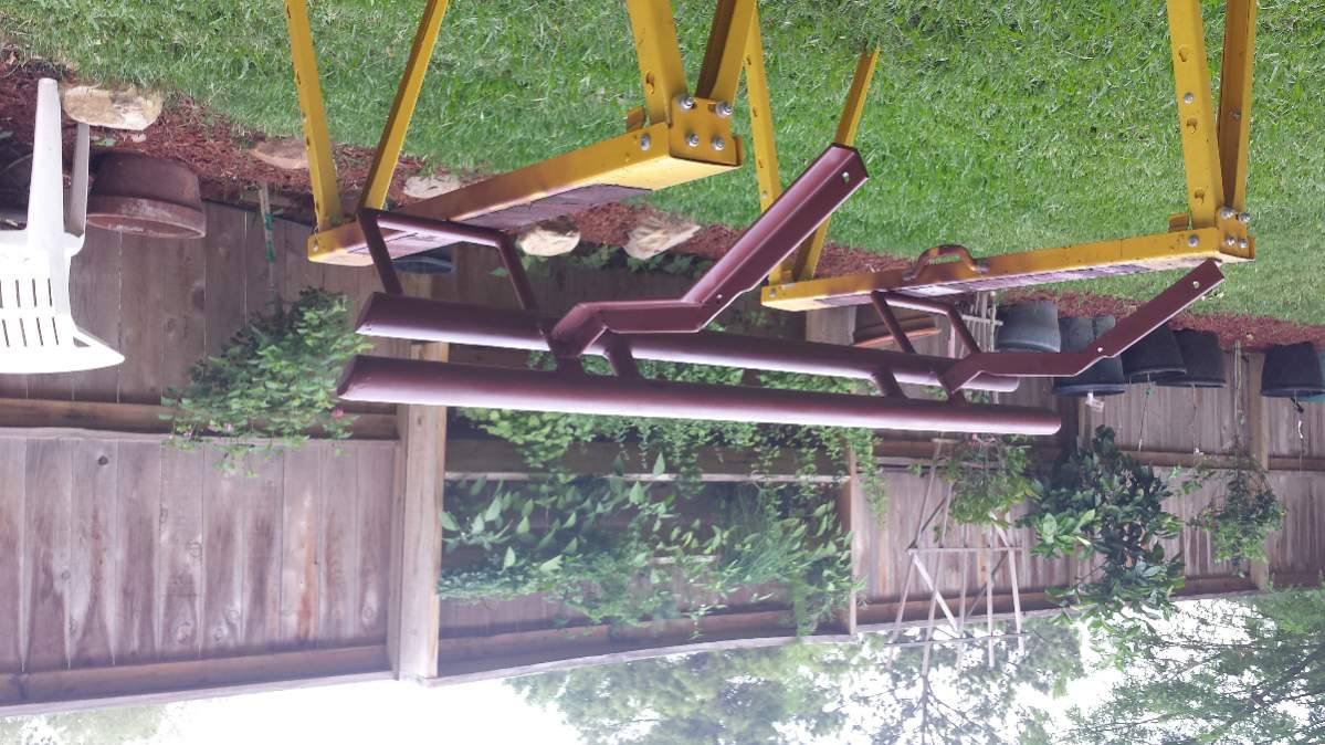

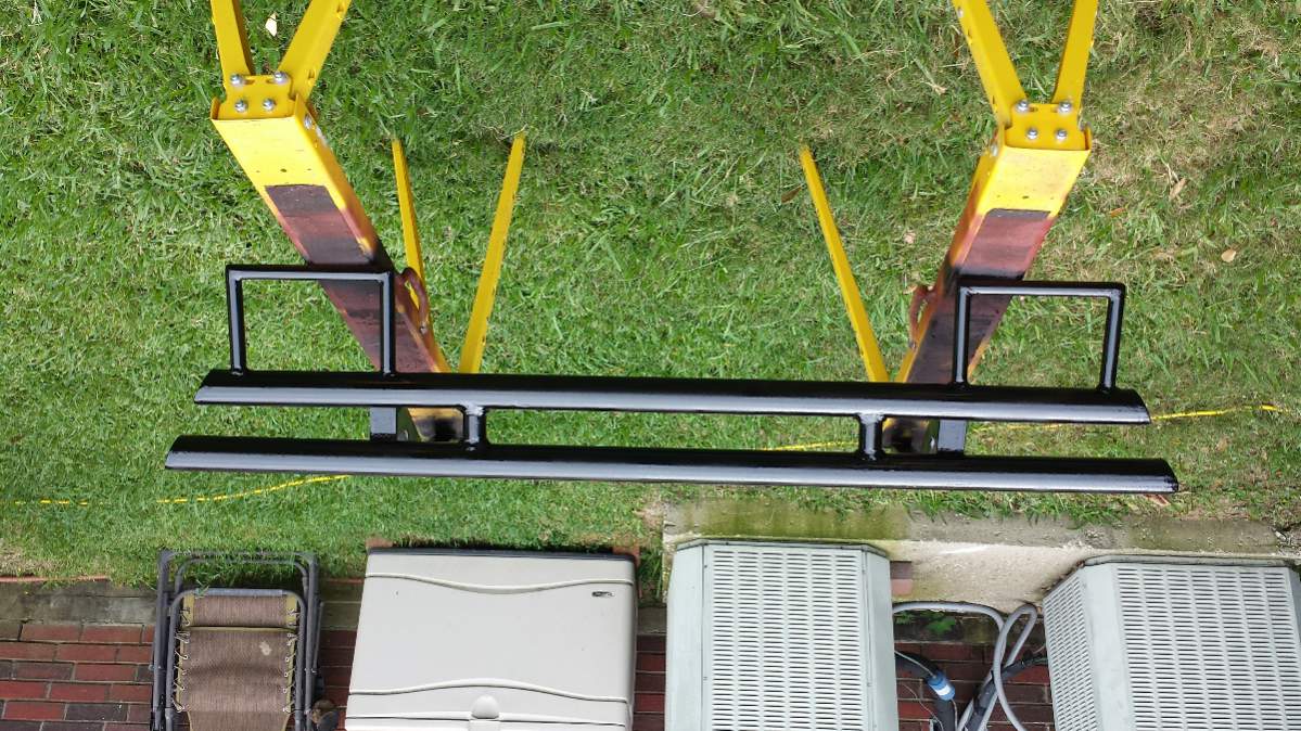

I finished building the rear bumper for my Intimidator this weekend. I'll attach some pic's. I'll start on the rubrails/fender guards in a couple of weeks.
   / Intimidator, 1000 cc Diesel
#35
Looks like I turned the world upside down. Ha. Sorry for the upside down pic's.

Thanks to Paint.net the world is rightside up! :D
Looks good! :thumbsup:
   / Intimidator, 1000 cc Diesel #38
Looks factory! Nice work
