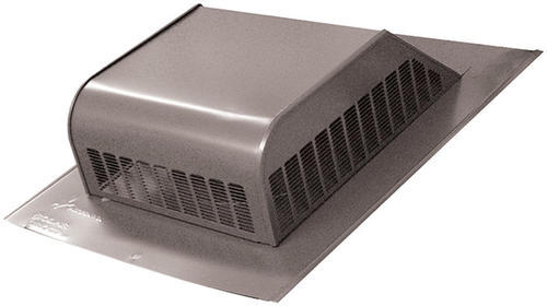

So I'm getting a new roof installed so I had to take my internet dish down. It's one of those line of site dishes that points straight west of my house. The old wiring was just laying across the roof, a CAT 5 and a # 12 ground wire. My question is this. I want to run the new wire through the attic and come up through the roof by the dish. Do you think I can run the wire out through one of the roof vents? Or what would be another solution?

1) It depends on the type of vent you use, but most likely that would work OK. I would suggest that you get a watertight strain relief cable connector and mount it on the side of the roof vent for the cable to exit. If the cable already has the the RJ45 connector on it you can use a 1/2" conduit size connector and split the rubber bushing to get it over the cable.
2) You can buy "direct burial" CAT5 cable that should hold up better to weather. It has a silicone gel inside the jacket to keep water out.

I already have some outdoor rated CAT 5 and I will put the ends on myself. The hole size will be minimal, just enough for the CAT 5 and ground wire to pass through. I think I can just snip one of the vent fins and that will give me enough room. The vent is like this.

I think that would be fine. Just be sure to put a drip loop in the wire. Water has a hard time running uphill. But if the wire comes in high and goes lower... look out, it will channel water into the house. If in doubt, take a hose up there with you and start spraying water on it.

since you are redoing the roof, put in a 2" PVC pipe like you would see for a plumbing vent, with a boot to seal it at the roof. put a couple of elbows on the top to keep the rain out. after you get your wire through, foam the inside of the pipe to keep bugs and critters out.
