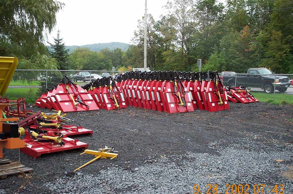

<A target="_blank" HREF=http://www.tractorbynet.com/forumfiles/5-229651-InternationalRotaryCutters-800.jpg>They appear to be similar to KingKutter style</A>, but what I like better is the thick stump jumpers they use… ½” – ¾” pan cut steel versus 3/16” on most standard pans… This mass will allow a smaller PTO hp tractor to sustain cutting in tougher woody material or higher grass… in turn helping to get the max torque out of your tractor… /w3tcompact/icons/smile.gif
One of the weak areas as with all the cheaper rotary cutters is the A-frame assembly… not solid enough for everyday rough cutting duties… tends to twist and bend as time goes on… /w3tcompact/icons/frown.gif
