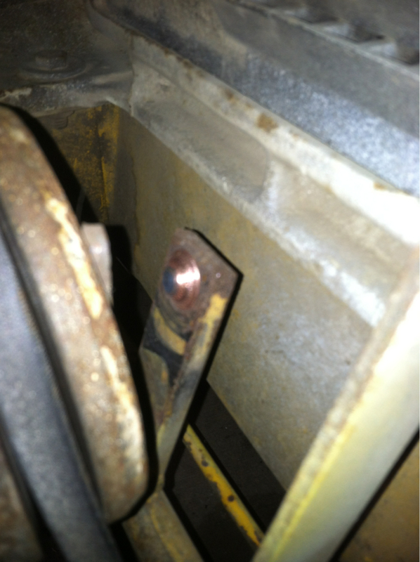

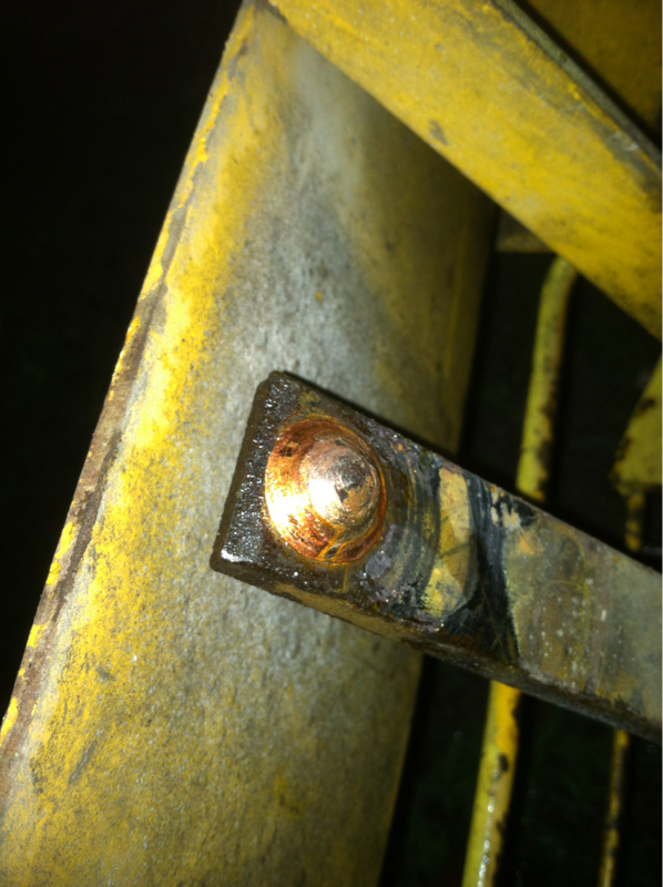

   / International harvester 129 help
Just now got around to getting those pictures...do these look normal to you? Thanks for the help man!

   / International harvester 129 help #5
First off what I can see in the pic is the upper "finger" on the clutch is out of position. and there is a"button" that those fingers are supposed to hold in that is gone

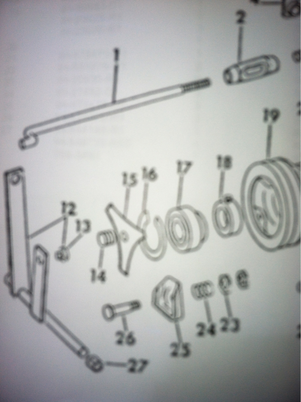

Do u mean 14 and 15?

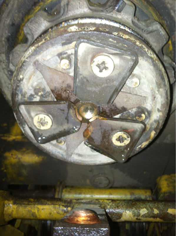

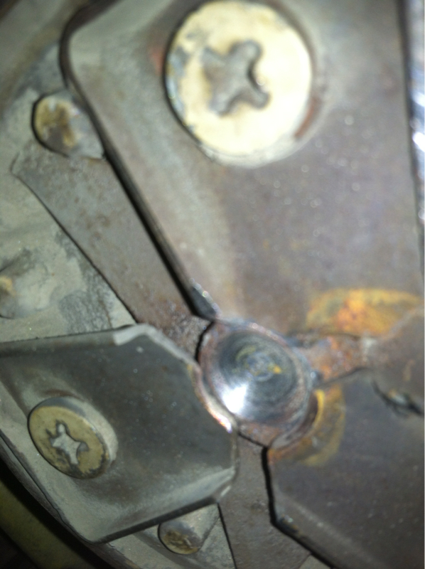

I tried taking some better pics after removing the hood and grill...still look the same to you? And if so do you know how to fix er?
#9
I see where that one part is twisted
Sent from my iPhone using TractorByNet
   / International harvester 129 help #10
the triangular piece is also messed up, a piece is broken off on the RH side in your last picture.
based on what I see, parts 13-15 are either worn or broken.
I can't tell any more without disassembly.
