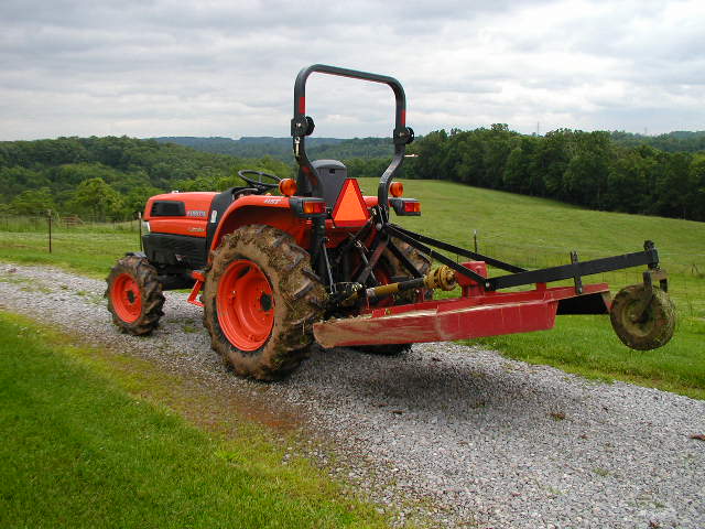

I have an International 5' that I pull with my Kubota L3130HST. She is only rated at 24 PTO HP and I have no problem with engine power, even in hood tall grass. The International I bought only set me back 475 and that was with a slip disc clutch. My Kubota dealer handled them and gave me a good deal when I got my tractor. The cutter does a great job on weeds and grass and does not flinch when I back it into the thick brush. For the price I have not seen anything as heavy and built for abuse. Both my neigbors have them and the one really uses it to clear heavy brush and it now has seen 7 years of heavy use with no problems. The only complaint I have is the paint and cosmetics of the cutter are not good but after all it is a piece of machinery built to do a job not look pretty. Thought I would attach a pic of my set up. Happy mowing! /forums/images/graemlins/laugh.gif

Tractor and cutter look good, but man what a view. Very nice! /forums/images/graemlins/cool.gif
