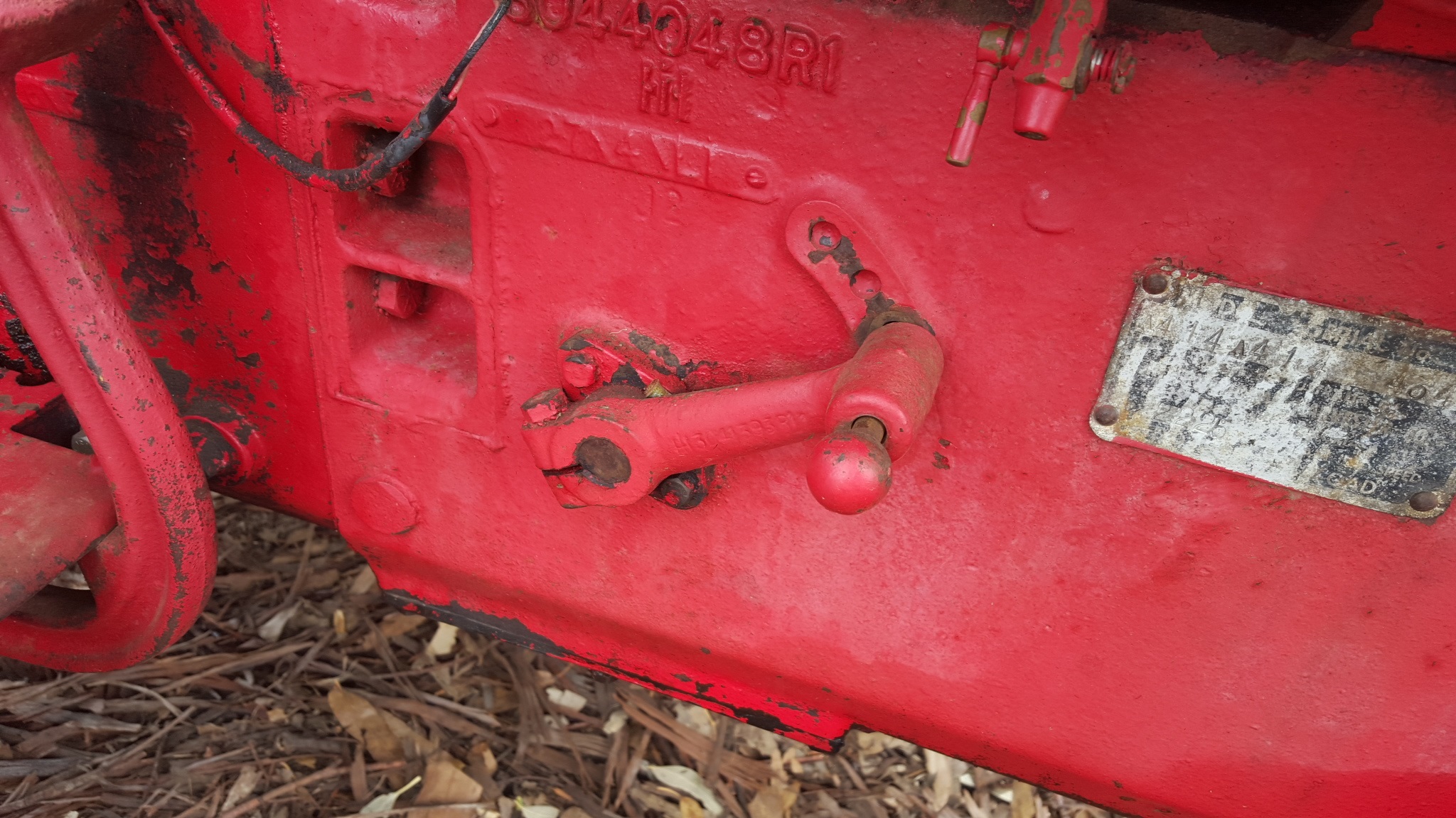

Hi all,
What is this lever for ?

Ahhh....thanks for that,,,
I was thinking the 414 was 1 speed only on PTO, and that makes sense as the middle position has no wear, I wonder why there would be a nuetral if you have a lever to dis engage the PTO anyway + clutch, maybe it is just the way it is done due to practicality.

This from the manual for my IH 354. I expect it is the same for your tractor.PTO Lever16032018_0000.jpg
