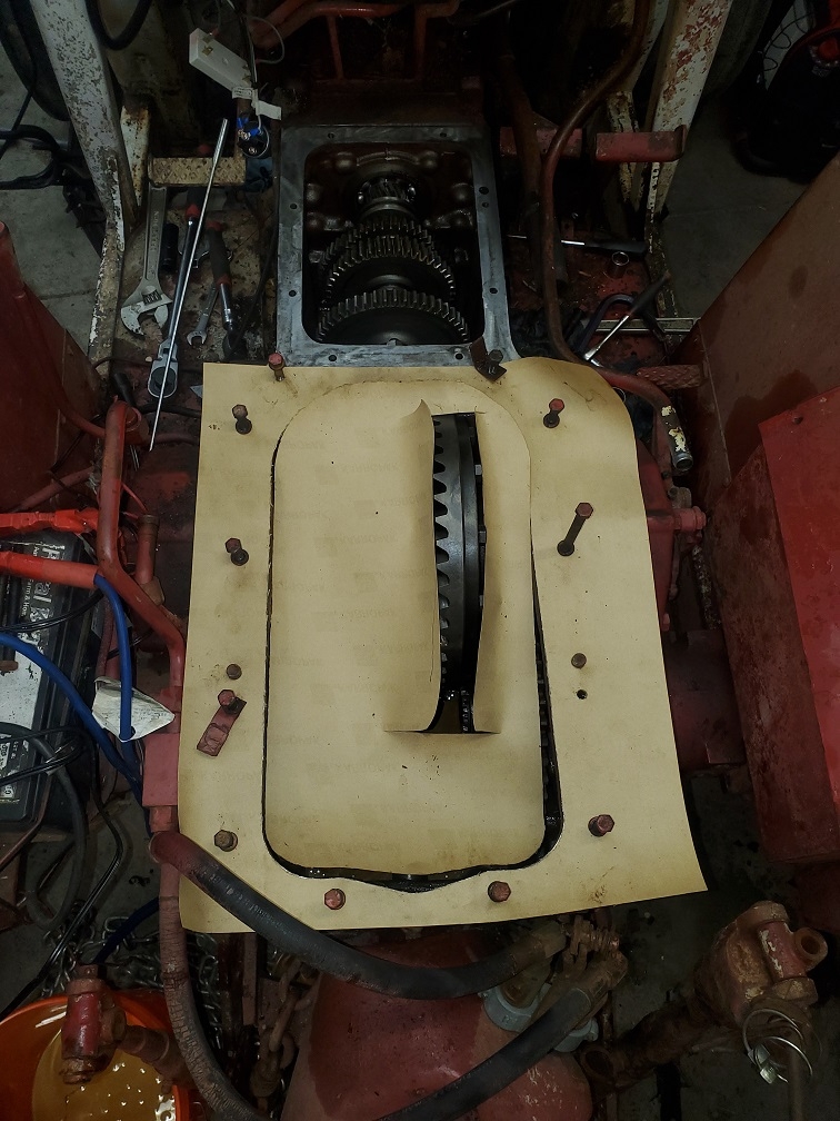

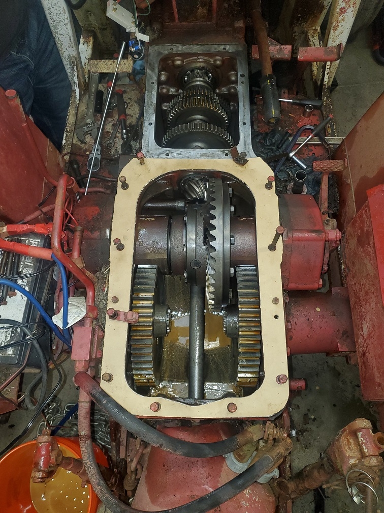

Well the gasket making process took a bit to figure out. We started on the larger rear end housing and had to re-do it. The ring gear sticking up screwed up the stretching over of the gasket material. We tried to walk it around and fold the gasket material back over the ring gear once we got the inside cut a bit. Somehow we still ended up with about 1/2" extra on the other side that wouldn't sit right.
We re-made the gasket a 2nd time with a slice in the middle to let the ring gear through. That way we could lay the exterior flat on the housing from the start.

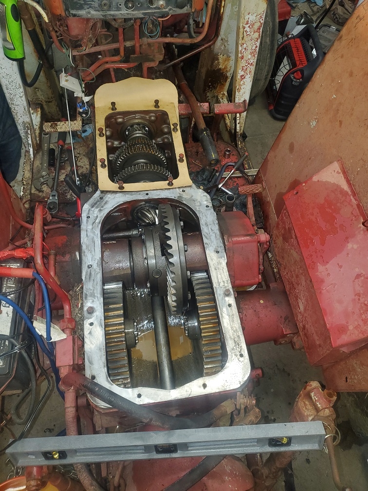

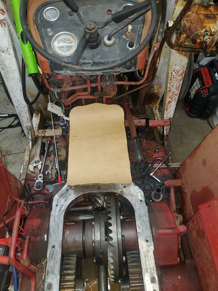

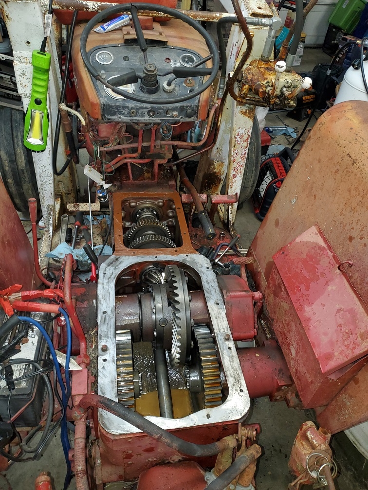

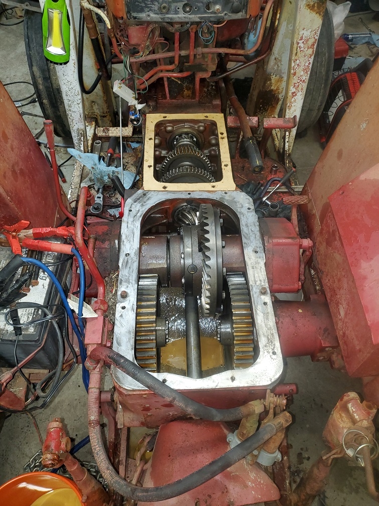

Here are some pictures of what we did do so far.
This is a contrast between the non-prepped transmission housing and the prepped rear end housing. I used a polycarbonate disk from Harbor Freight. I've used these disks for surface prep prior to painting before and have had good results. It appears to have worked here, also.
I used emery cloth around the pins and other places where I couldn't get the grinder/disk.
This is the start of the rear end housing gasket. This is the 2nd round. The 1st round did not have the slice in it for the ring gear. I used the center cut out of that 1st attempt as the material for the transmission housing.
This is the transmission housing end of things.
As mentioned in the previous post, I am having trouble with getting the forks lined up. This gasket needs to be re-made and the surfaces prepped again at this point. But the pictures do a good job describing the process.

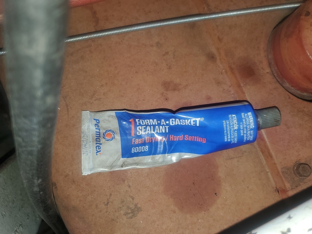

This is the gasket sealant I am using. Hopefully it does the job and lasts.

Your gaskets look great..!! I use several different Permatex brush on sealers, I've had good luck with taking parts back apart if needed without harming the gasket if I'm careful.
If it were me, I'd probably do a dry assembly first before putting the sealer and gasket on and make sure the shifters do what they are supposed to do. With the main transmission shifter and range selector in neutral, you could crib the gear shift mechanism up on 2 X 2 wood blocks. Might give you enough room to look through from the side with a good bright light and get the gears aligned to match the forks with a long screwdriver or something similar.
Most I've dealt with the top has to drop straight down. Having a helper makes it a lot easier to pull the cribbing then drop it down. I'd put the 4 end bolts in and snug with a wrench just beyond finger tight to make sure the shifter mechanism doesn't move, then see if everything shifts as it should. If it does, pull it off, prep the surfaces and go through the process again.
If memory serves me correctly seems I remember you having the shift assembly apart. Just be sure the shift rails, forks and detents are in the correct positions. Looking at the first picture, although it appears to be in first or third gear's the shifting forks side by side sort of throws me, but could be the way it is. Just so happened to do a Google image search and found a shift tower for a 444 on ebay. Even through it appears to be in neutral, the forks are staggered. Just doesn't seem possible for them to end up, side by side like it appears yours is. Maybe it's just the angle of the picture.
   / International 444, 1968. Progress Thread, Getting Going
#159
Thanks - and not the complement on the work, rather for the new skill. That is a big part of working on my own stuff for me - learning and growing. I've never made gaskets like this before and for all the projects I've done over the years - and will continue to do - it has already been a worthy skill to have picked up along the way here. So thank you!
I agree on the dry fit. The cribbing idea sounds like a great idea. I will have to give that a shot. I have a few options for things to use to knock the gears around if I have a decent gap in the housings to get through.
I was just trying to hold the gear shifter and drop the assembly as straight down as I could by hand. For as heavy as it is, that isn't an easy task (my back really hurts from all that yesterday). The cribbing idea will make that a lot easier for positioning. I'm thinking rigging a hoist to help support the weight also.
I did have the whole shifter apart - I had to in order to get it cleaned (what was the shift problem originally - gunked up and rusted). I did take care to assemble it the way I took it apart, after cleaning of course.
