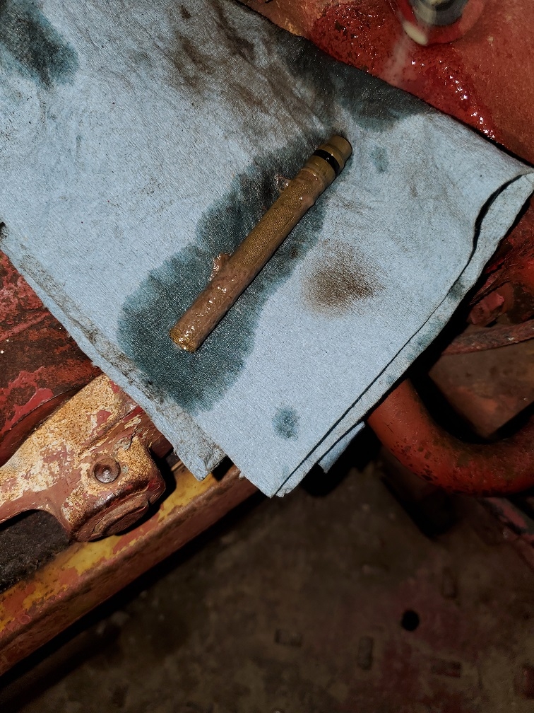

As to the suction filter - the diagram I have in the ops manual isn't very clear on the exact locations of what filters.
That said, I pulled one of them that looked to be about 2 to 2-1/2" long and about 5/16" diameter and cleaned it off a bit. It just had some goo on it, no debris. I can't tell you if it was specifically the suction filter or not.
That one is in the valve assembly.
The suction screen is the larger hose coming straight out of the bottom of the tank which is what your seat is mounted to. There is a bolt with a metal tab that holds the suction screen in place.
Remove the bolt and tab and then disconnect the hose/hose clamps and slide the short piece of hose forward and then suction screen pulls out.
You lose most of your hydraulic oil when you pull it out so be prepared. I have parked my 424 with the front axle up hill so I didn’t lose so much oil when cleaning the suction filter.
There’s a drain on the back below the fill port. I put a 45 degree street elbow in it to make future drains less messy.
Based on your descriptions I think I have a solid idea what you are referring to. I am fighting with the rubber hoses on that pipe.
Part of the work I am doing (that I held off on until I got the tractor down like this) is to open up the transmission and see about loosening the gear shift shuttles. In order to get in there that hydraulic line has to come out.
