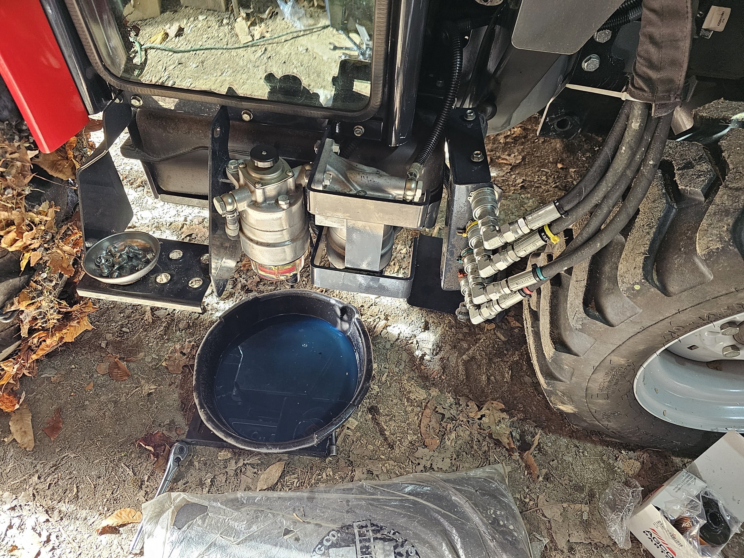

Hi All,
I have been happy with my 2016 MF1754 so far. I had a 1000 hr service done roughly 60 hours ago (6 months ago). Everything was fine, but now when I drive through a bumpy part of my property I see some blue/white exhaust coming out of the exhaust intermittently. Like it starts goes away for a bit comes back. It only happens after running the tractor for a bit. It starts up no problem. The temperatures have dropped since the last time I used the tractor, but I doubt it is just water vapor. I can’t smell anything off though besides the smell of maybe burning diesel. Anybody have a good idea how to diagnose this without going to the dealer?
Thanks!

did check the fuel filter… is there water separator somewhere or just the filter?

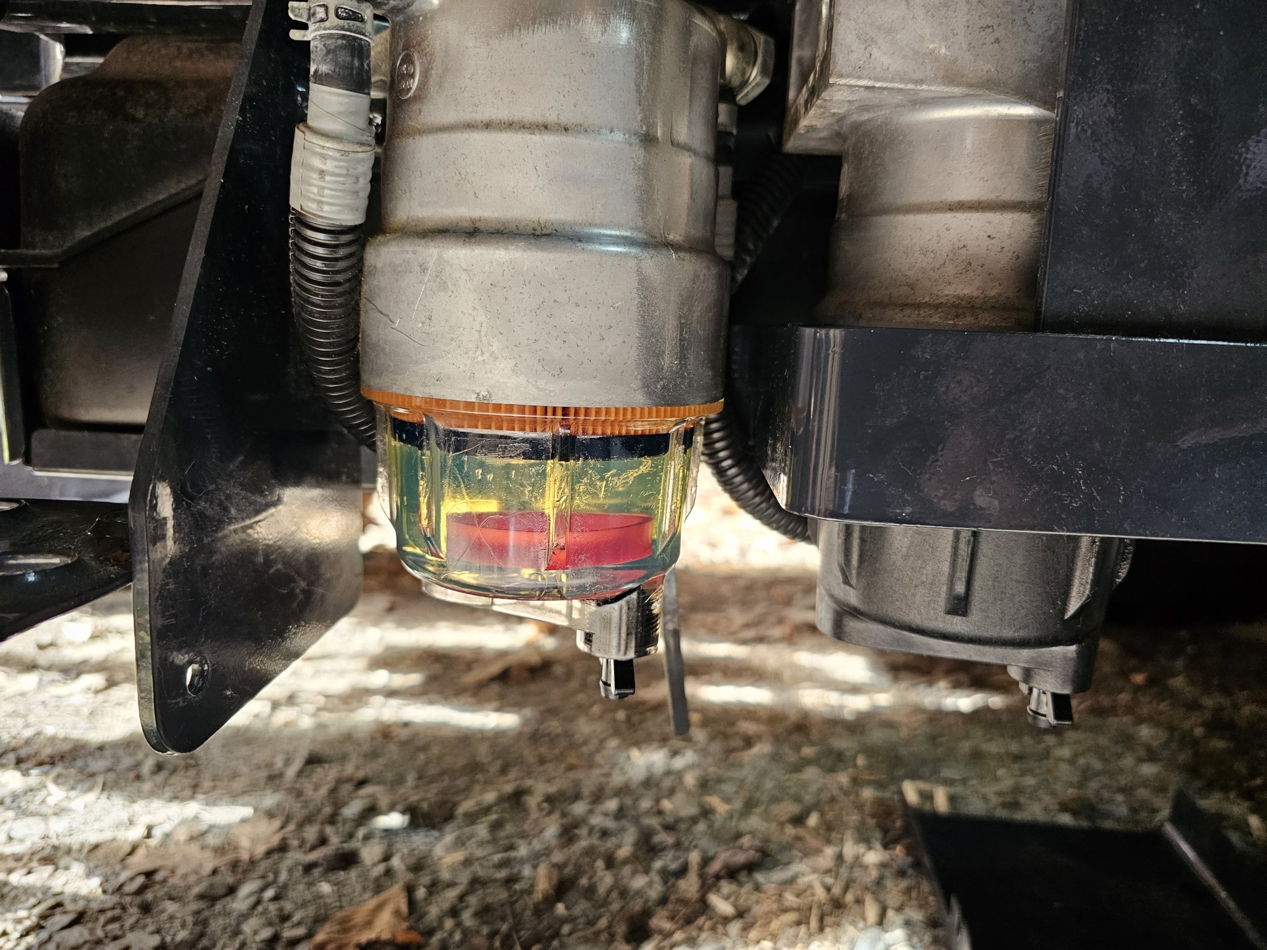

On my 1736 there is a separator with a red ring that will float on top of the water then the fuel filter, both have filters in them and drain valves in the bottom of their housings. There is a metal shroud around them that is not shown in these pictures.

Thank you! I know there is a little window on the metal shroud around the filter. I will need to check if the red ring is visible.

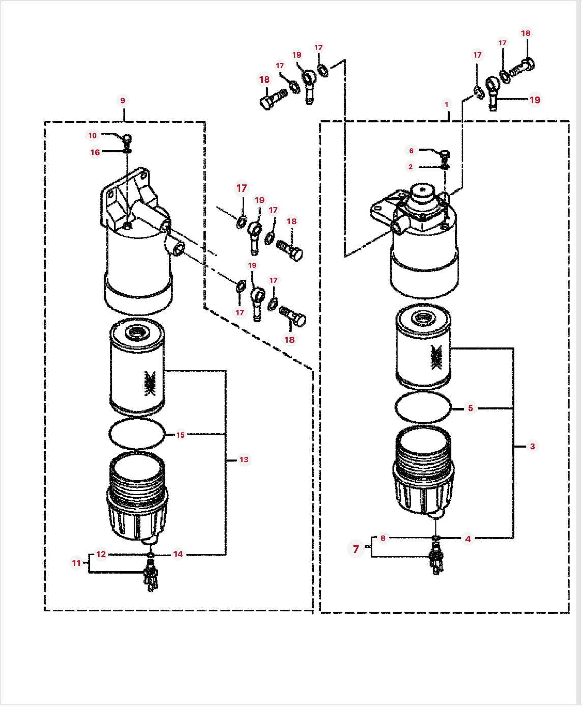

Well I just checked and I don't have that red band at all... I checked the parts book and they don't list it either...
   / Intermittent blue/whiteish exhaust from MF1754 #8

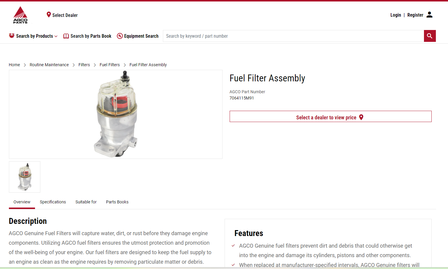

Interesting, searching online for my 1736 and your 1754 I find the following page which shows a picture of the assembly with the red ring, the picture is upside down for how the part is mounted on the tractor:

Yeah I saw that too. But there is no part in the parts diagram. I am guessing it is part of the assembly and you can't buy it separately.
   / Intermittent blue/whiteish exhaust from MF1754 #10
Yes, However I think your dealer may be able to drill down further on their system and find that part.
I changed my filters one time and I had put everything back together and purged the air from the system only to find the red ring when I was picking up my tools so I got to practice putting it back into its housing. I wonder if that happened to yours?
