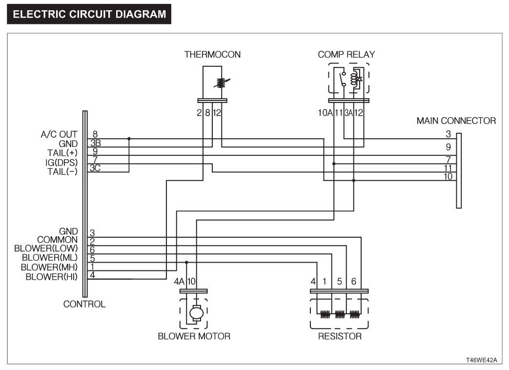

when it fails, check if there is 12v to the clutch, if not it may be a low pressure sensor interrupting it. you would need a wiring diagram though to see if its computer controlled or simply wired in series with the ac clutch relay
   / Intermittent air conditioning failure
These suggest it's quite straightforward (ie - no computer control):

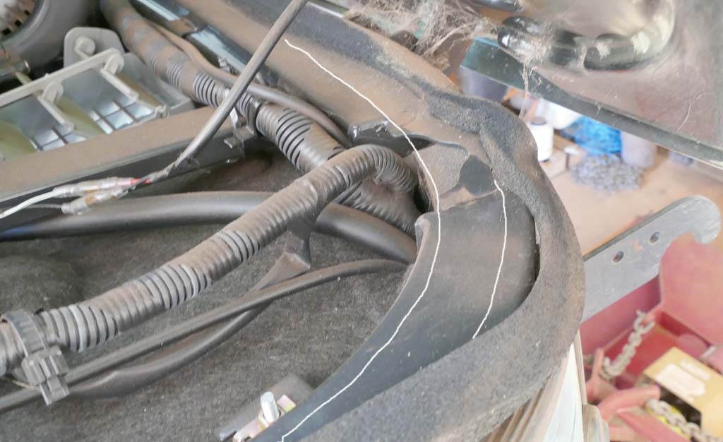

UPDATE: When I first "lifted the lid" of the cabin to reveal the wiring plugs & sockets, relay, aircon ducting, blower, etc, there was much more dust on everything than I expected. Strange, because I've had the four air filters replaced regularly. Then I noticed the foam sealing strip which runs around the perimeter of the cabin frame had never been installed properly. My white lines show where the strip should be:

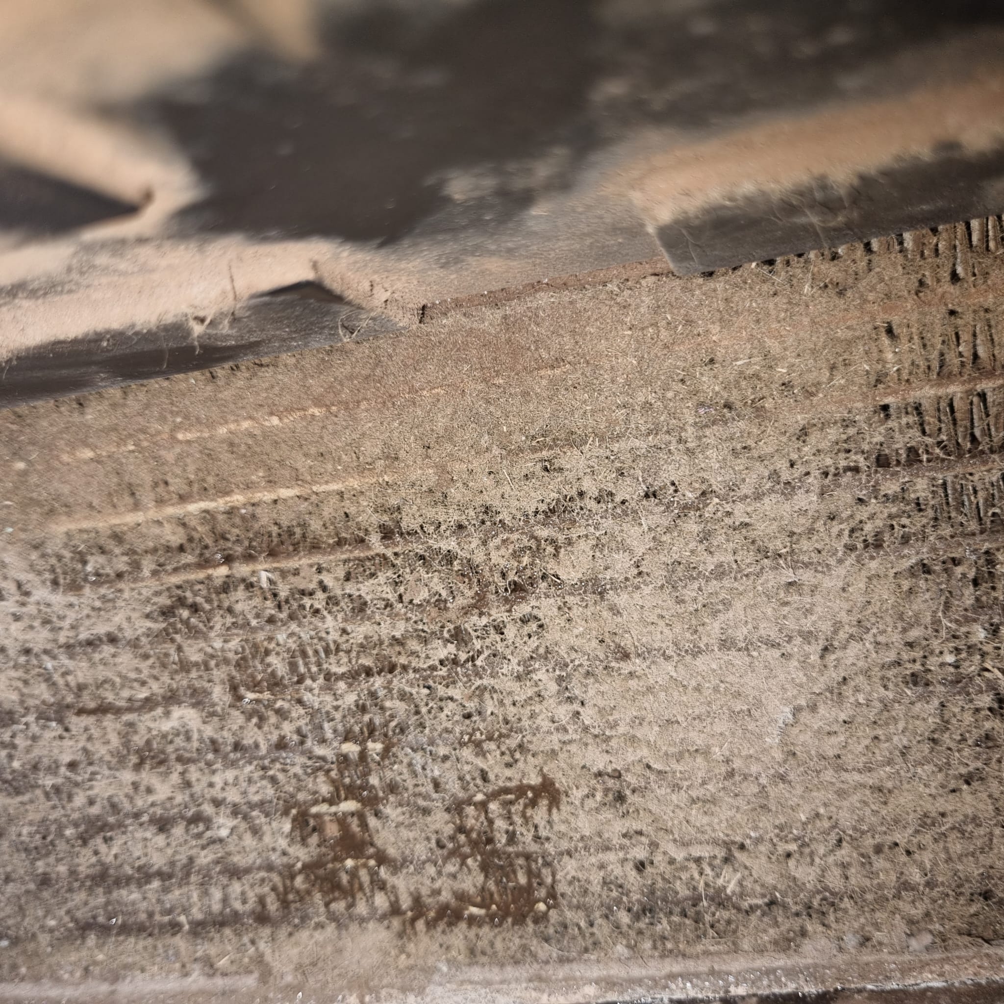

Then yesterday when my experienced aircon & auto electrician mate was here, after checking for the correct pressures, we popped the lid again. He saw the leaking seal and all the dust and asked if I'd looked inside the ducting at all. I hadn't - with all the linkages and mechanical cables to operate various flaps and diverters, etc, it looked to be a job for someone above my pay grade;). Like him!
So he removed the fan blower assembly in front of the evaporator, which revealed the problem:
Some time later, after gently flushing it all off with water, and replacing the main relay which he suspected might have had bad contacts (it did, which a destructive tear-down revealed), he reassembled it all, and it works beautifully again.
