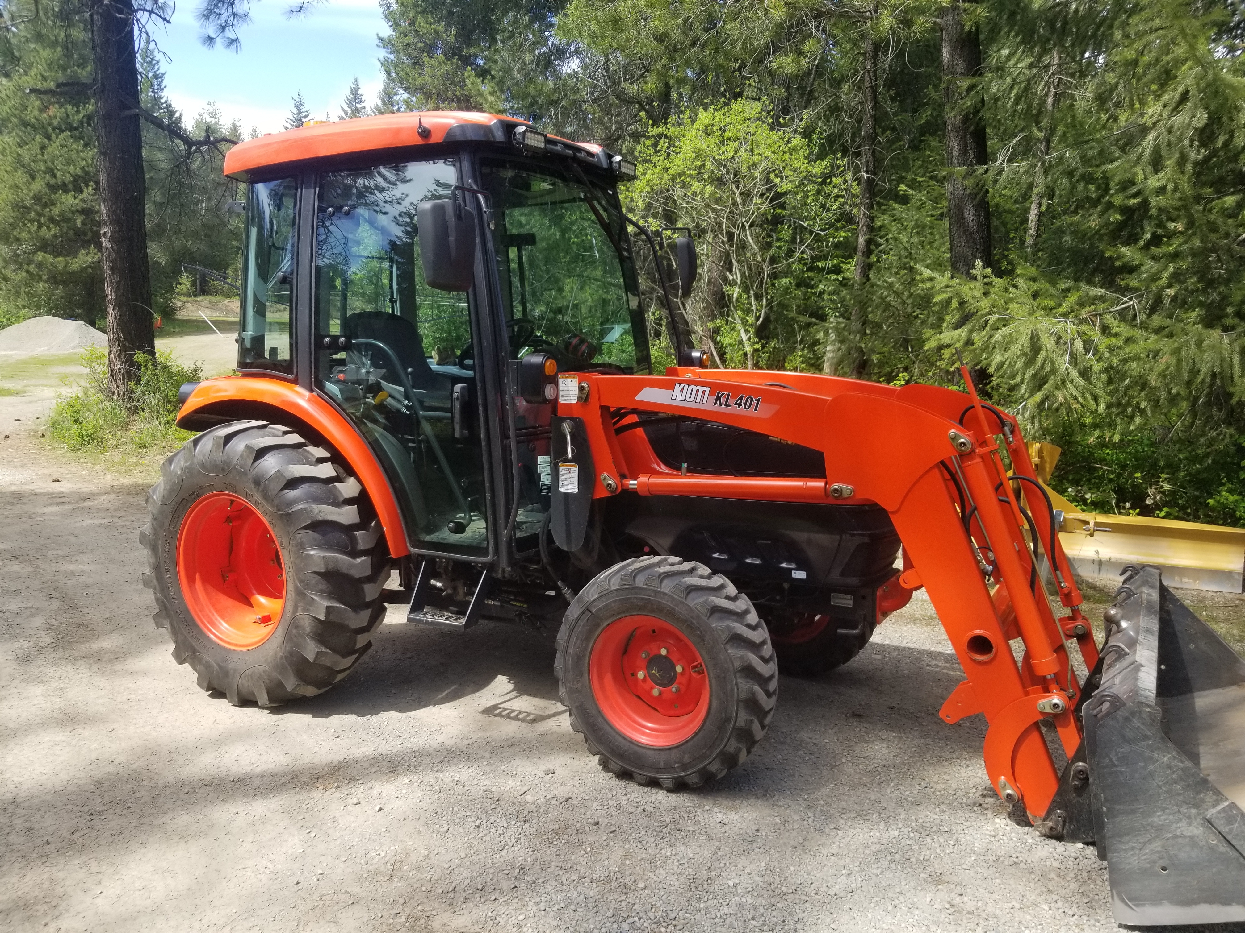

A strange air-con problem has recently surfaced in my 5yo Kioti RX8030. Starting a couple months ago, every few weeks, it just won't pump out cold air one day, then either later in the day when the engine's restarted, or the next day, it'll be normal.
When it first happened, I thought "Uh-oh, Maybe I should be more diligent in blowing out the radiator, oil cooler, condenser, and any other things bolted on in front of the fan". Then when it started working again, I thought I'd nailed the problem.
Since then, I've been regularly firing up the air compressor and blowing all the dust and crap out (from the fan side first, to blow the rubbish out the same way it came in), but then it happened again. The magnetic clutch had not pulled in, so that was my first suspect. However 12volts directly to the coil pulled it in, so I'm now left with the likely culprit being either a faulty/failing sensor, or wiring/electrical connection which is preventing the system from working.
When the air-con is working, it's brilliant, so I'm guessing it's not the refrigerant level being low. But as you'd know if you operate a cabin tractor in summer conditions, without air-con, forget it. Park the machine and go get a beer! My next step is to pop the lid of the cabin and do a visual inspection. Bit of a pain to remove light bars and Trimble wiring, but at least the rear of the lid is hinged, so should just be a one man job.
Any ideas?

UPDATE: When I first "lifted the lid" of the cabin to reveal the wiring plugs & sockets, relay, aircon ducting, blower, etc, there was much more dust on everything than I expected. Strange, because I've had the four air filters replaced regularly. Then I noticed the foam sealing strip which runs around the perimeter of the cabin frame had never been installed properly. My white lines show where the strip should be:
Then yesterday when my experienced aircon & auto electrician mate was here, after checking for the correct pressures, we popped the lid again. He saw the leaking seal and all the dust and asked if I'd looked inside the ducting at all. I hadn't - with all the linkages and mechanical cables to operate various flaps and diverters, etc, it looked to be a job for someone above my pay grade;). Like him!
So he removed the fan blower assembly in front of the evaporator, which revealed the problem:
Some time later, after gently flushing it all off with water, and replacing the main relay which he suspected might have had bad contacts (it did, which a destructive tear-down revealed), he reassembled it all, and it works beautifully again.
So a very happy camper here, and I'm so relieved that he found the problem. It's a wonder it worked at all!
