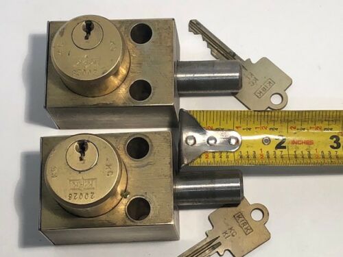

Look at a trapped key interlock. Something like this: KIRK KEY INTERLOCK QTY 2 (228) "NEW" | eBay
587926d1547998215-interlock-vs-throwing-main-circuit-s-l500-jpg
One goes on the main breaker, the other goes on your generator breaker. One key gets locked up as a spare, the other is locked into one lock (that is installed so that it keeps the main breaker off when the key is removed). The other lock is installed so that it keeps the generator breaker off when the key is removed.
To turn on the generator, you turn off the main breaker, lock the interlock to keep it off, remove the key, unlock the generator interlock with that key and turn on the generator breaker.
