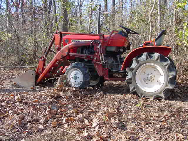

I agree completely. Right now I have a YM1301D that I got with tiller and loader. I attached a pic. I have since mounted the belly mower, but it isn't compatible with the loader since the electric clutch mounts on the front of the bumper and adds about 4 inches. It interfers with a cross brace between the loader arms. I plan to have that brace moved forward about 4 inches so that this tractor "does it all". Then it would be perfect except that a powershift would really be nice.
As for mounting the deck on a "non-Yanmar" grey tractor - it can be done. The deck I mounted was not intended for a tractor like the YM1301D. (YM1301D is 3cyl, the YM135/155 are 2 cyl, and the frame dimensions and bumper spacing is different). I know the compacts that Mitsubishi sold in the US had the same front pto arrangement for belly mowers and snowblowers. Most of the imported tractors have mounting holes in the front bumper, and a "cutout" in the sheetmetal for the shaft. The most difficult problem would likely be getting the "stub" that mounts to the crank pulley. Then of course there is the issue of idler pulleys, etc.
