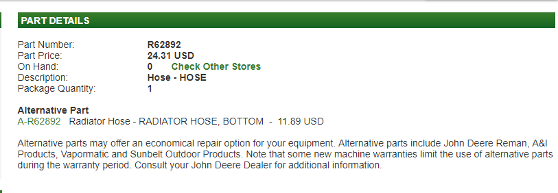

That same hose can be purchased from JD as that's an A&I part number.

I believe that aftermarket company is just using the Deere part number. I've seen that done a lot.
The Deere part is about $25. I'm a little skeptical of some aftermarket parts unless I get a recommendation from others. Some after market are as good, the exact same part or better than OEM. Others are just plain crap and not worth putting on.

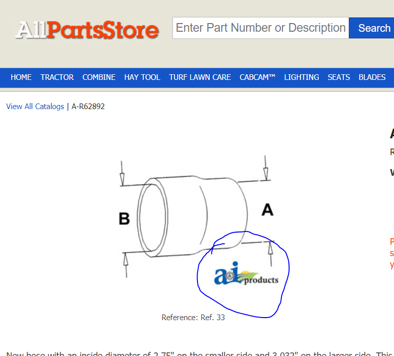

Notice A&I logo encircled in blue in Allparts parts description. Hyd leak above starter is more than likely come from the SCV valve which could have been caused from too high stand-by pressure. Starter not operating correctly could be caused by several things including the oil leak.
Does the A&I label indicate that it is an original John Deere part?

A&I is a parts distributor owned by John Deere. A-part number indicates A&I as the source. The yellow starter exciter wire will have 12 volts but isn't a ground connection
