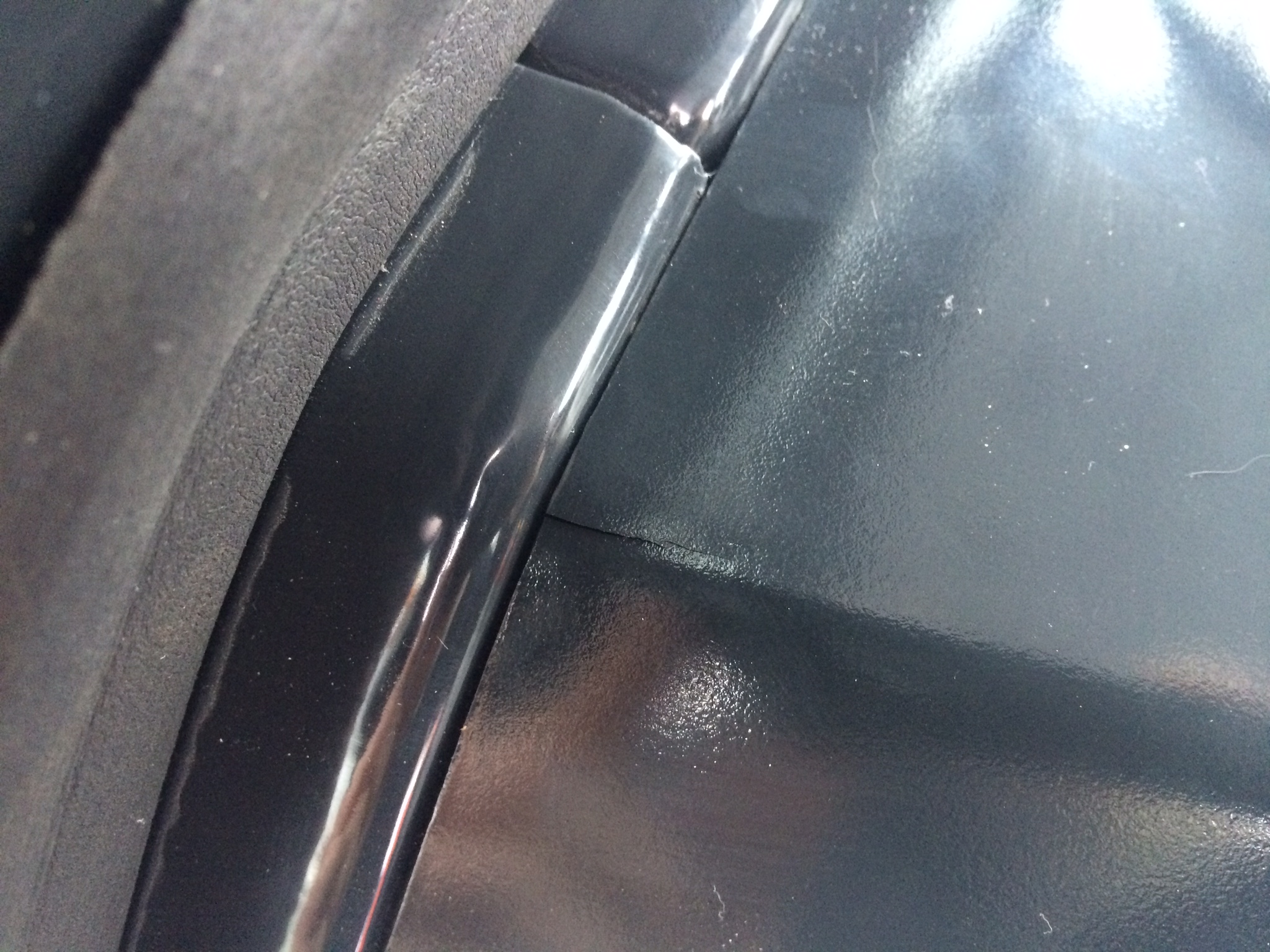

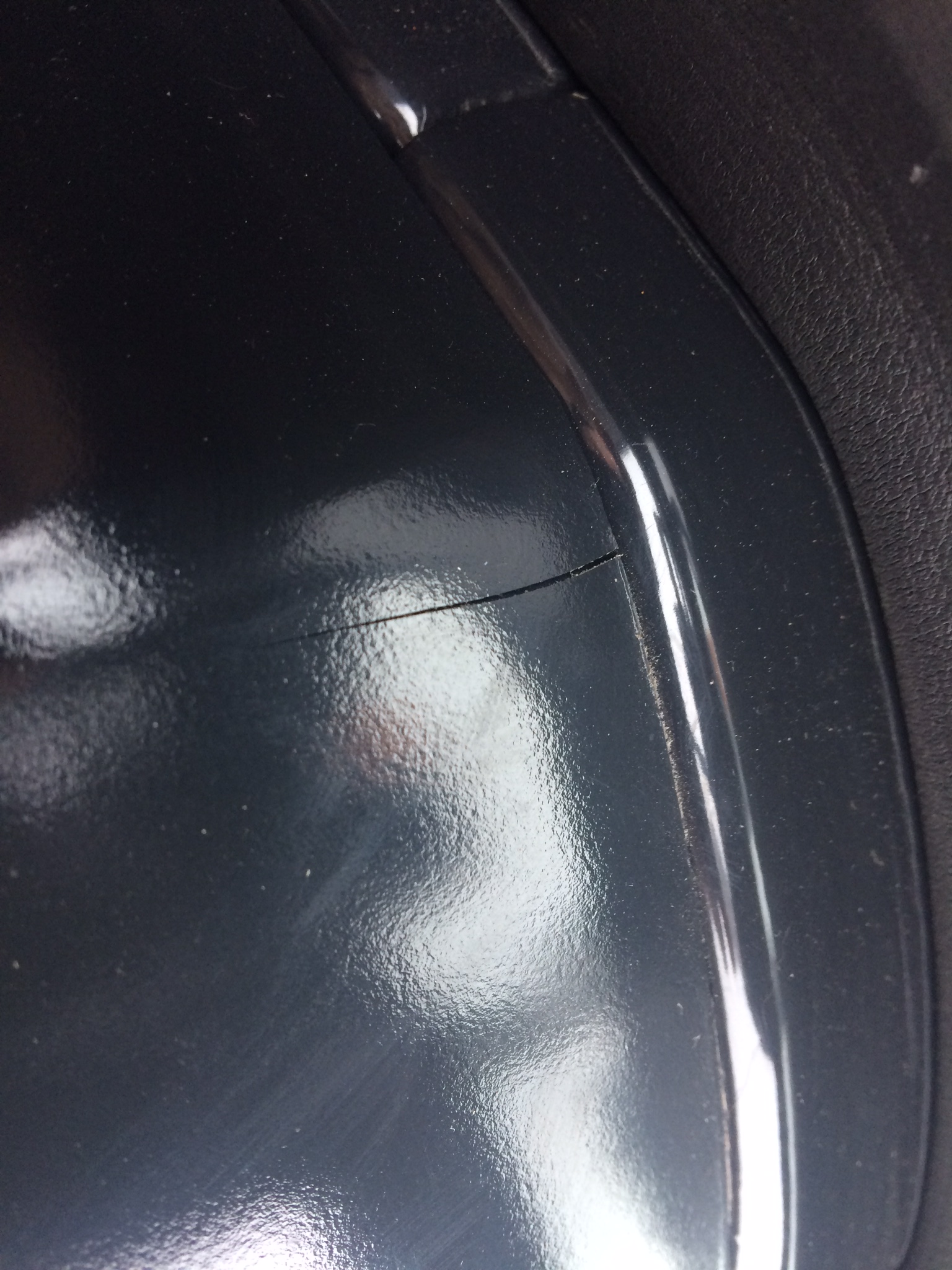

Has anyone ever took apart the instrument console on a ck35? I'm just looking to see the level of difficulty and possible instructions. I'm thinking of changing mine instead of transporting the tractor to the dealer for replacement. Thanks

I'm having to replace the cover cause it has cracked on both top edges for some reason. Thanks for info.

I'm thinking that the tabs underneath got broke from shipment and the vibration is what cracked the console. Amvcane the tractor handles the 6 foot blower just fine. It rarely bogs down. The only time it bogs is when I push a bunch of snow in a pile and hurry to blower it out of the way. If I take my time when I make these piles, then I'm fine. I bought the 6 foot blower cause of the deal. Now that I have that size, I don't think I would go any smaller or bigger.
