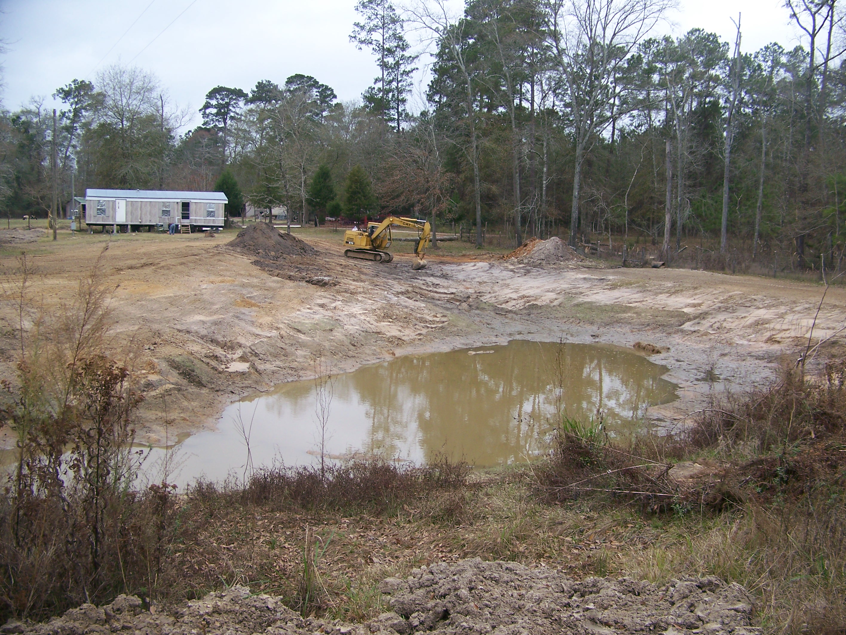

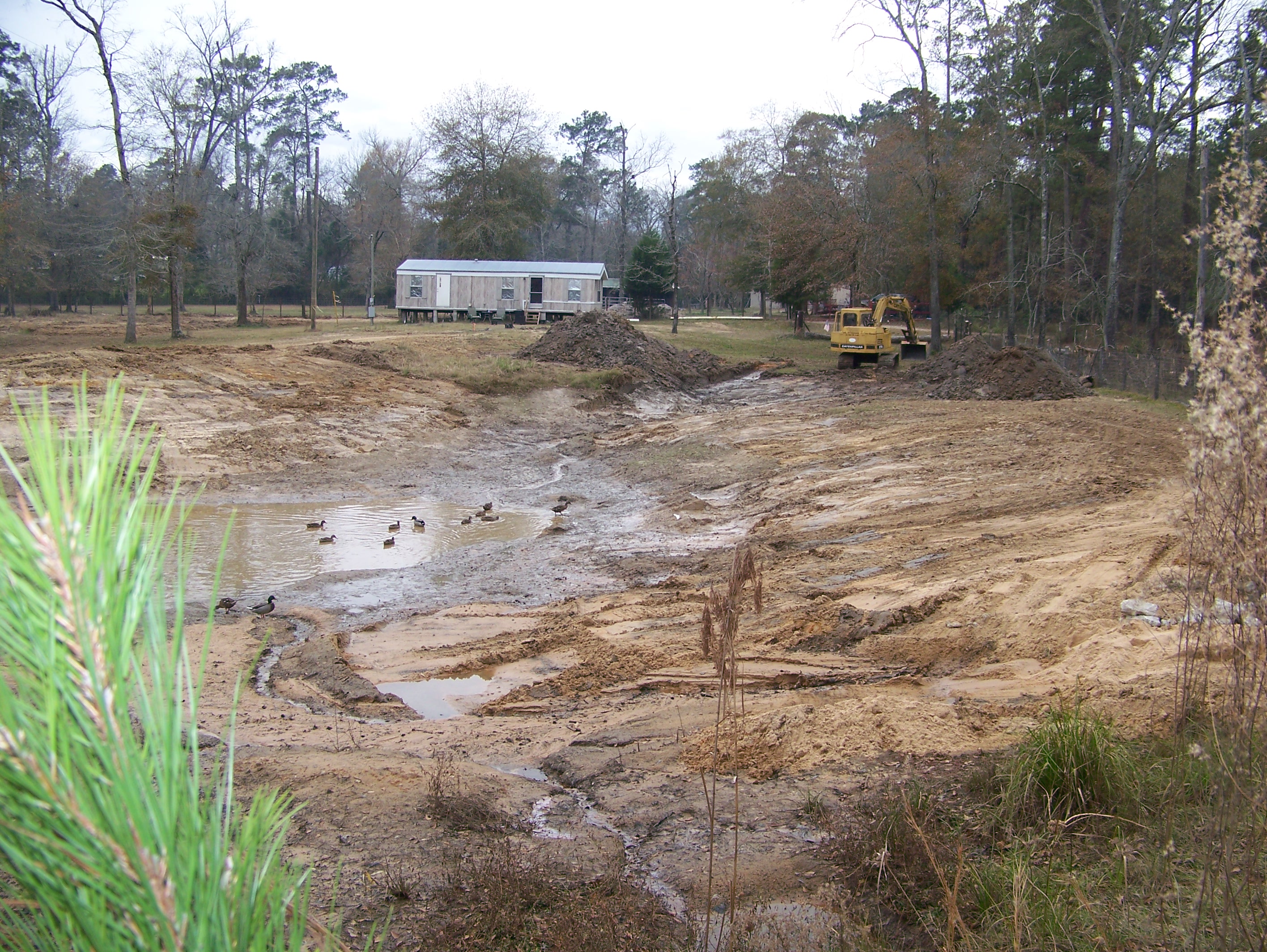

I had 18 days off for Christmas thru New Years. The weather was good, so got a few days in digging and moving the dam back. 1-1-20 Fritz Near Pond.jpg1-1-20 Pond NW Slope Finally Finished.jpg

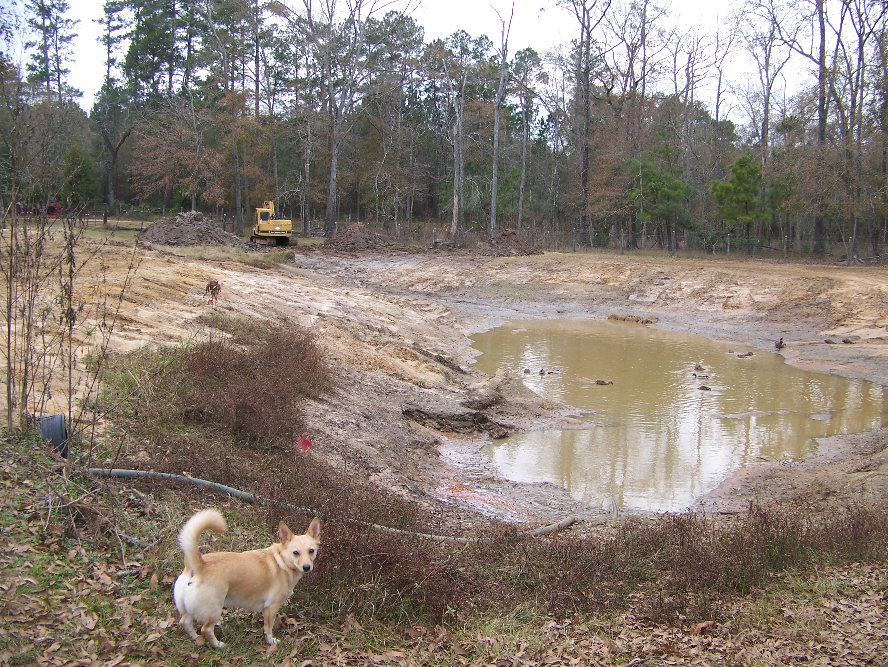

The (new) shallow end of the pond was difficult to figure out how to dig it with water continually entering and piles of dirt blocking my vision. Then I came up with the idea to just dig a sloping trench from the existing pond area up to the shallow end. Then I just parked the CAT on the side of the trench and dug and backed up until I was up on the bank or dam. It was fast digging as long as I didn't get on the tractor to move dirt. I knew rain was coming , so I dug and piled the dirt as high as possible. When it dries up a little, it will be moving dirt for a bunch of hours.1-1-20 Pond Slope Indicator Trench.jpg
The red, red clay was from the small pond dug back in 2009. I put the clay there as I ran out of places to put the spoils. This area was all woods and swamp. Now it will be a good size pond. I am anxious to finish and see the newly dug area at full level.

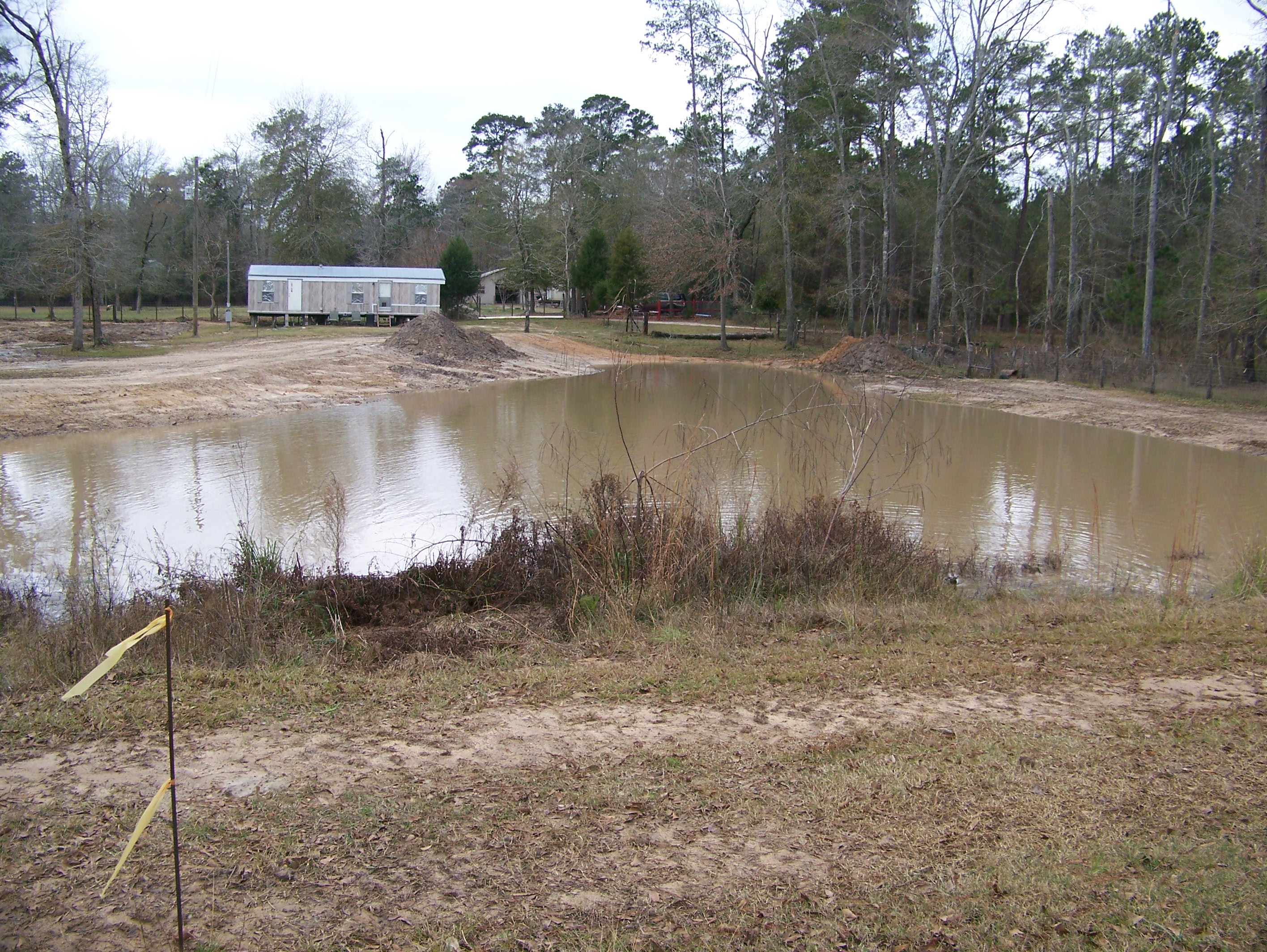

We got 1.25 inches of rain. The pond is about 20 inches of being full. This is the main reason of moving the dam back. To capture massive runoff. Yesterday afternoon's photo. 1-10-20 Shallow End Digging Defined.jpg

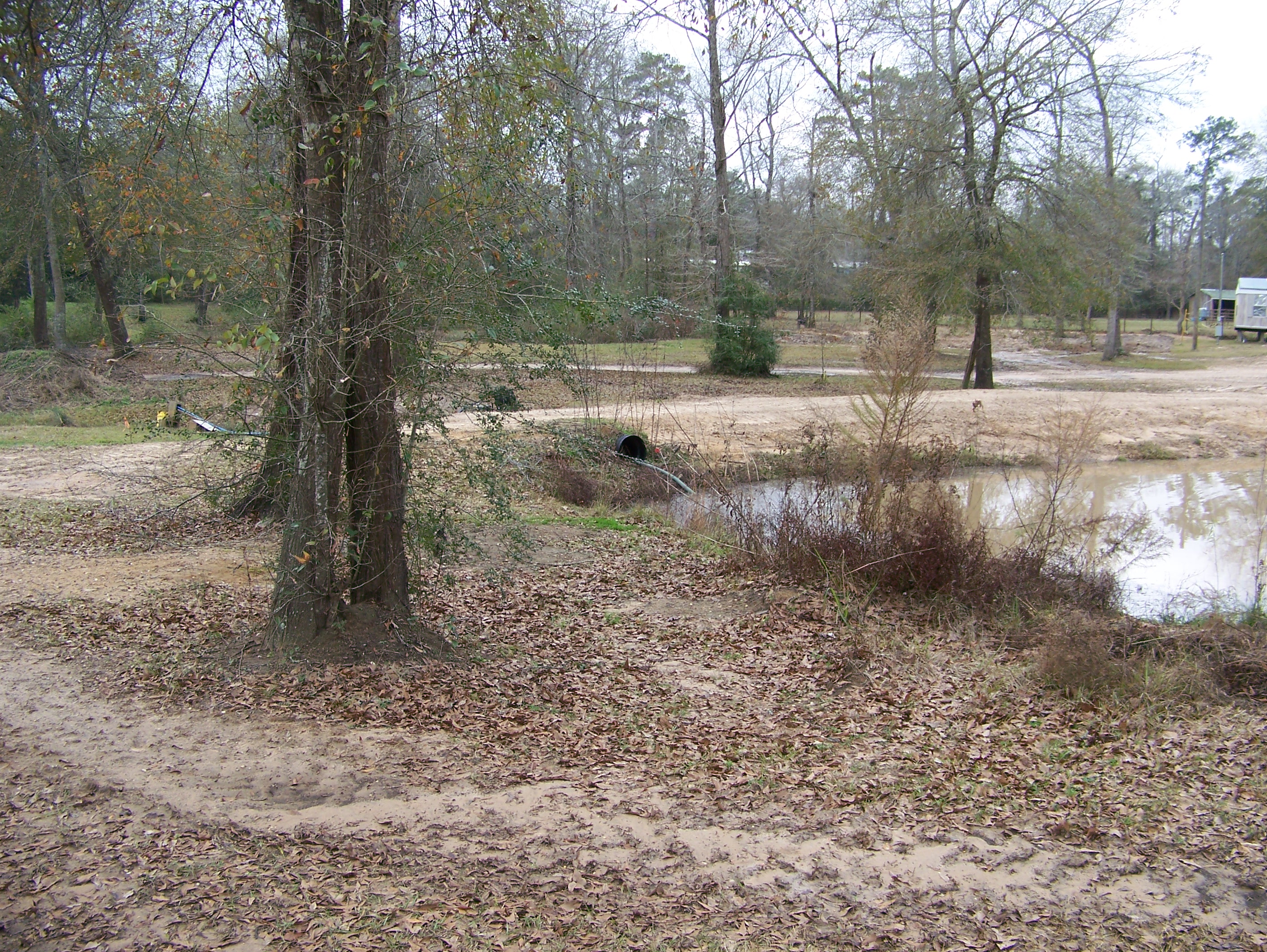

This morning's photos. 1-11-20 Pond Almost Full After 1.25 Inch Rain.jpg1-11-20 Pond Overflow Pipe.jpg
hugs, Brandi
   / Instant Pond #410
That's an amazing change!!! We received an inch and a quarter too, but I didn't even notice any difference in my pond levels. I'm sure they are up, but not enough to make me notice. We've been so dry for so long that most of it just soaked into the ground.
