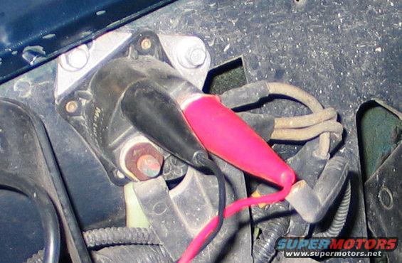

I need to bleed the air from the 6 cylinder diesel on my Ford 6000 after the hose between two metal section of the fuel line failed. Working on my own makes this difficult due to the need to turn over the engine at the same time as cracking the bleed screws.
Has anyone fitted a remote switch near the injector pump to make this easier? I presume it will be nothing more than a couple of heavy wires from the solenoid to a new switch mounted on the frame near the pump
Any suggestions appreciated
Alan

No, you are not blind.
Some have that lever but many do not. (mine does not either)
If your starter is on the same side as bleeding operations you can easily jumper the solenoid to attain the bleeding. On mine I can easily reach the switch.

Thanks Piloon
Unfortunately, the starter is on the opposite side of the beast and the regular starter switch is in the cab of course. I'll have to run wires from the solenoid to a new switch mounted onto the frame. This picture is helpful - thanks to BHD for the link
