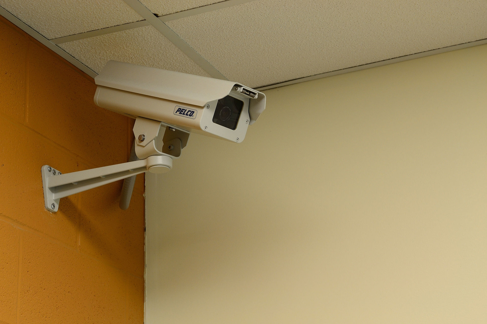

I’d rather deter a thief rather than shoot or catch him. Dog or several VISIBLE big ugly Pelco cameras, working or not.
Oh look at this, a sign that says, cover my lens, come on in and use the bathroom for two hours. Bring all your friends.
