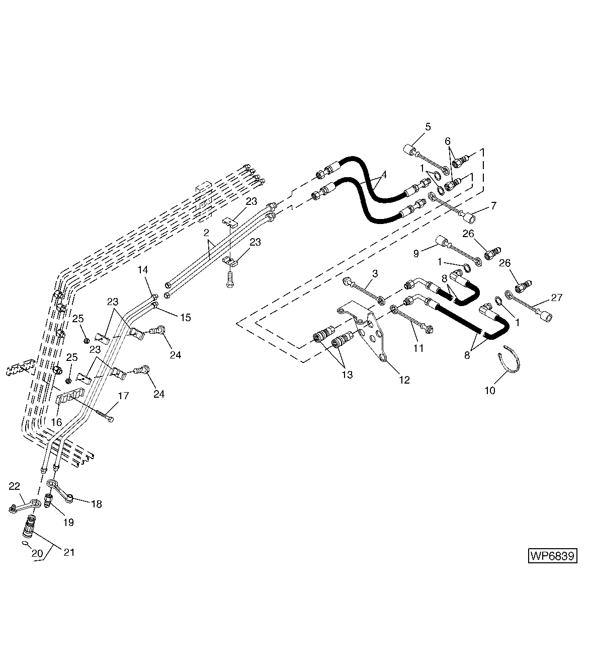

I have a 4320 and am going to be purchasing a 400cx loader soon. Having the dealer install it is complicated and expensive, so I'm thinking about doing it myself. I was wondering if anyone here has done it themselves? How about if I included the 3rd function on the loader? What's involved with that? Are there electrical connections involved?

Are you planning on having the crated loader delivered to your place? Do you have an overhead chain hoist or a heavy duty engine hoist, etc.? Got a good 1/2" drive torque wrench - 350 ft/lbs? Some pretty good sized metric sockets - up to 32-34mm?
The owner's manual for the JD 80 FEL and the JD 430-460 illustrate the steps to put the loader together for the 1st installation. Based upon those comparison's - I don't believe it would be a real complicated exercise - IMO.
The 3rd function lines are steel lines that run down the inside of the loader arm. There are quick-connect ends and a mounting bracket at the horizontal base arm of the loader near the bucket. No electrical connections on the loader.
You'll have to do some research to determine exactly how you might plumb the 3rd function FEL SCV's into the hydraulic system of the tractor. The simplest solution is if you have a rear SCV and plumb short sections of hose from the rear of the tractor to the hard lines on the loader.
A more complicated approach would be an electric over hydraulic valve (JD diverter valve) or a Fasse valve. These involve a significant outlay of $$.

AK spelled it out pretty good...It won't be "hard", but there is some heavy lifting involved.
As for the 3rd function on the loader, it is just steel lines that attach to the inside of the loader arms, very easy to install. BUT-as far as plumbing, the JD kit just includes long hoses that go under the tractor and plugs into the rear remote, it does not tie into the hydraulic system independently. I will attach a picture below. No electrical connections whatsoever.
Parts from this kit could be used to add a true independent 3rd functions on the loader or a diverter that will "split" the dump/curl circuit for use with a grapple or snowplow-but that is more complicated and can be discussed more in detail if you need that later.

Very helpful, thanks. I was expecting the 3rd function kit to include a little more...diverter, etc.
