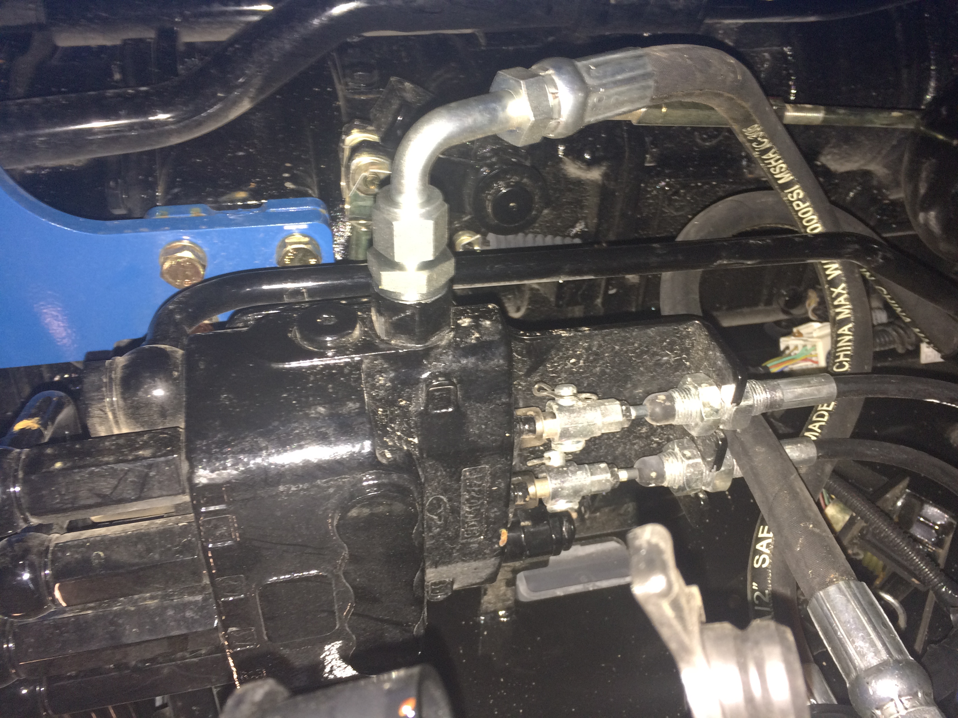

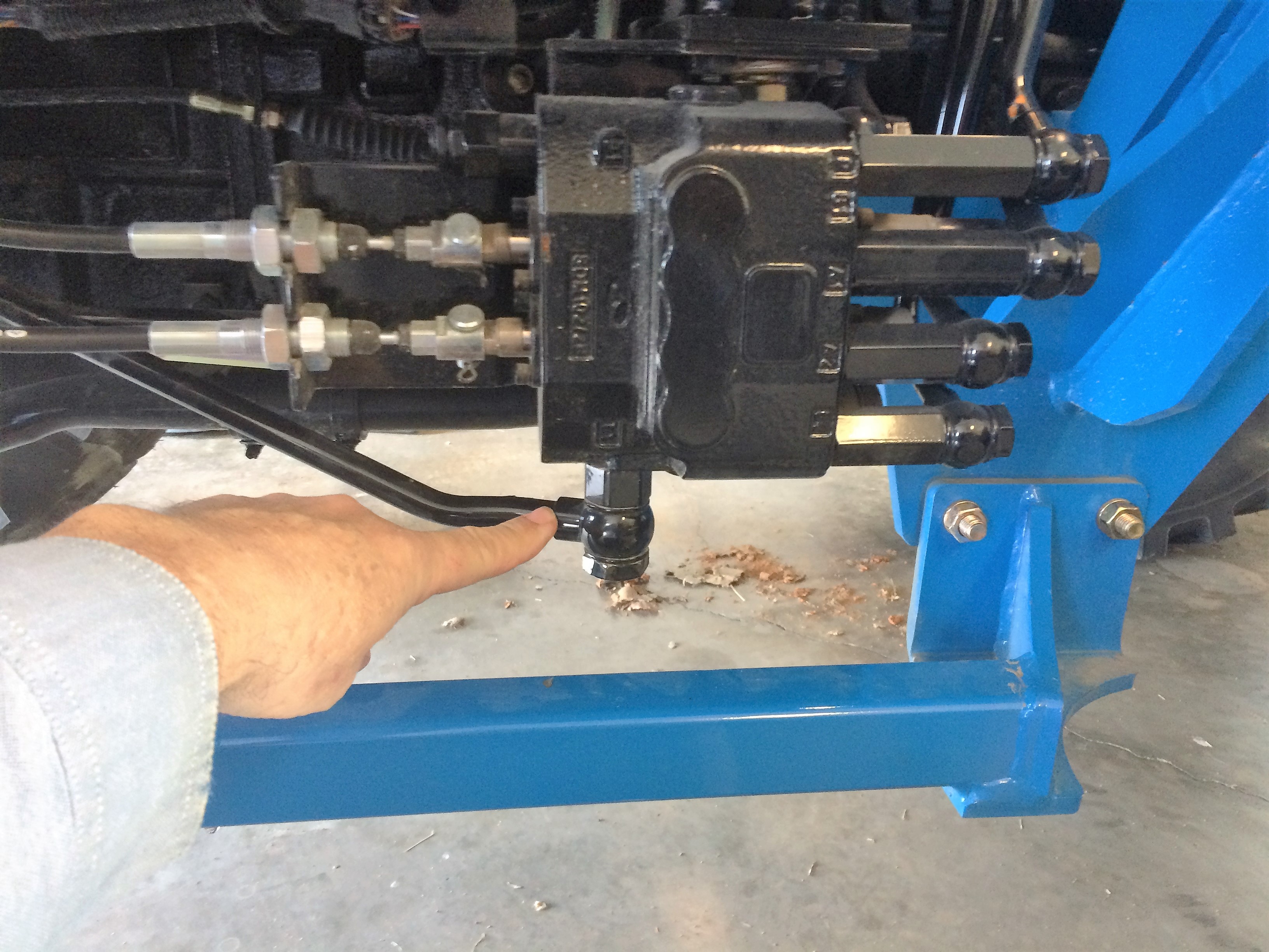

The First picture is of the POWER BEYOND PORT on the front end loader valve. You can see the hydraulic hose is hooked to the loader value with a banjo fitting, and the metal hydraulic hose goes aft about two feet where it hooks into the REMOTE CONTROL VALUE on my tractor. I had to remove this hydraulic line totally, and the 3rd FUNCTION REMOTE hydraulic valve is installed in series between the two open ports resulting from removal of the hose.
Here is a picture of my finger pointing to the POWER BEYOND PORT on the loader hydraulic value.

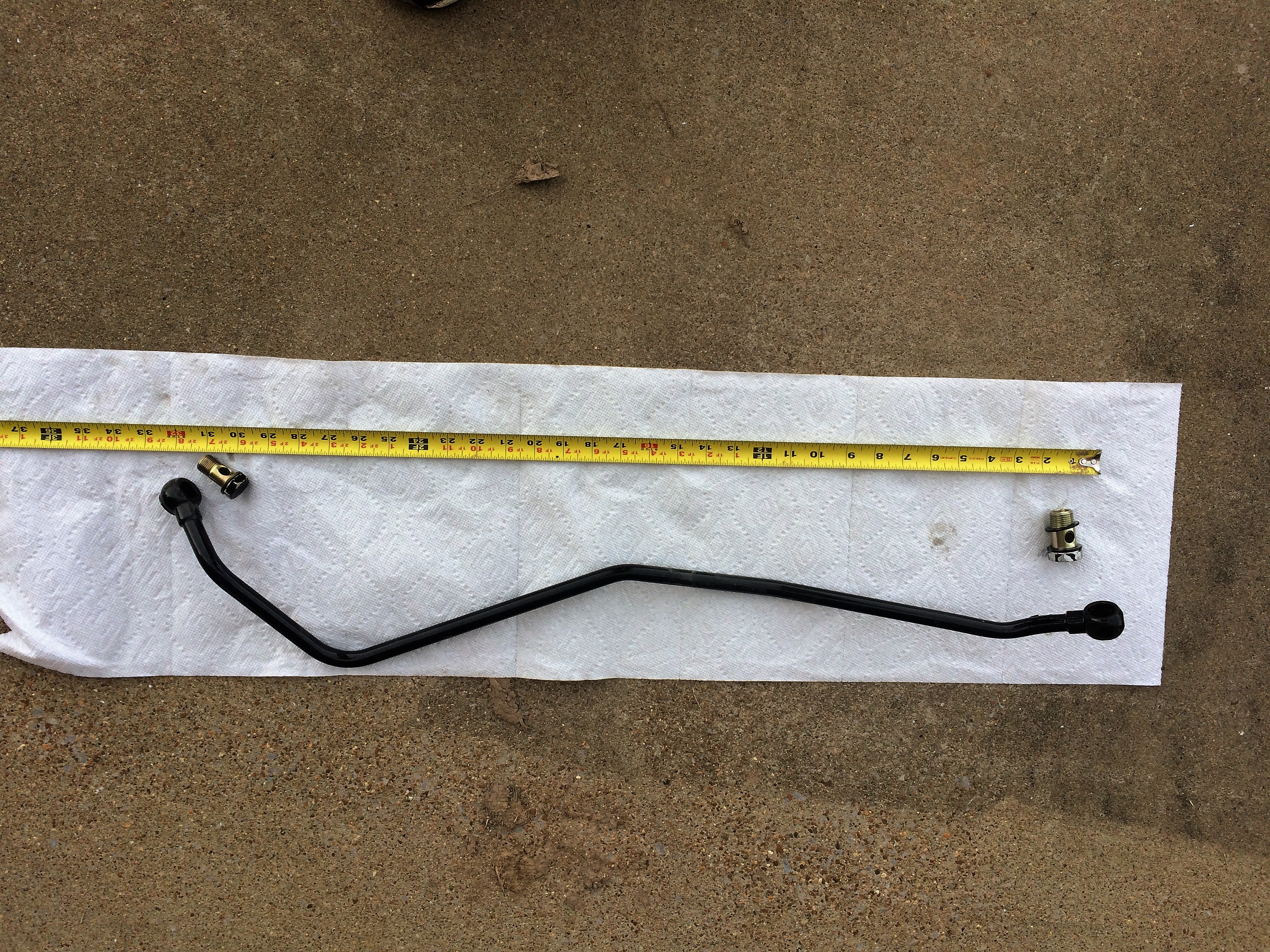

Here is the picture of the hydraulic line removed. This hose and the banjo fittings are NOT put back on.

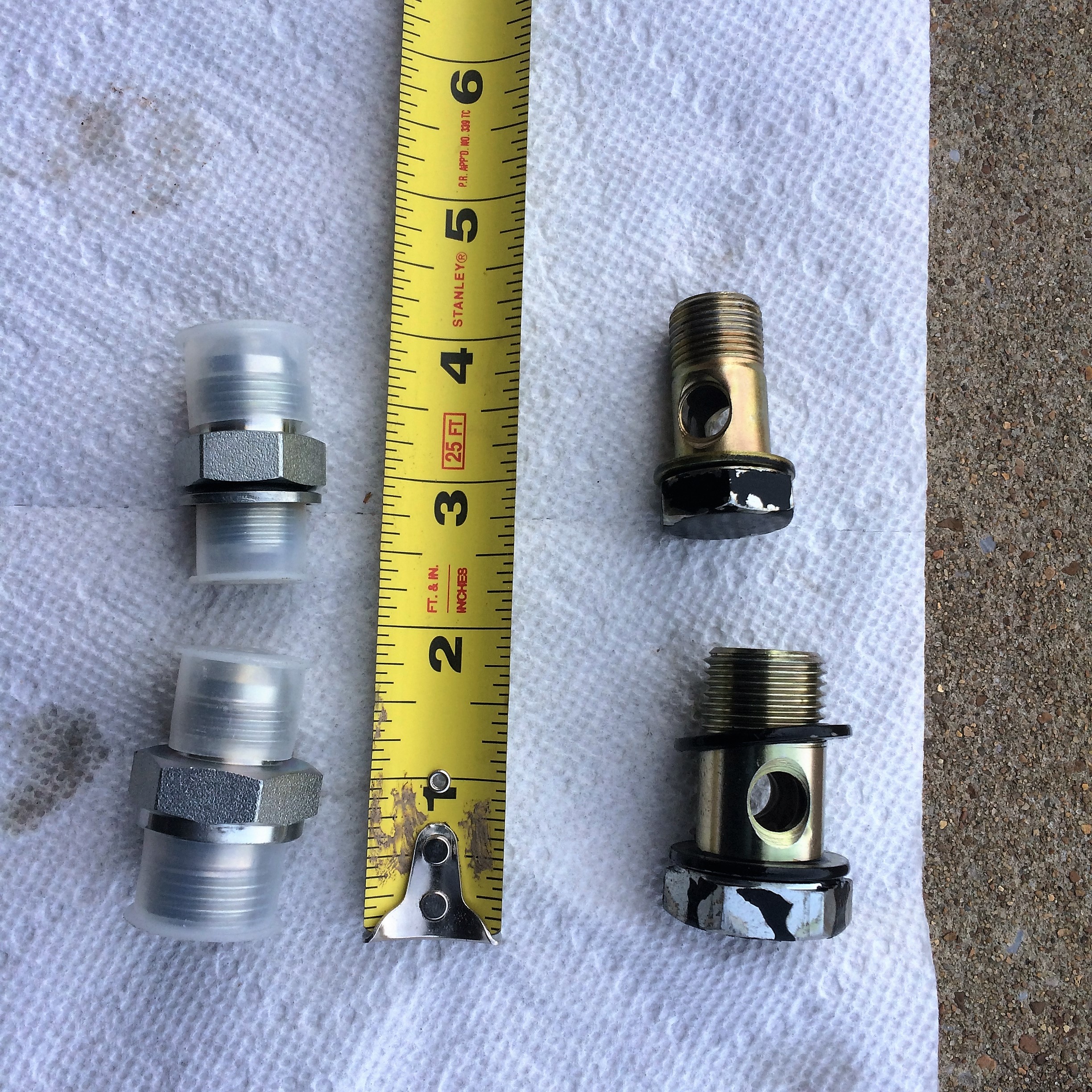

Here is a picture comparing the kit fittings that replace the original tractor banjo fittings.

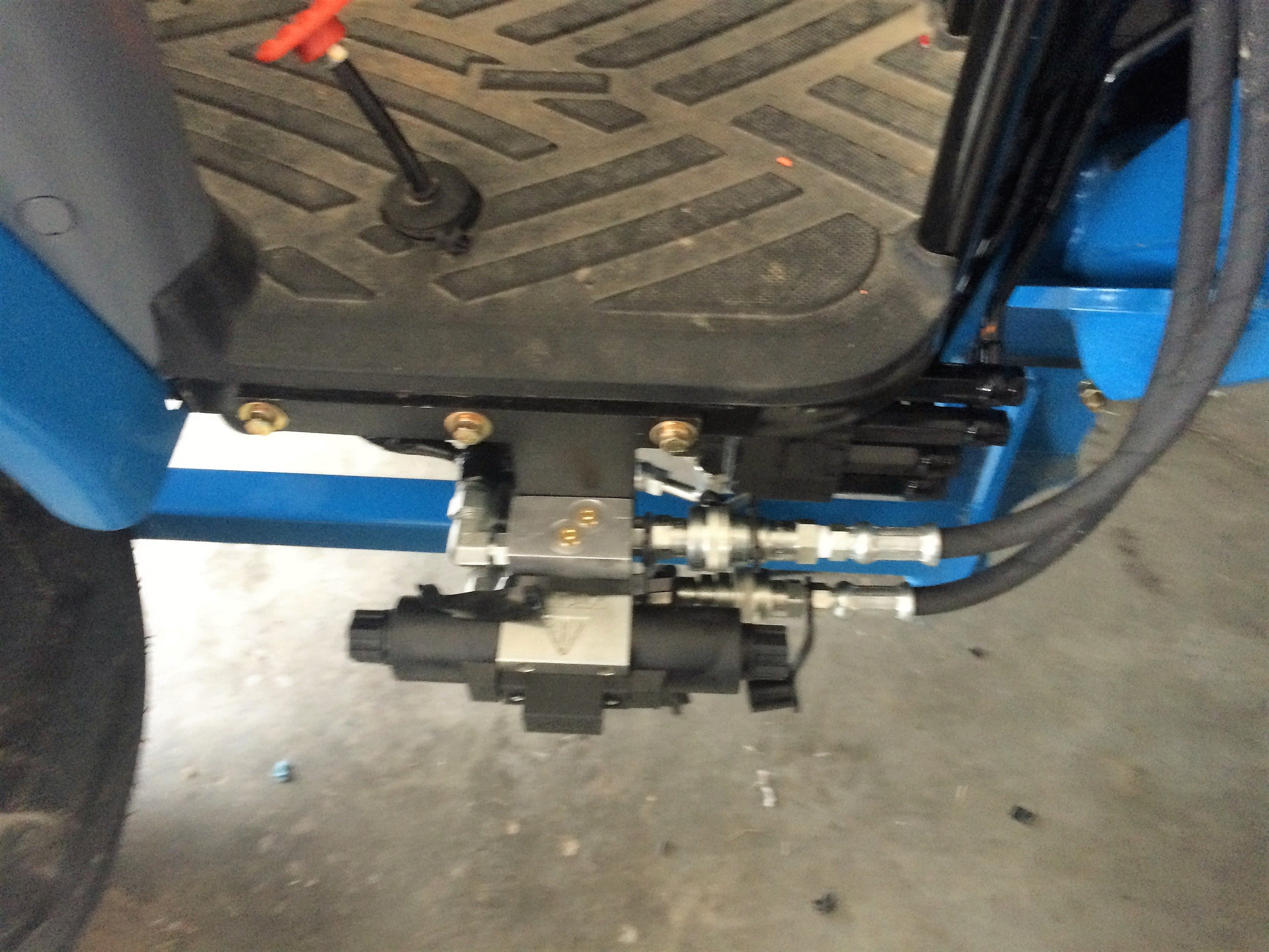

Here is the new 3rd FUNCTION REMOTE installed in place of the right hand step of the tractor. I have already hooked up the hoses on the front that go up to the grapple bucket.

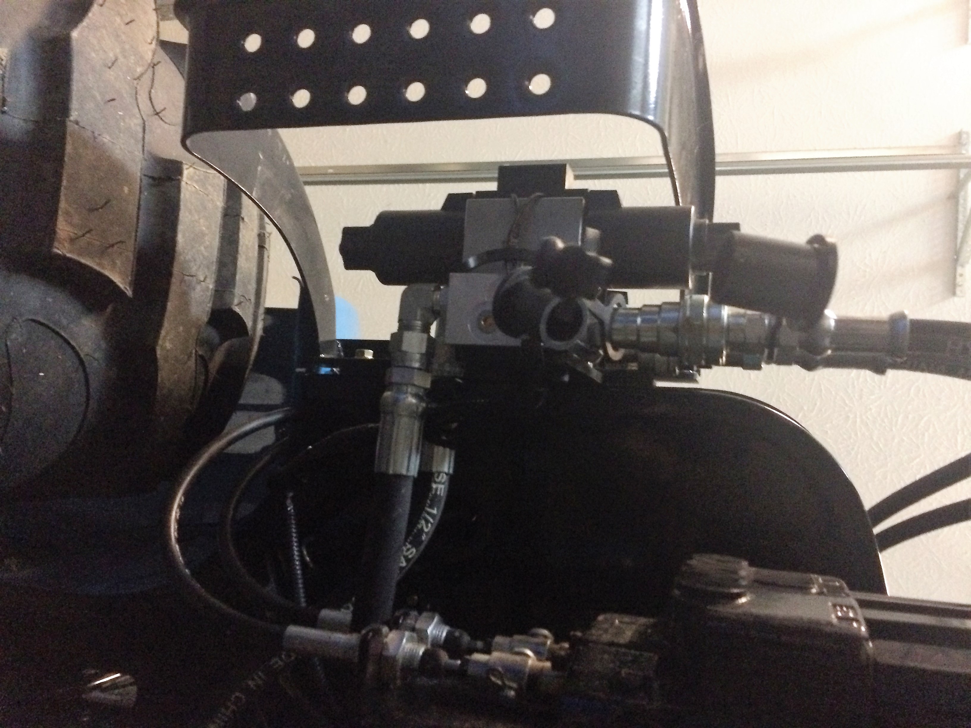

I now hooked up the two hydraulic hoses provided in the kit to the tractor. The following picture is looking from below. One of the hoses coming down from the 3rd FUNCTION REMOTE valve goes to the loader value POWER BEYOND PORT and the other hose went to the REMOTE CONTROL VALUE back near the right rear tire. The 3rd FUNCTION REMOTE value has letters on it to ensure you hook them up correctly.

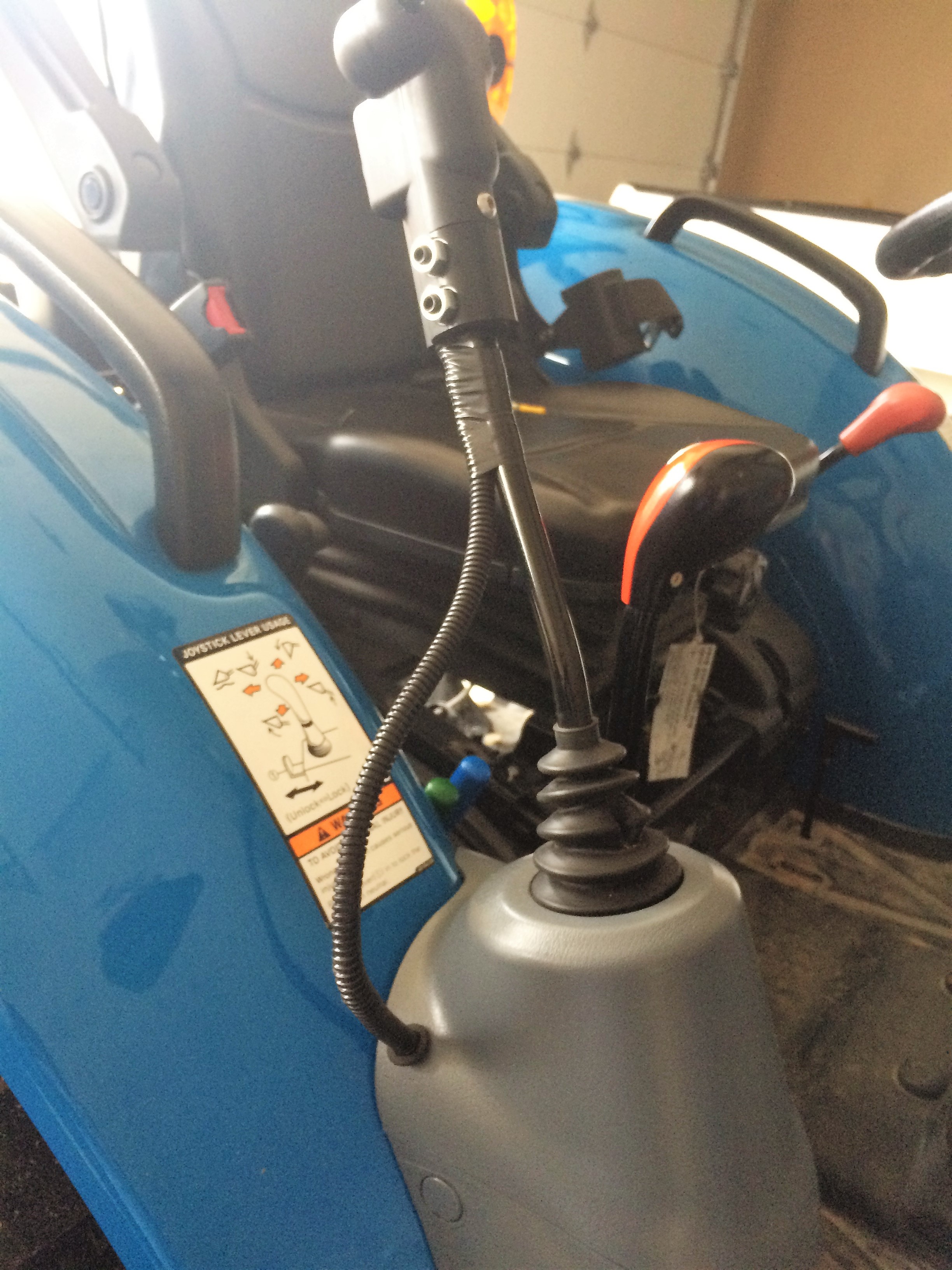

You have to find a 12V electric source from the tractor. I pulled from a switched terminal on the key, but intend to go back and install a switch on the dash with a relay from the battery. The kit includes a new joystick to replace the one on the tractor and it includes a switch that operates the grapple. It also has three wires, two of which hook up to the 3rd function remote and one that provides 12V power from the tractor to operate the remote. I show a picture here for how I routed the wire inside of the trim on the tractor. The kit came with the plastic wrap to protect the wire. I purchased a rubber grommet where I went through the plastic trim. Obviously you should leave some slack in the electrical wire so the joystick can move.

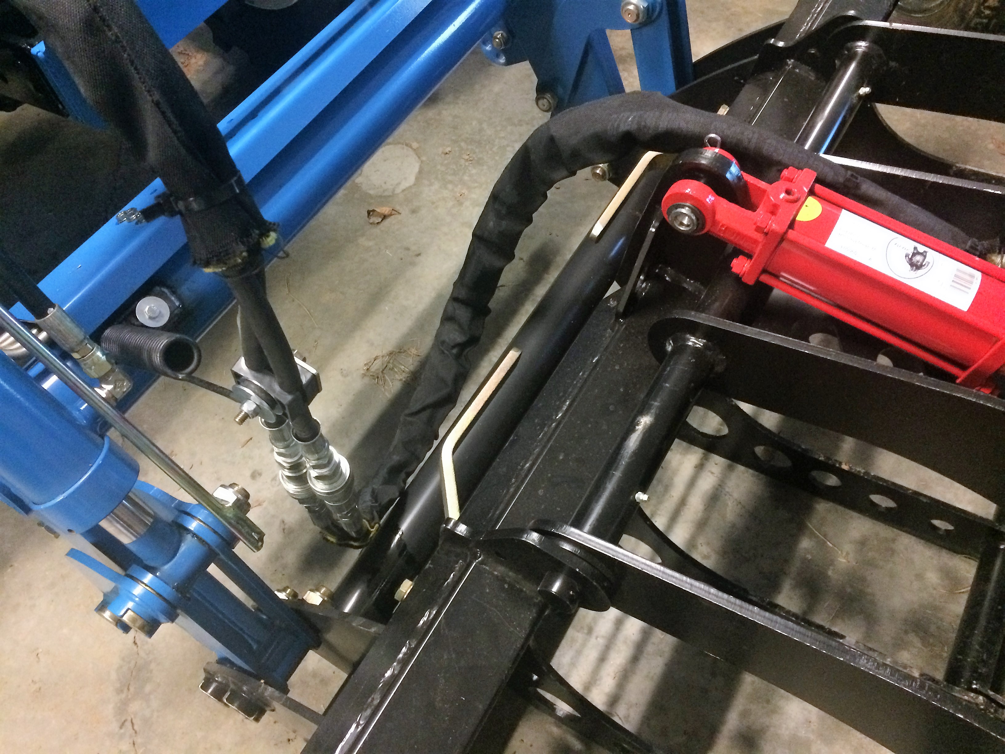

The other issue I had was the hoses up front at the grapple had nothing to hold them in place and hung below the level of the grapple. I was worried about them getting caught on something and ripped off. I ordered a Hose saving spring kit from EA and had my local shop weld it on the loader. I had to put it to the side of the loader to keep it from hitting the brush guard when the loader and bucket were tilted. The springs provide some flexibility if the hoses get caught on something. I had to play with it a bit to ensure none of the hydraulic hoses were rubbing.
I also added hydraulic hose wrap that I purchased at my local hydraulic supply store for additional protection. Even with the bucket all the way down, the hoses are still about 6 inches from the ground and have good clearance in all positions.
Here is a picture of the installed HOSE SAVING SPRING KIT on the front of the loader.

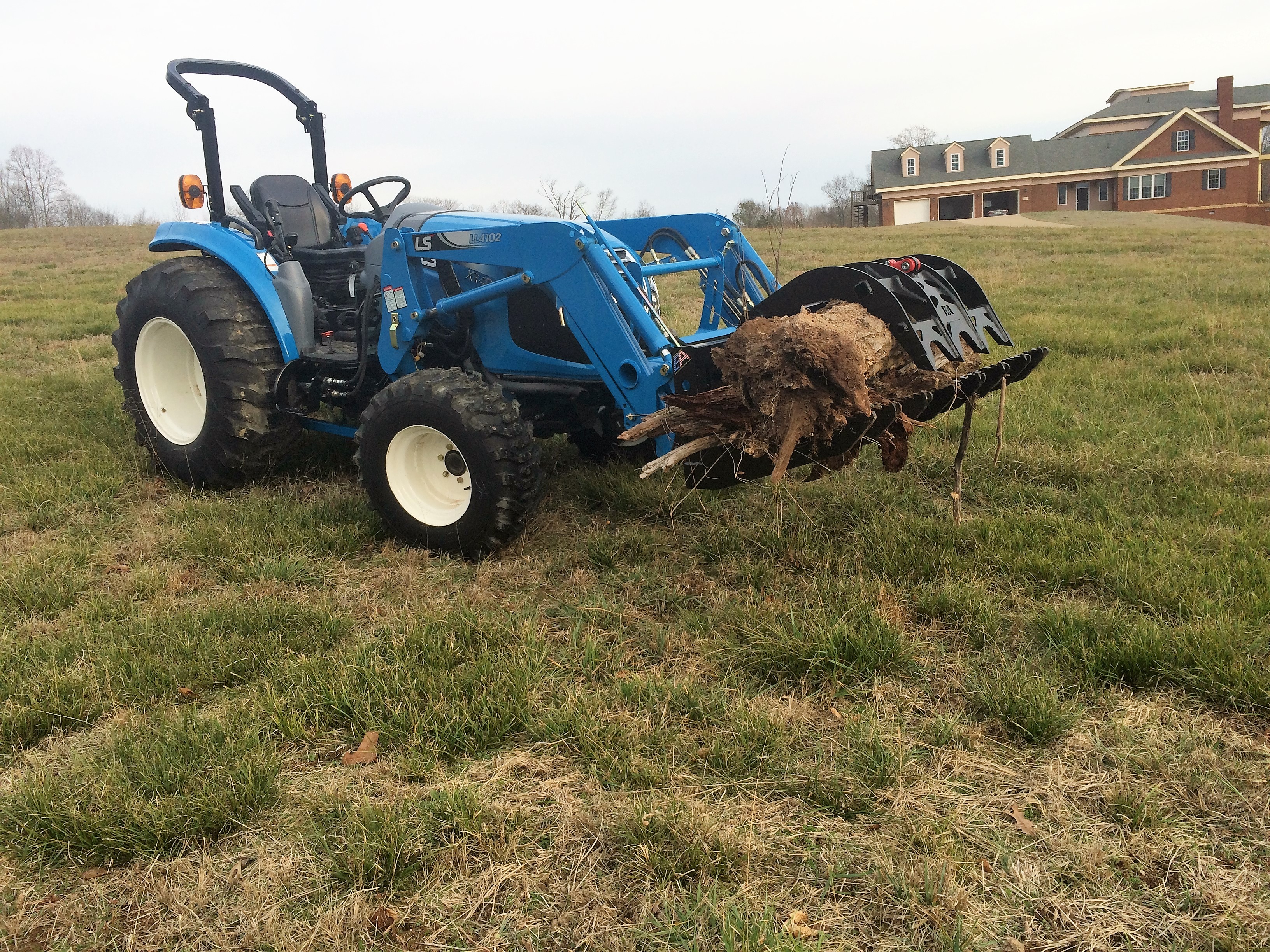

I love the grapple and why did I wait so long to purchase a tractor?

Here is the power beyond port on mine. Yours is probably the same since they both are 4100 series. It's the port just below the 2 cable controllers. Has the 90 on it.
Here is where I put my valve. It works good here and is out of the way.

Resurrecting this thread as it was helpful to me as I installed a third function valve kit onto my new XR4140H. I worked out a few things that were an improvement for my needs so I thought I would share them here.
The first thing I did was to remove the valve from the steel mounting plate, clamp the mounting plate in a vice and bent it at a 45 degree angle along a line between the mounting holes for the valve and the mounting holes that mount the plate to the tractor. That allowed the valve to tuck under the tractor deck. This improved the position of the hoses and made it possible to reinstall and use the step on that side of the tractor. Once the plate was bent with a 5 lb hammer, I re-attached the valve and installed the whole thing onto the tractor.

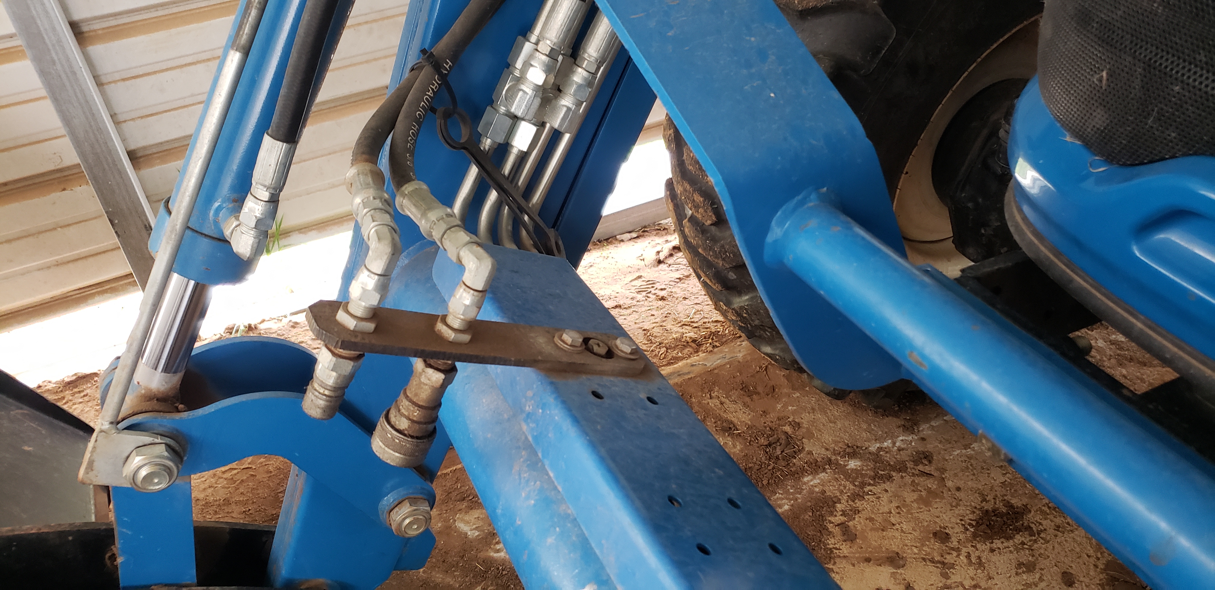

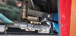

I mounted the solenoids at the rear of the cab, just under the window. Mounted the hydraulic connectors on the loader cross member. Here are current pic,s.
