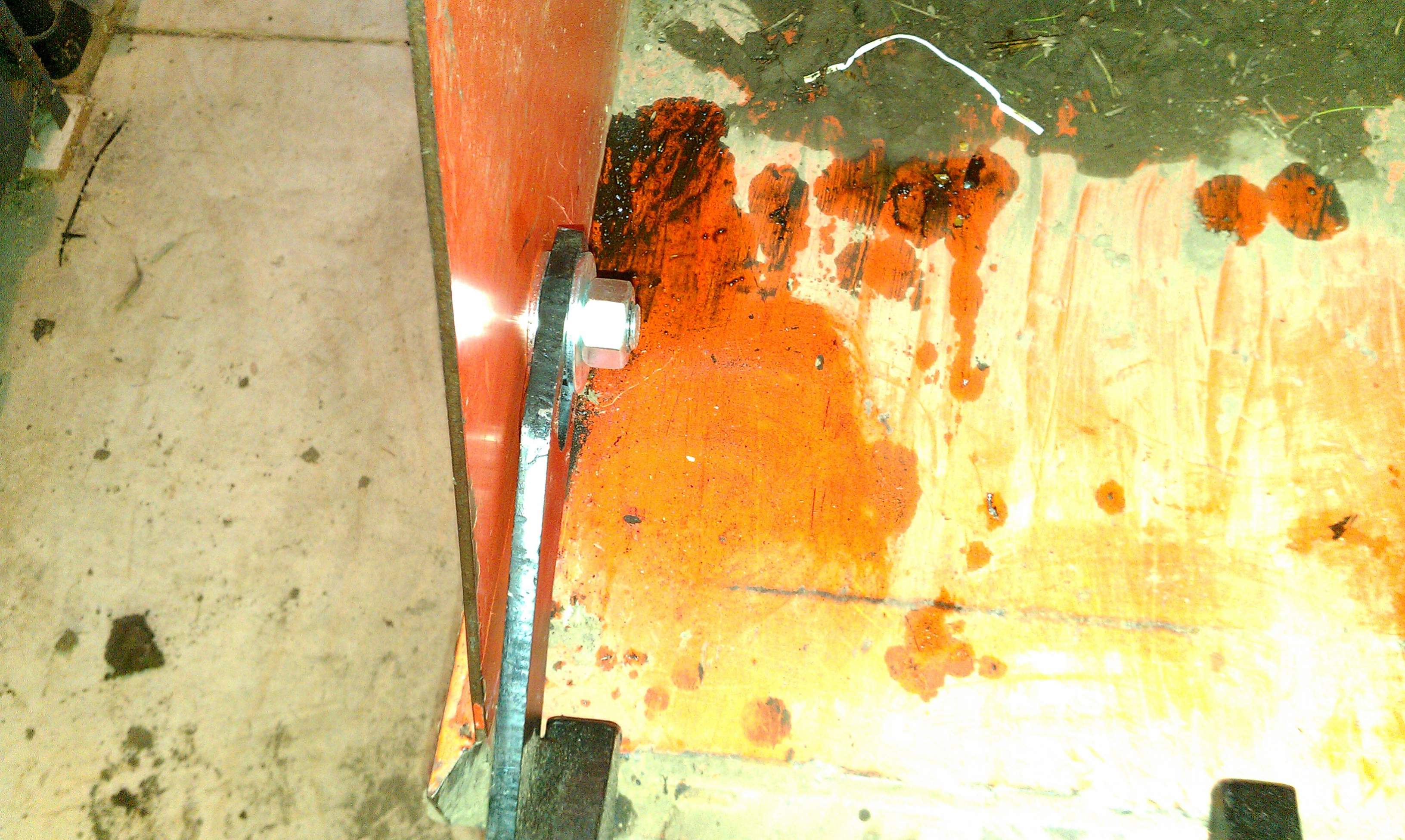

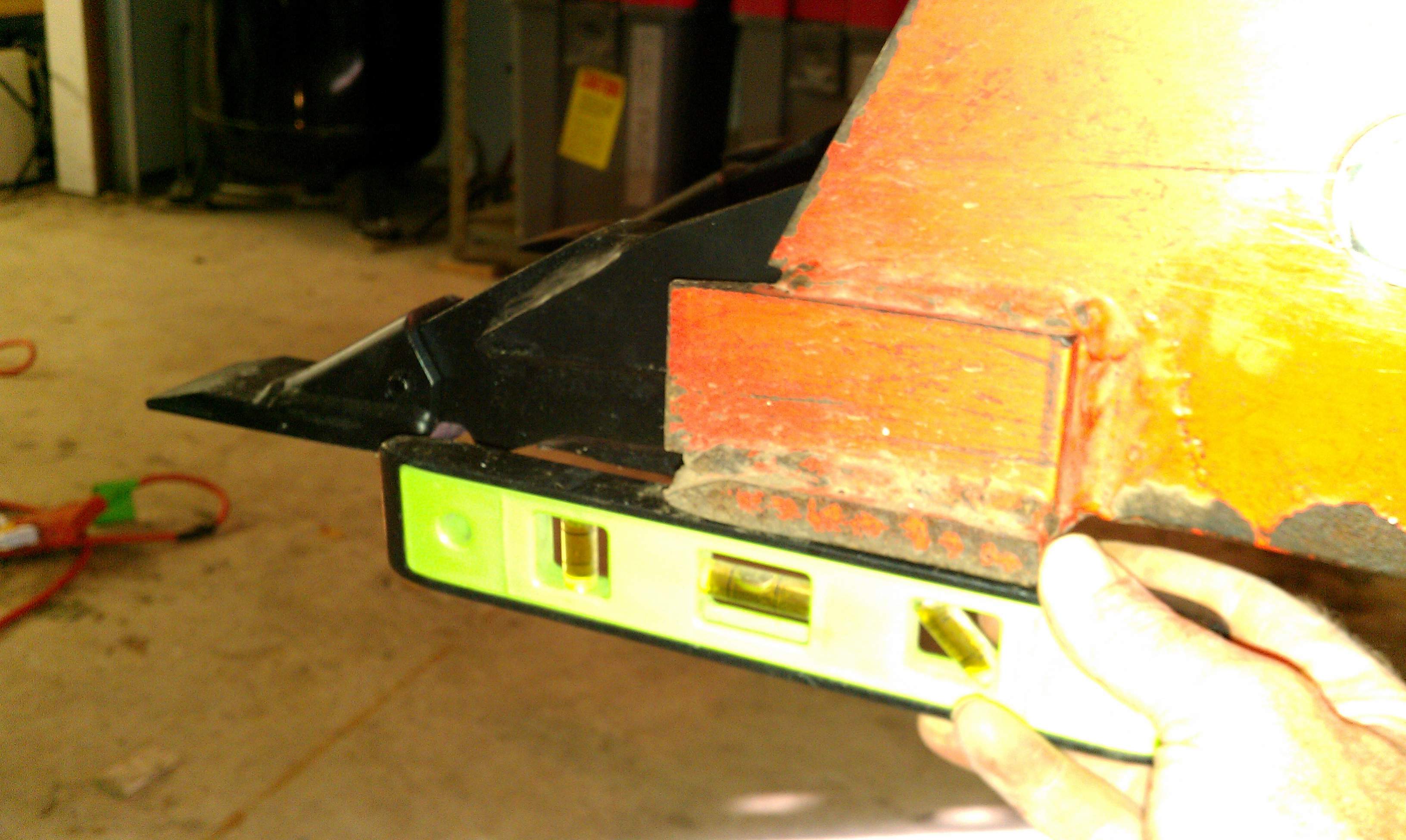

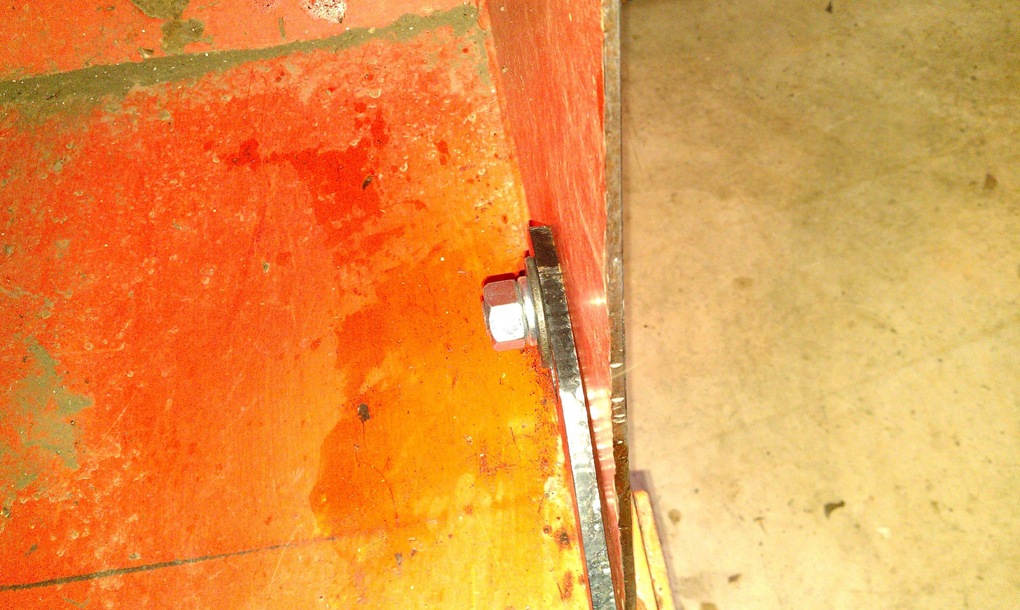

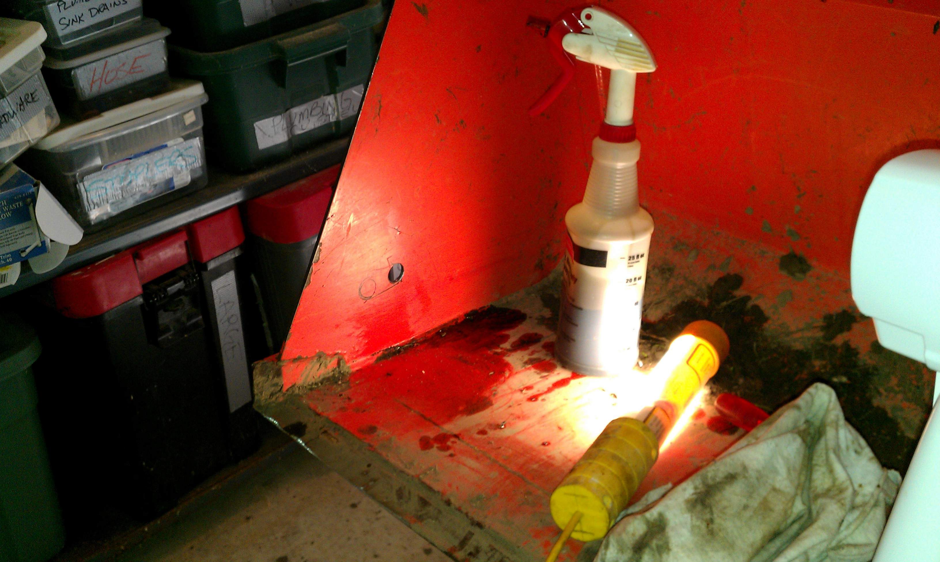

Bought a flat tooth bar from Iowa Farms, it was drop shipped from W. R. Long. I got a 58.5", cost me $340 delivered. It arrived earlier than promised in good shape. Here's how I installed.
Set the bucket so the bottom of the existing cutting edge was level. Then moved toothbar until bottom of it's cutting edge was level and clamped it in place. (first photo)
Traced slot on toothbar using felt tip pen, then took the toothbar off. Debated mounting bolt in the front or back edge of the slot, called WR Long for guidance. They said the bolt should go in the back edge of the slot, that it was not designed to be pulled forward and folded back in the bucket. Drilled the hole with 3/4" hole saw, note the spray bottle of used motor oil. Sprayed that on while I'm drilling, went through in about a minute. (second photo)
Toothbar was about 1/8" narrower than bucket width, shimmed one side of the toothbar with a washer. I thought it would be better to do this rather than bending that bracket out which might make it hard to remove and install. This way the bar is always 1/8" smaller than the bucket. (third photo). The other side is bolted flush against the inside face of the bucket (fourth photo).
Haven't used it yet, will try it out this weekend. Need to dig out an area to add an asphalt apron to the drive.
