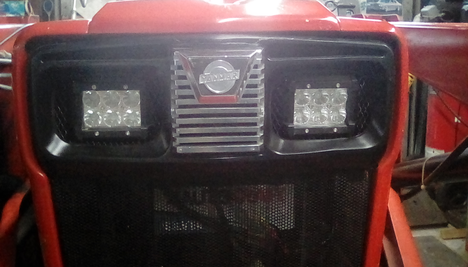

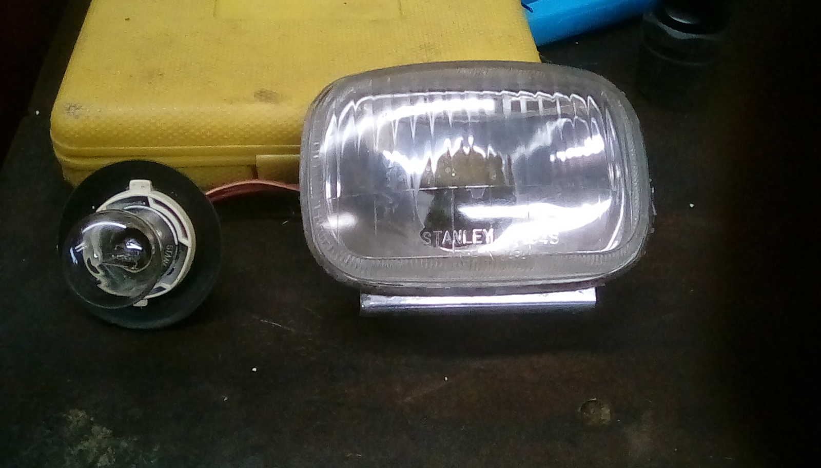

Always the guy to improve on something and not being able to see that well at nite when plowing snow I add some led's. So I went from this IMG_20171105_151929.jpg to this IMG_20171105_152001.jpg.
Turned out pretty well I think.

Did you just install a wire mesh behind the holes and then bolt the lights to it?
   / Installed new headlights
Actually the wire mesh is there only to fill the gaps. Used the existing mounting
bracket the old lights were mounted to. Was a little challenge finding a light that would be close to fitting. Big difference from the original hi/low beam bulbs. They weren't much more than a brake light bulb. Had to fabricate some new brackets but wasn't too hard. Cost about 16 bucks.
   / Installed new headlights #4
Yea those headlights now are not very bright, like you said basically like an 1157 bulb. I keep saying I will do this, but I like the factory look and I seldom do any work ag night so I never follow through.
