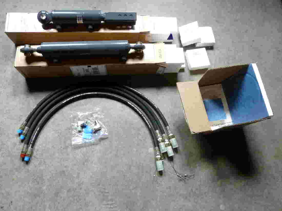

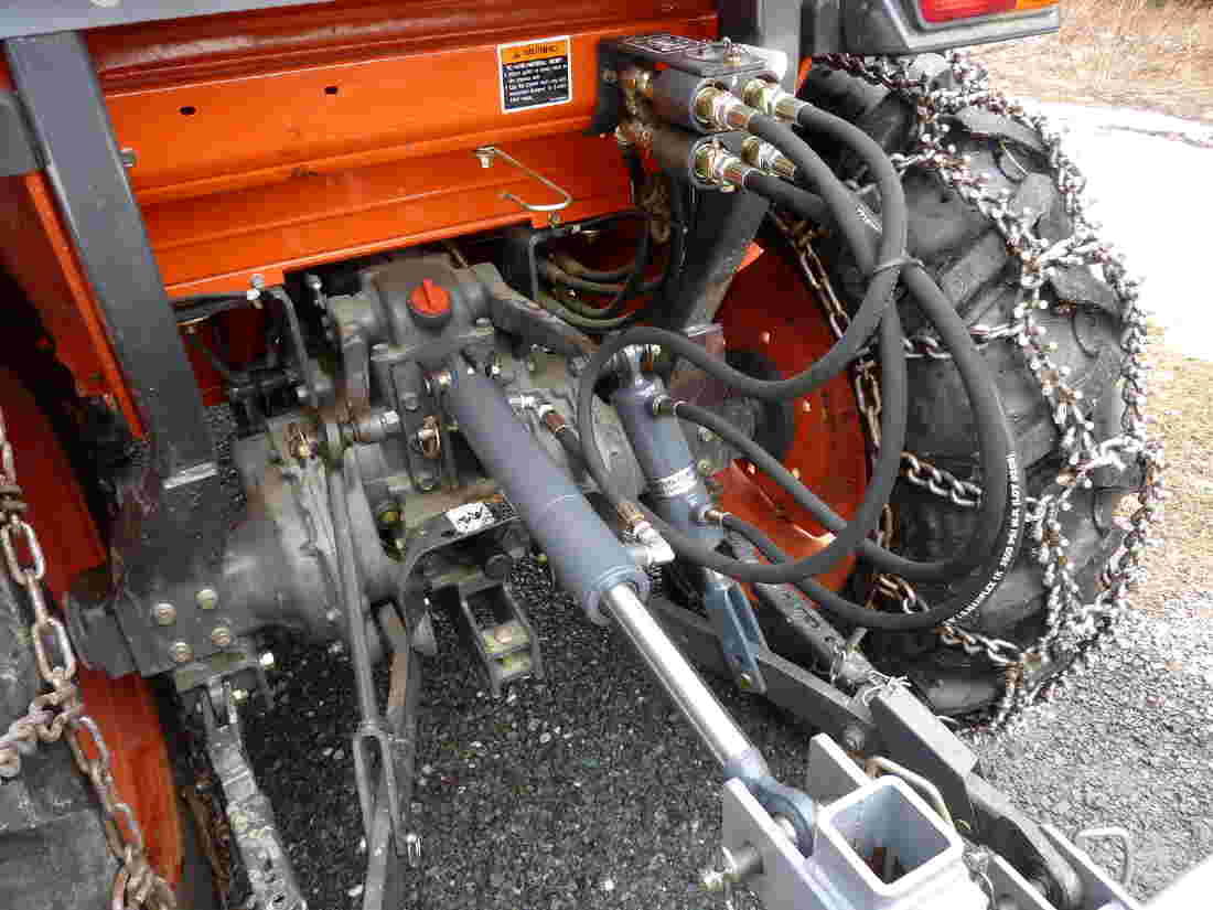

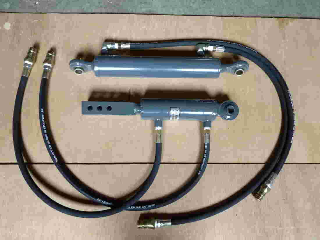

I ordered a TnT kit from Fit Rite Hydraulics and installed it today. All went smooth and I can tell that I am going to like it.
Brian, from Fit Rite Hydraulics, was great to do business with and was extremely helpful. The Top Cylinder was easy enough. I just ordered one that covered the range of my old one. The Tilt Cylinder was tougher and without Brians suggestions and help I would not have gotten what I wanted. He custom makes the cylinder for the tractor. He bent over backwards to make sure everythink would be right. As you can see in the pictures the quality of his workmanship is great. I got a three box kit. Two cylinders and Super Flex hoses.

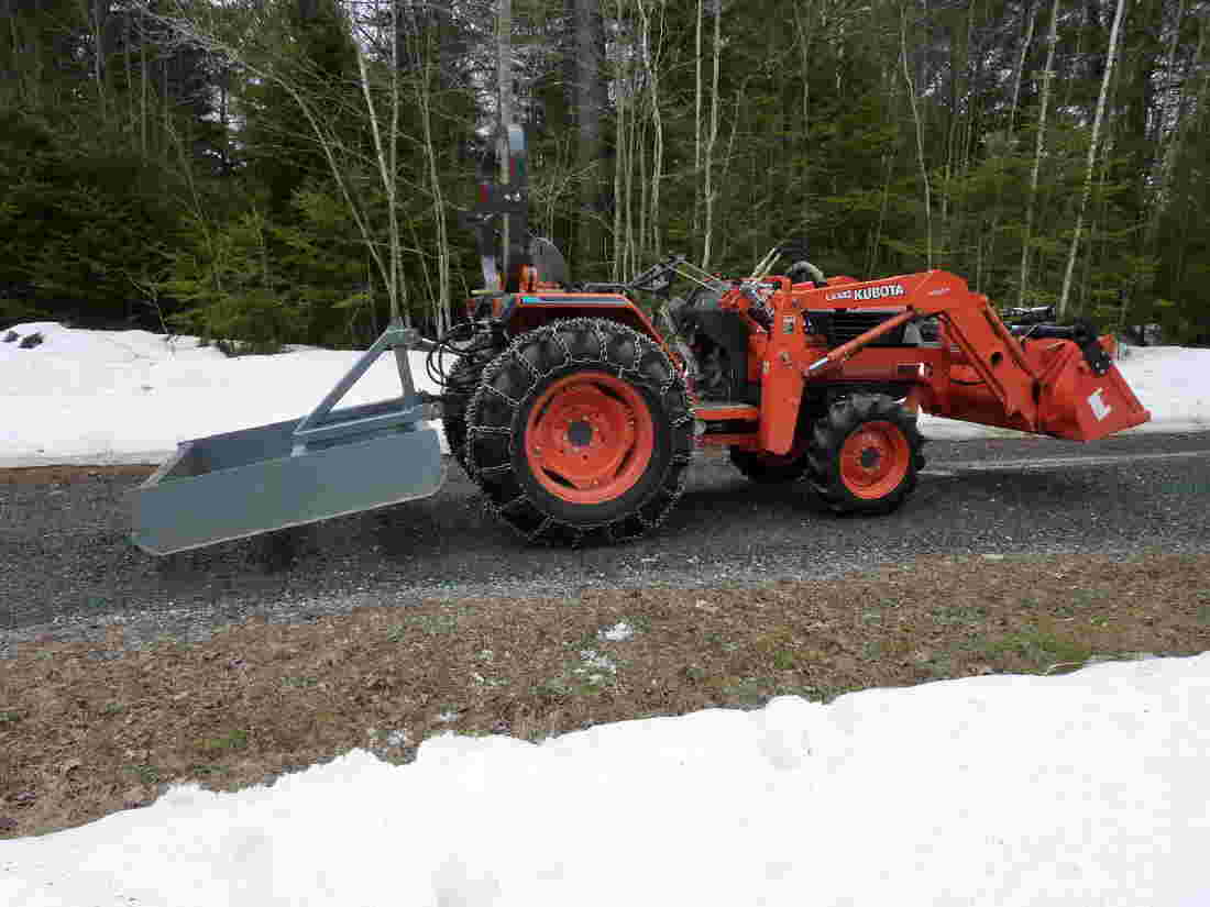

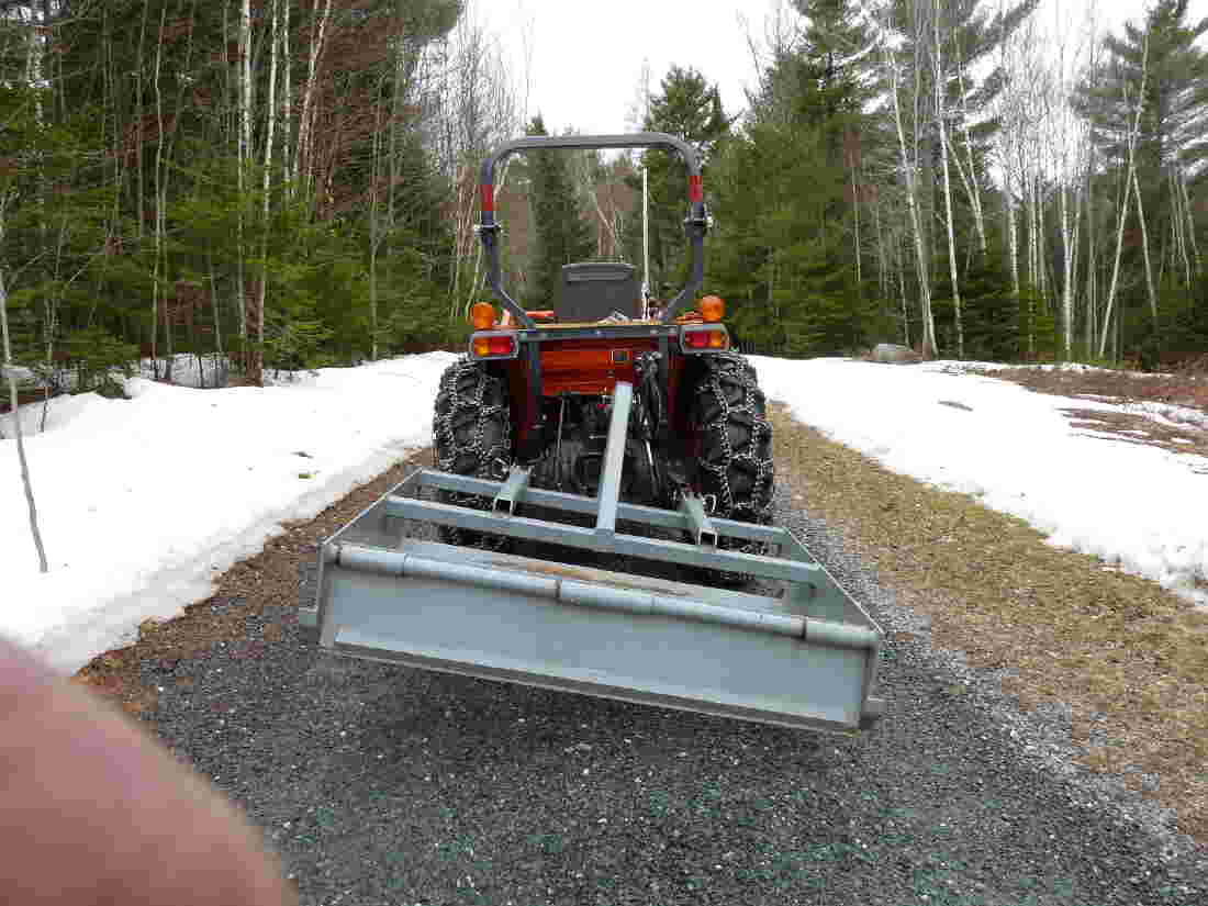

I put my grader on just to see what range of motion I had. The tilt is going to be great using my rear blade and the top link will enhance my grading. The tilt angles the same amount on each side.
I need to learn how to use them now :):) That will be fun
I apologise for the grainy pictures I dont know what happened :mad:

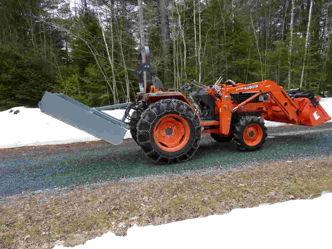

I found one decent picture so you can see what it looks like better if you want.

2 questions;
a) How do you quickly "return to level" with the tilt ?
e.g. do you have to go and find a nice flat piece of road for "reference" ?
I am assuming that there is nothing equivalent to a "position control" on the hydraulic side link.
b) Would it not have been "better" to have kept the adjustable right link and use a hydraulic one on the left side ?
EDIT:
Having looked a bit closer at the pics; You could probably switch it to the left side anyway and regain your screw adjustable right link.
END EDIT:

That is what I did - that is, move the adjustable link to the other side.
It allows for lowering or raising the base height of the implement. That way you can get more "Tilt" if necessary.

Gordon,
I put an equal length piece of pipe slightly larger in diameter than the two pins that hold your top cylinder, one on each side of the pin to help keep it centered on the tractor and in my case the box scraper.
Have you played around with the lower three hole settings on the tilt cylinder?
Enjoy the TnT.

A - I don't know yet - I have to figure that out. I'm not sure it matters if the tractor isn't level. You just work relative to the surface you need or have. Like a guy running a dozer.
B - I plan to switch the adjustable link to the left side like you said
