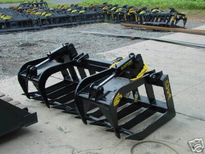

</font><font color="blue" class="small">( Garey - What kind of grapple are you using? Weight? I am looking at both the MarkhamWelding root rake grapple and the ATI. I have a 3130 with the 723 and am concerned about weight )</font>
R_R
I'm using a 60" Piranha Grapple...weighs 550 LB +/- ...still leaves about 1100 - 1200 lbs capacity on your lift...with a 72" boxblade on the 3ph, I can still lift a 17" x 12' fresh cut pine log and set it on my sawmill...and the root rake will uproot everything up to about 2" except for sweet gum..they'll just lay down and spring back up behind the tractor /forums/images/graemlins/mad.gif
This grapple is tough!!...put it on my bud's 90 hp Case HiTrak skidsteer last week, and was taking down pines in the 6-8" range...barely even scratched the paint /forums/images/graemlins/smirk.gif
I will probably sell it later when the heavier clearing is done and get a lighter weight model...I was just worried about bending them while doing the initial clearing /forums/images/graemlins/grin.gif /forums/images/graemlins/grin.gif /forums/images/graemlins/grin.gif
GareyD

   / Installed a V&M Multiplier on L3430 Today #20
I just bought one from Markham Welding 66" wieghs 750#. My tractor has about a 2000 lift capacity @ the pins and 1500# 19" from the pin. Markham Welding is just a few miles down the road from the CO that sells the Piranha. The grapple works like a charm and I can lift some pretty big logs and debris.
However, moving it , curling it empty it feels too heavy and may cause premature wear on my unit. I had to put a 6' box blade and a 8' cross tie on the back. If I was to do it again I would get the lightest unit I could find. There was one on ebay that did'nt look as good but I bet would do non-construction work...like brush and tree clearing. This spring I will try and sell mine and buy the lighter unit. Like this one on ebay http://cgi.ebay.com/ws/eBayISAPI.dll?ViewItem&category=74988&item=3859871750&rd=1
