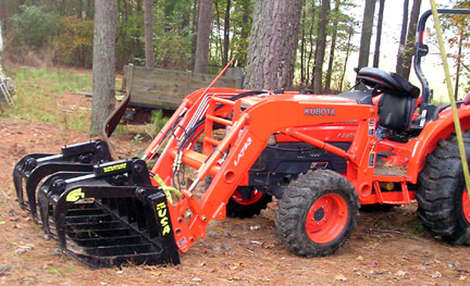

About a year ago, I bought a "Piranha" root rake/grapple to clear up my 10 acres of woodlot.
Using the rear remote hydraulics to power the grapple worked, but it was really aggravating to have to release the joystick, reach back and down to operate the grapple, reach back to the joystick, etc.
From and older post here on TBN, I learned about V&M, called them and was pleasantly surprised with the help and attention that was supplied...ordered the "Add-A-Valve" and finally got around to temporary installation today.
Attached is the grapple on my L3430.

Installation was fairly easy...Unscrew the factory hoses at the top of the steel lines, hook the line into the back of the multiplier valve, then with a short line hook the #1 on the front of the valve back to the steel line and run new line from #2 port to the bottom crossover on the FEL.
Wiring amounted to hooking the four black wires with spade connectors to the valves and finding a key switched positive to hook to the button on the new joystick.

For the joystick they send one already wired with a button to control the valves...simply unscrew the original knob and replace it with the new one....it also comes with some "U" bolts for installation on the rod, but I didn't like the look or feel of them, so I just used some "High Tech" black tape...couldn't find the duct tape /forums/images/graemlins/grin.gif
The loader still works as it always has, with the exception that now I can push and hold the button, curl the bucket, which now closes the grapple...release the button and have curl function on the bucket again /forums/images/graemlins/smile.gif
Sure beats having to reach down for the remote lever beside the seat....
Now all I have to do is have a 6 inch hose remade (I misfigured originally) so I can stack and permantly attach the valves to the loader arm and then reroute the new hoses to their permanent home /forums/images/graemlins/smirk.gif at the rate I seem to get things done around here...it shouldn't take me more than about 3 months to get this done. /forums/images/graemlins/crazy.gif
