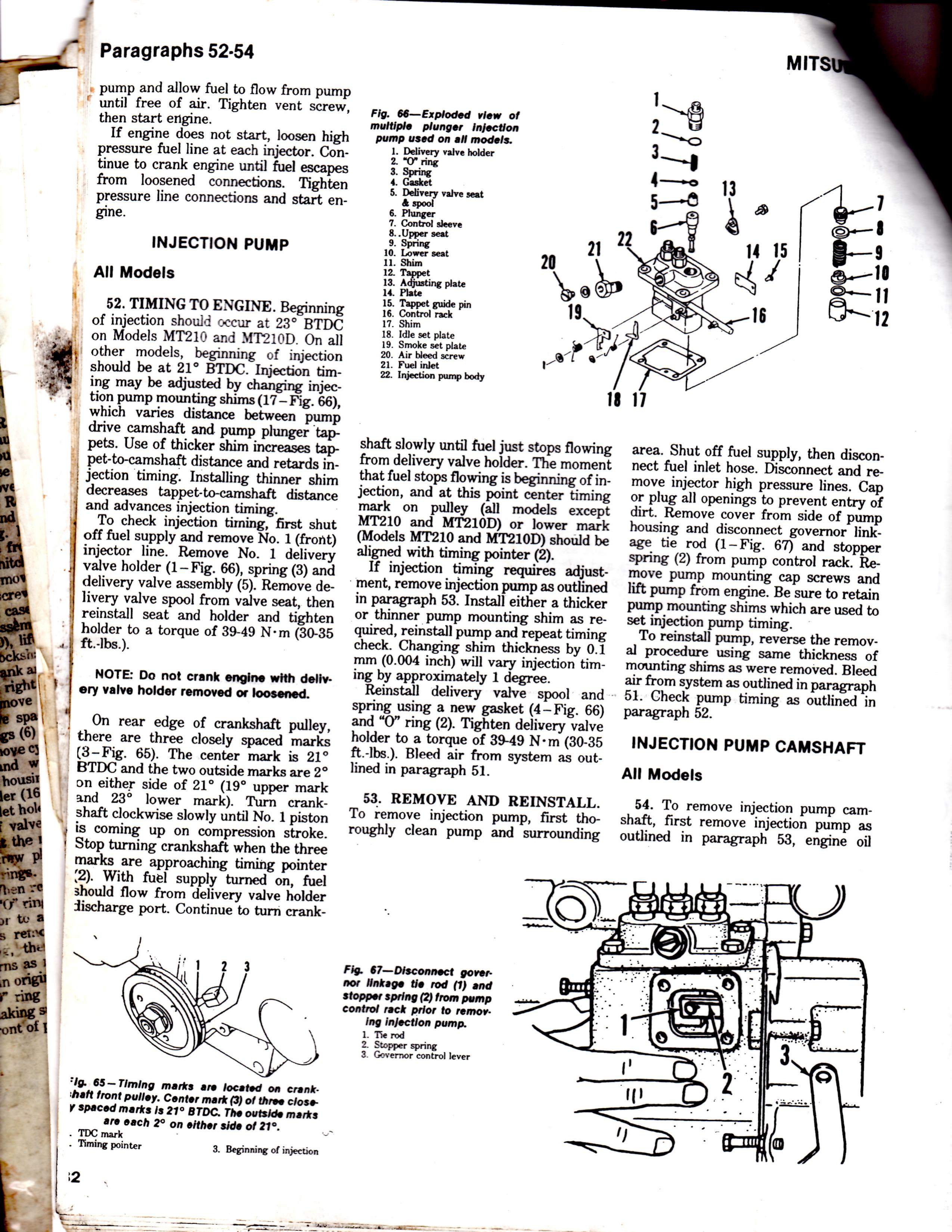

Does any one have any knowledge about the timing marks for a D3250fd Mitsubishi tractor. The injector pump shaft broke at the fornt of the pump and it looks like the gear may have spun. there are is numbers 1,2, 3, marked at different intevals on the idler gear and on the injector gear there is the number 3 stamped on two ajacent gear teeth? Also any help on where to purchase a pump? Thanks for any help. Bill

Scanned this from my I&t manual. Hope it helps.

On my way today to the rebuilder 400 mile round trip. We will see what he can do.
   / injector timing marks
Thanks for the info. If they use the same method of timing on the gears it should be a easy set up.
