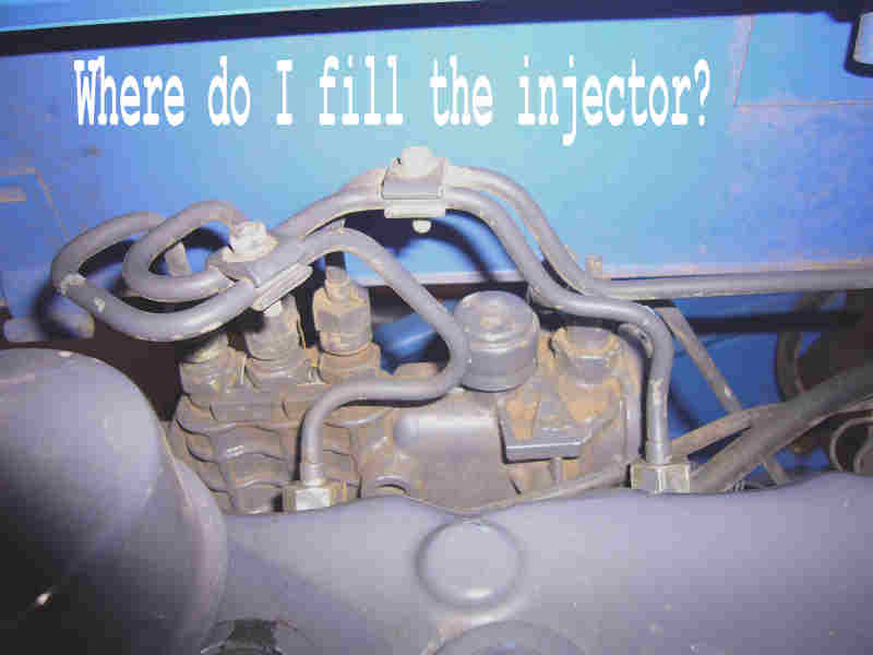

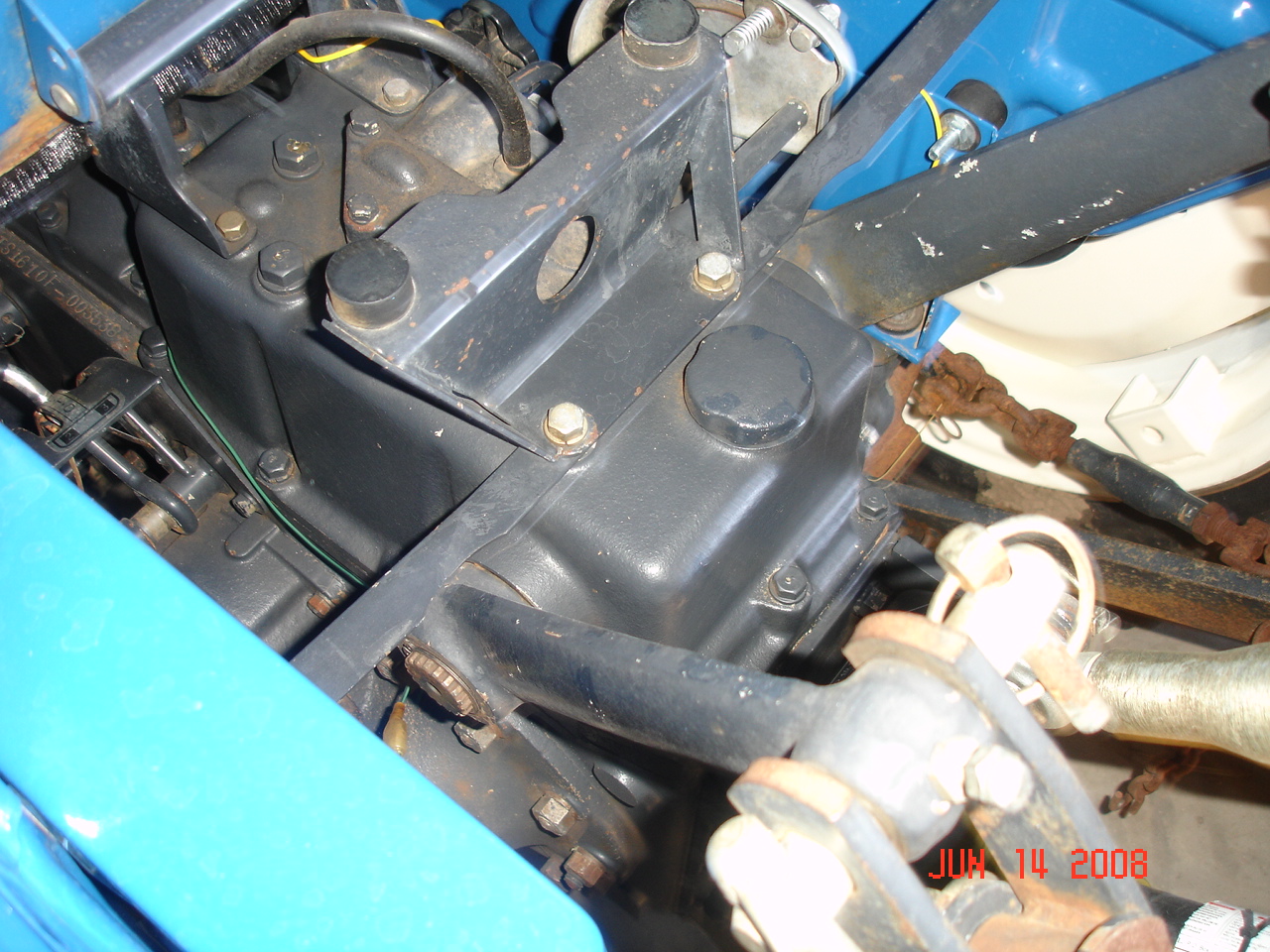

So, I am working my way around the tractor (I still have not found the dipstick for the motor oil, is there one?) changing the fluids.

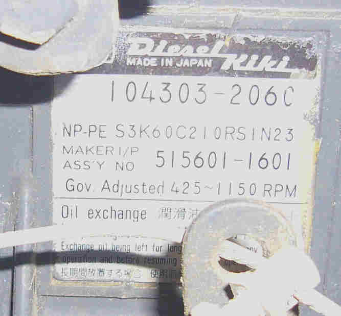

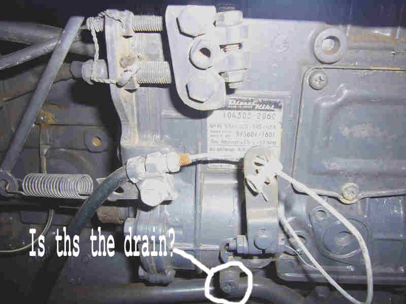

I can not figure out how to change the oil in the injector pump, heck I am not even sure I know where the injector pump is.
I attached a few pictures of what I think the injector pump is. I "drew" on the pictures to show my questions.
Please take a look and let me know what you think.
Thanks again is advance,
Bill

In your picture with the label "Where do I fill the injector?" My guess is the larger round object in the center is the breather cap on top of the pump. To the right of that are three fuel lines.
In the TS1910 manual is says to remove the breather cap when filling the oil. There are two plugs on the side of the pump, a lower one for draining the oil, and an upper one that the oil should be level with.
I would think if the breather is removed you could add oil at the breather or add oil at the check "Level Gauge Plug"

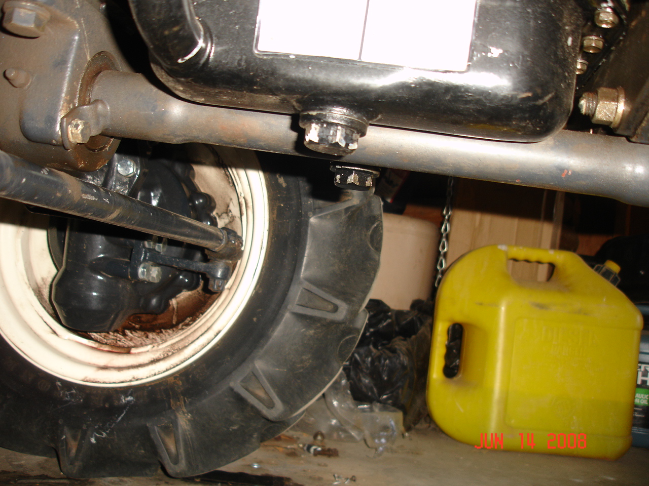

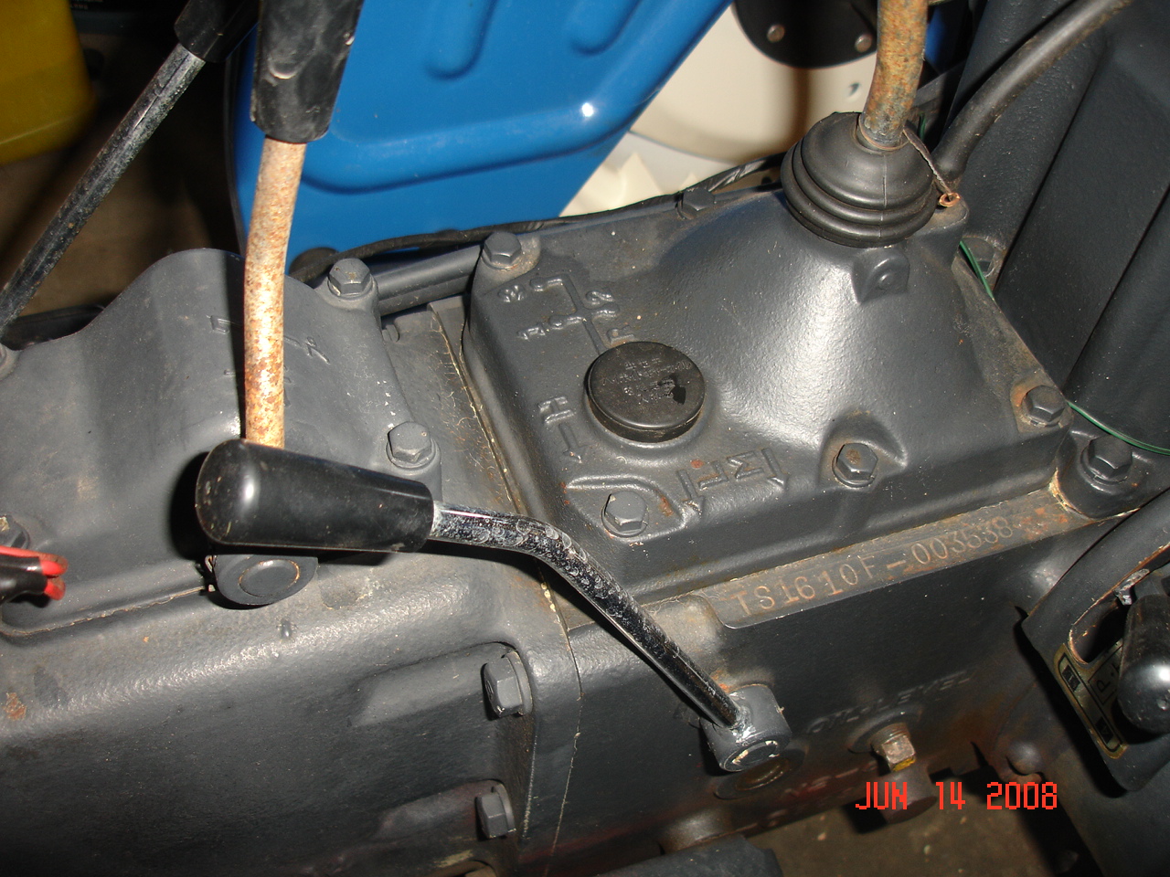

Here are some pics of my TS1610F 4x4, same as the TS1910 or -1910F. I guess I don't have a utility on my home computer to add text and arrows to the photos so I just named the files, pretty self-explanatory. I'll follow this with another reply adding more pics.
The threaded on oil fill cap on the LH bottom side of the engine (off the oil pan) has a dip stick attached to it. You inspect the oil level without threading the cap onto the fill neck, but don't forget to thread it on after you inspect it! You use 3.6 qts. of 30wt oil or like many, 5w-40 Rotella or equal. It fills a lot faster in the oil inspection cap (dip stick) than in the breather cap on top of the valve cover as you normally would in a car.
The engine oil drain plug is on the bottom of the oil pan behind the fill neck (there's one on each side of the pan if it is a 4x4).

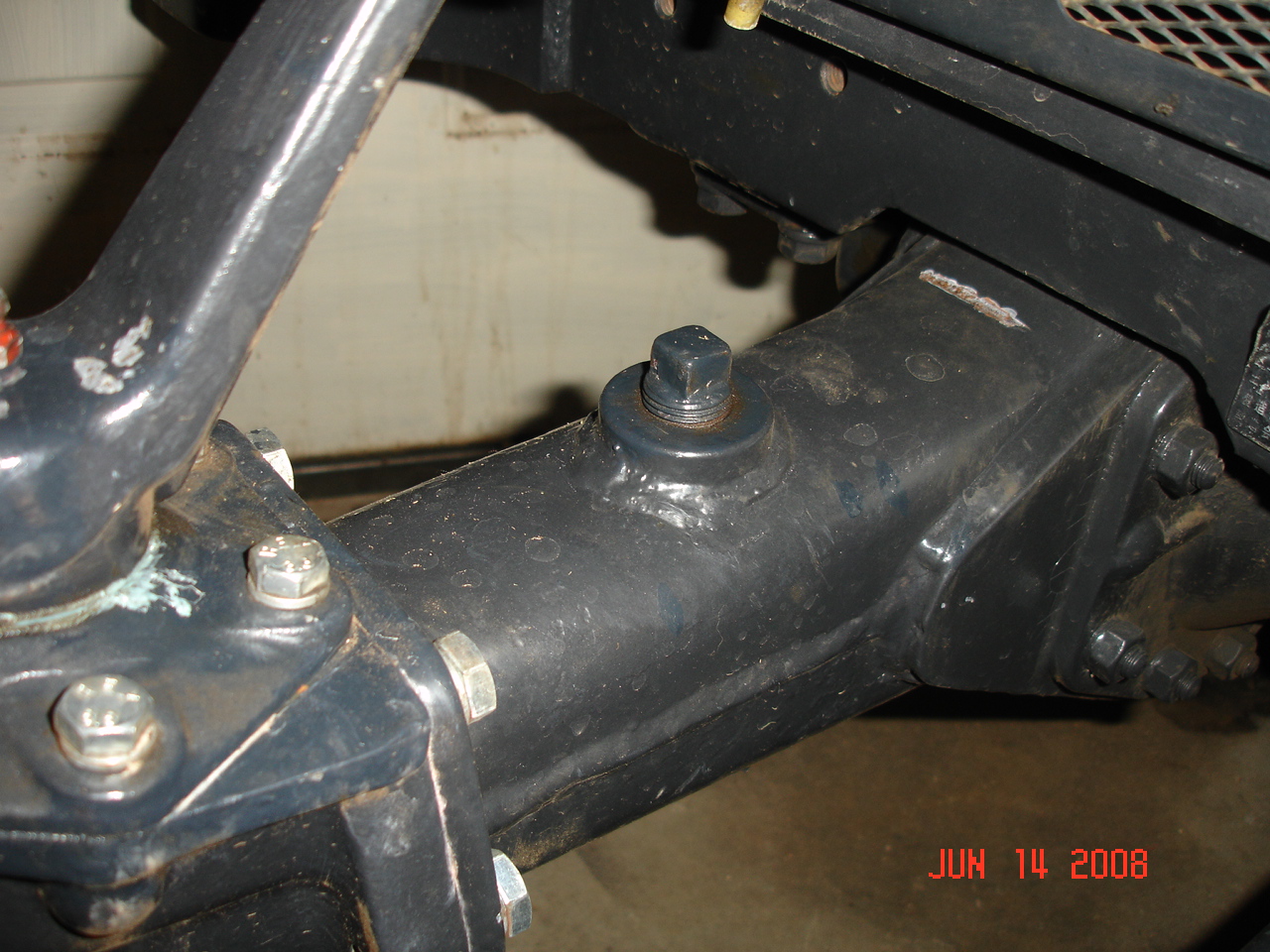

If you have a 4x4, you should remove the plug on the LH top side of the front axle housing and see that there is sufficient 90wt gear oil to just cover the steel axle inside, you'll see it with a flashlight. The axle takes 4.8 qts.

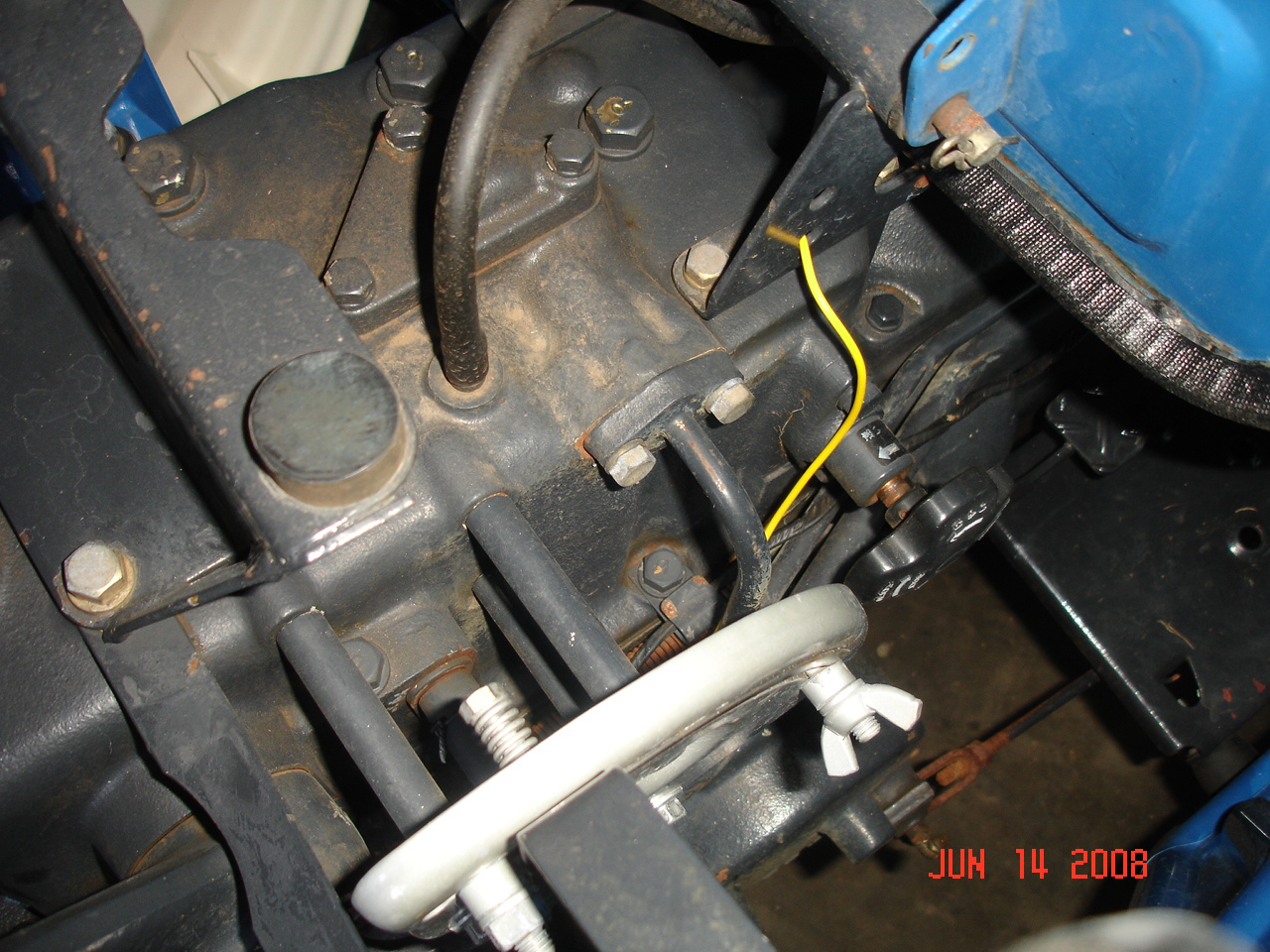

The transmission case fill cap next to the gear shift is where you add 9 qts. (2-WD) or 10.5 qts.(4x4) 90 wt gear oil.

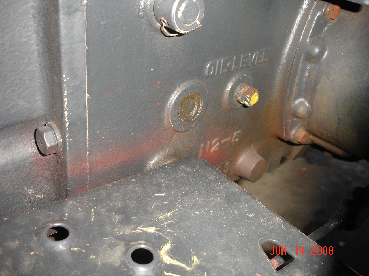

The transmission level is checked by removing that level plug in the side of the case.

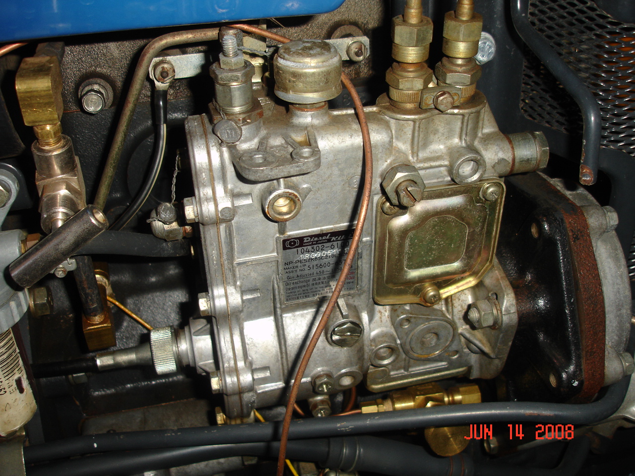

As Rich has shown, the injector pump has two screw plugs near the bottom to drain and check level. The large mushroom shaped vent cap on top is what you remove to fill the pump with 0.12 qts. of your engine oil. But give the oil some time to drain to the bottom before removing the level plug or it will start coming out before it's full.

I figured the cap on the top was a breather that you pulled to fill the injector with but it was not coming off very easy and I was afraid to pull harder.

If you over-filled the front axle, you will most likely be leaking lube down the inside of the front wheels. As I mentioned, only fill to just over the axle, or about half full.
The breather cap on the injector pump is not pulled off, it is threaded on so you need to turn it off with a wrench.

Hi Guys , this is a old thread and my Ts2810 4wd may not have the same front axle assy.
I have the same looking check plug on the axle housing but if you remove the front wheel you wil find a top and bottom fill and drain plug. The two are seperate from the other.
The outer housings have a inner seal that prevent the oil in the axle housing from entering the outer drive housing. You need to check this because just putting oil in the axle housing with a bad seal in the outer housing it will just run out and you wil have a problem with the outer bearing and gears etc. The tractor I bought had this problem.
