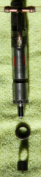

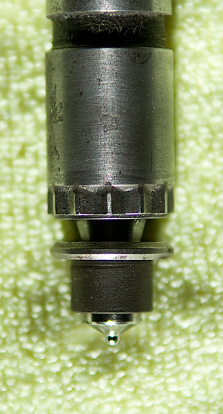

New here so I hope I'm in the right area. I was sent by hoyetractor. Super nice people! I have a John Deere 4410 with a Yanmar 3tne88ejt44. It had two clogged injectors so I took them all out and cleaned them. I used my fuel injector tester and they all spray a good pattern and release right at 3000 lbs. I went to the local JD dealer to get the seal between the injector and the head. Took the old part and an injector with me. They have no idea what part or part number it is. As far as I can tell from the net it's called an injector Nozzle gasket (the metal washer) and a nozzle protector. I found a picture on the net with the washer in a yanmar bag that had the part #119625-11880. No one can find that part #. The injector is 17mm or 5/8" in diameter. Attached two pics. One showing how the gasket goes on the injector and into the head. Someone PLEASE help me.
Thanks
