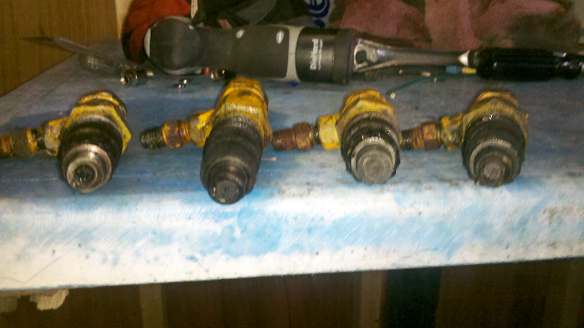

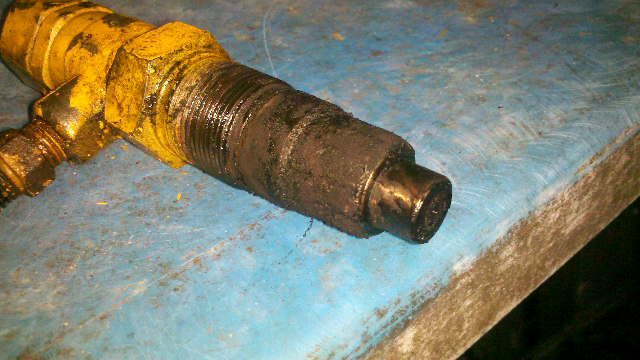

pulled the injector and this is what i have.
In this picture the number 2 injector all the way on the right had oil on it when i pulled it out.

i hooked them all up externally to the injector pump after i cleaned them up. and all of them seemed to have a good spray except cylinder 2. it dripped at first and had a bit of a squirt. i dont know if i cleaned them correctly but i used wd-40 and wiped all the crap away. I couldnt get a hold of a compression tester. so until i do thats where im at.

Willl said:
Swap injector with one of the others and see if that problem follows.
I tested all the injectors off the same injector pump port.
Tomorrow I'm going to test every port.

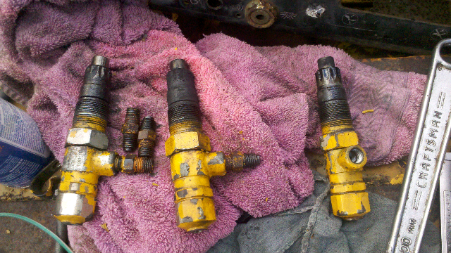

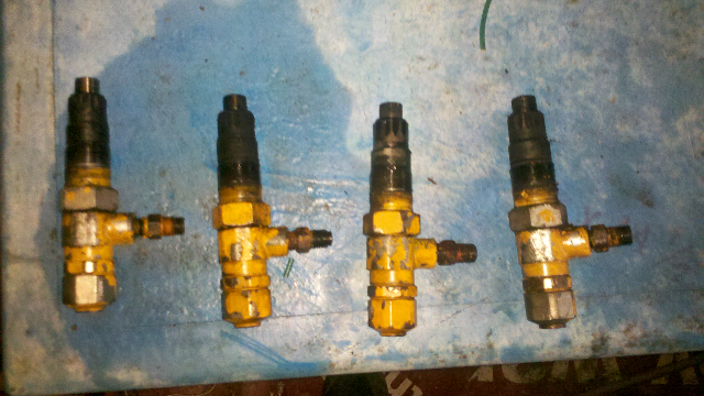

Okay so this is where im at. Took all the injectors apart and cleaned up the internals with Diesel and air. Still smoke no fire...

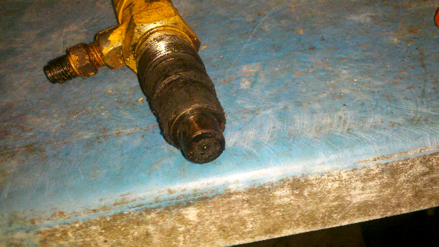

Also when i pulled the injectors it had black oil all over the ends smelled like fuel.
