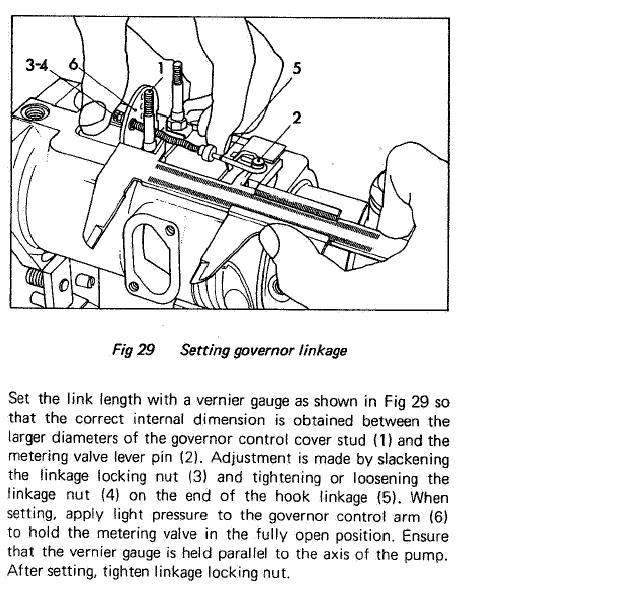

Does anyone know how to determine the correct dimension for Governor linkage length described here. Somehow none of the manuals I found have a section with this specification.
Is there a way to find this out from pump numbers?
CAV DPA 3249F010
SET: pH 30-500-6-3190
