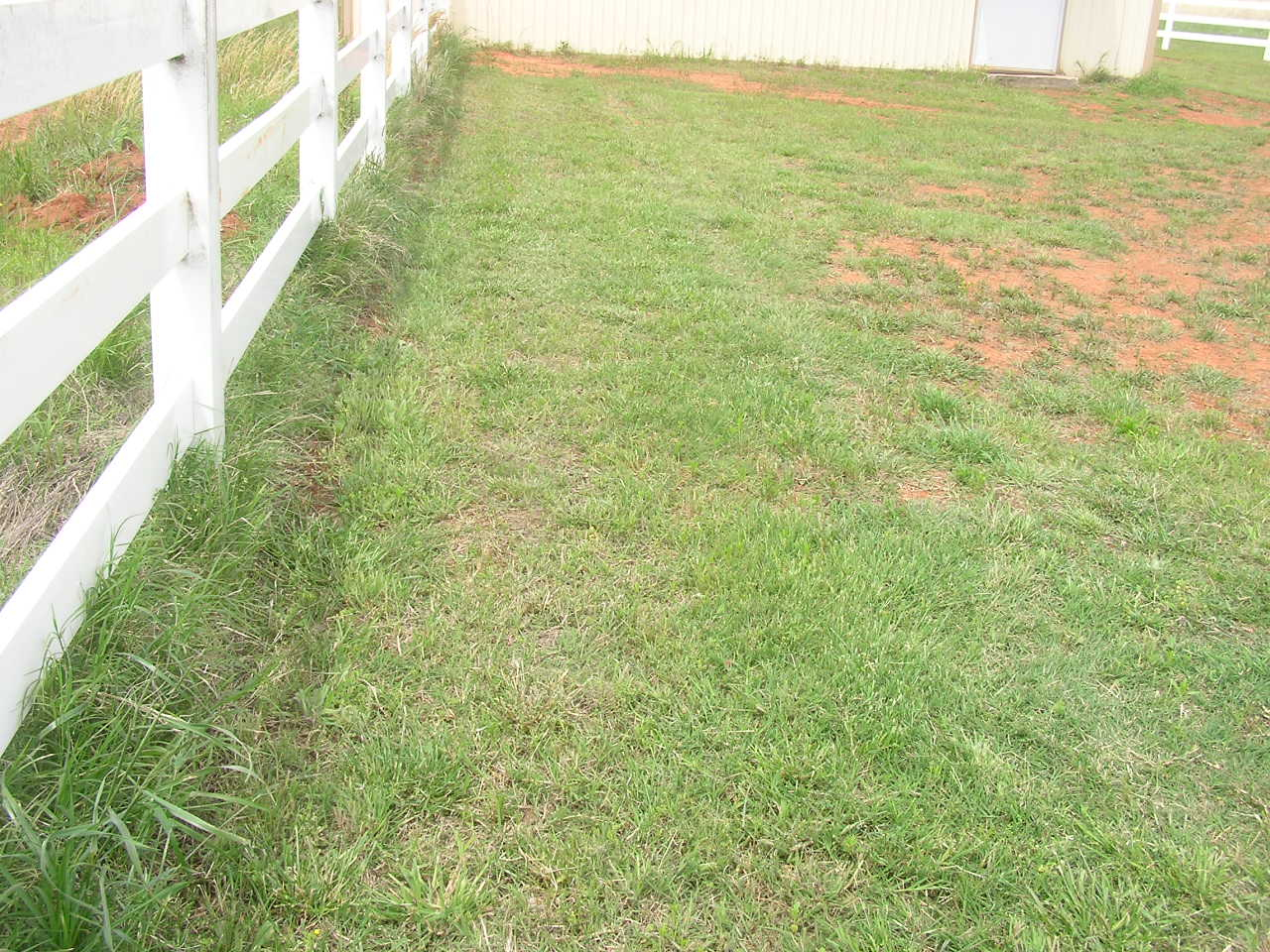

Here's a recent first mowing 3 days ago with a newly purchased King Kutter 3ph RD mower in my back field. So far I'm liking it better than the side discharge ZTR with removed exit deflector that I was using (and beating up :)) Cut is about 4" with the grass being as tall as you see to the right around the tree/junk. The brown spots are weeds/crap, not clippings.
Though there are a couple of places the clippings stayed on top, mostly along the edge, for the most part it looks pretty good.

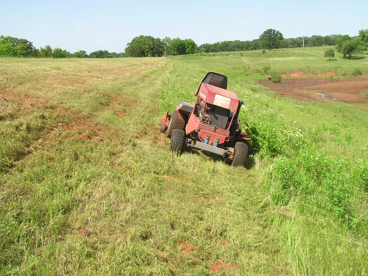

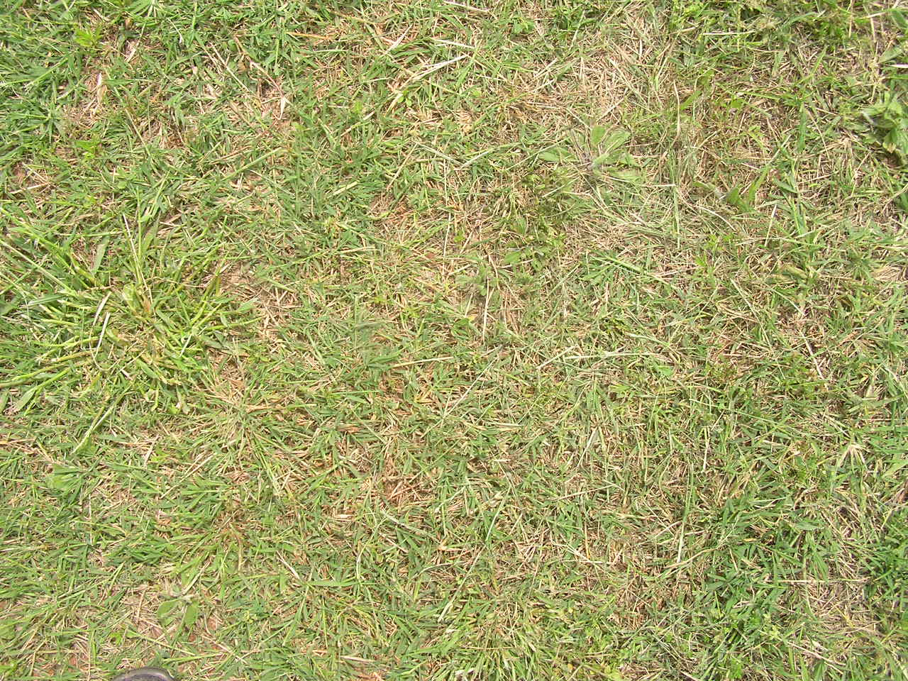

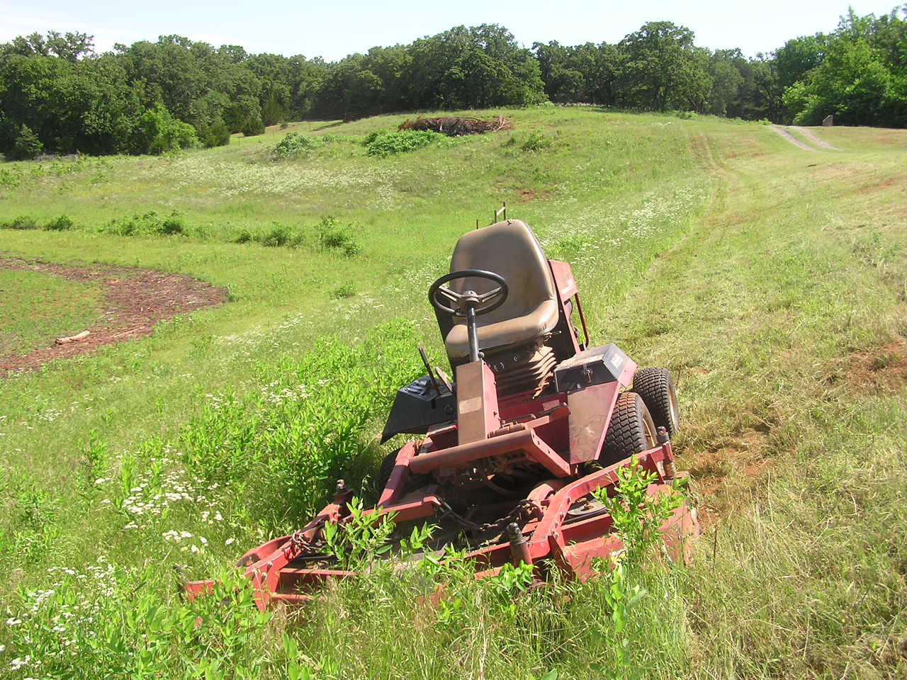

I prefer rear discharge. This one is a six footer:
Mowed this yesterday:

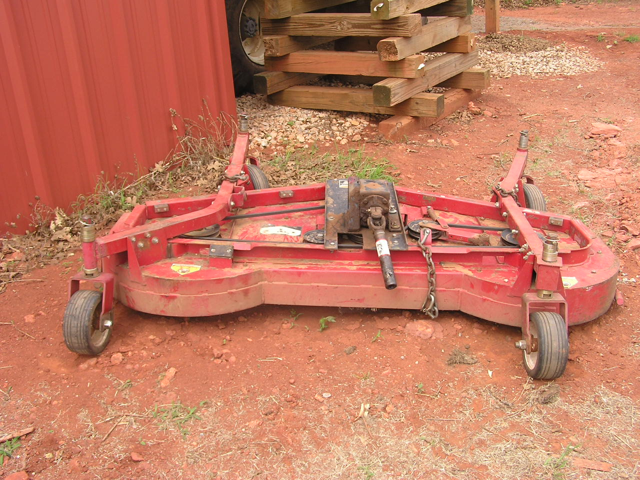

And the TORO six foot recycler with gator blades:
