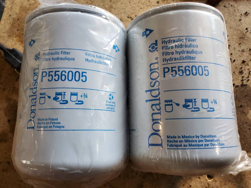

Hydraulic filter:
AGCO #3608996m91
Napa #1664 ($13)
Fleetguard #HF28850
Donaldson #P556005
Wix #51664

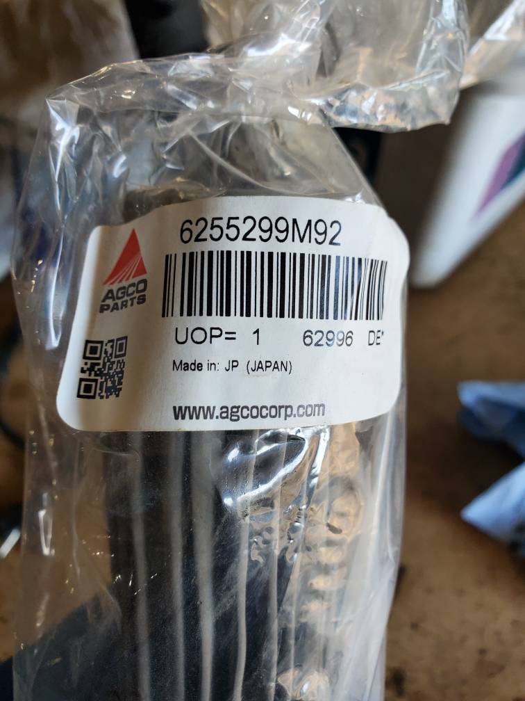

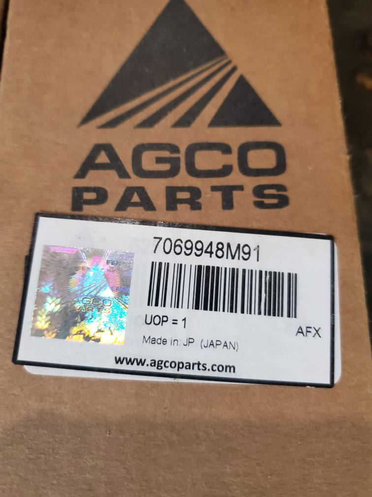

I'll snap photos and post them
