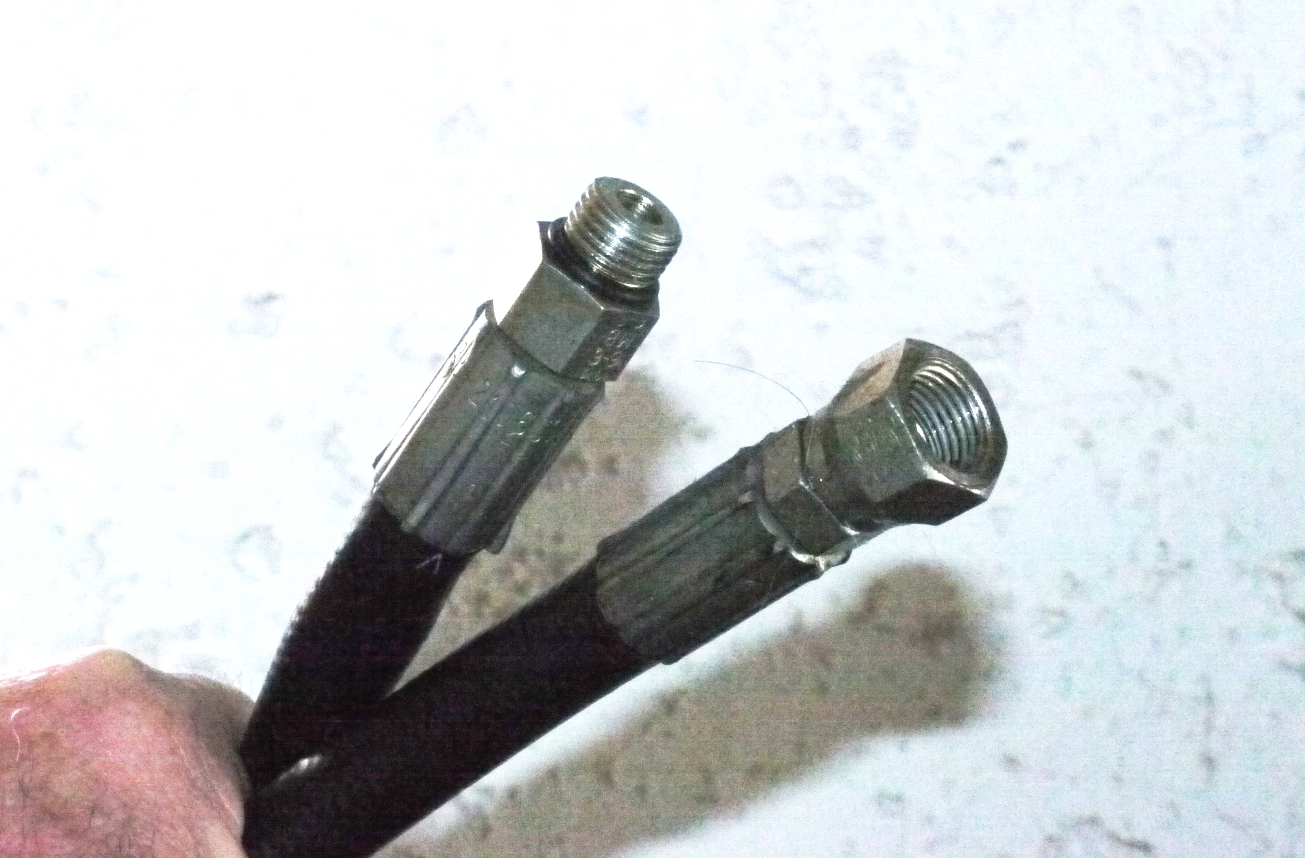

I am looking for info on hydraulic connectors for Mahindra ML112 hydraulic system and am cross posting it here.
Looking to ID the proper termination
Here is a picture.

The one on the left is a Straight Thread O-Ring Boss type of fitting, the other appears to be a swivel flare. Take the assembly to your local Parker Fluid Power branch and they can identify it for you and get you fixed right up.

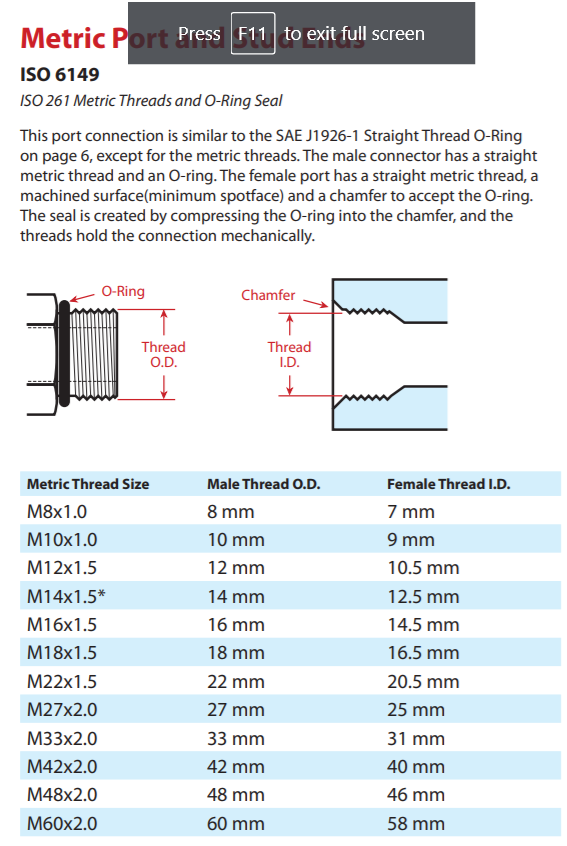

Read the ID book and noticed that my my thread was either 14x1.5 or 9/16x18. Ever try to measure the difference in them with a calipers. They are essentially the same but not as you know.

Yes metric vs SAE is confusing especially on fittings with very similar profile.
Usually threads per inch is the best indicator but not fool proof. some companies have a thread gauge to assist in thread identification

Not having your hose in my hand I would say that mcfarmall has the correct answer on the o-ring fitting,
not seeing the inside of the female swivel my first inclination would be JIC.

Yeah they are close, but (for external threads, at least it can be done with a digital caliper (and usually a calculator) - the way I do it is to use the inside (pointy) ends of the caliper - get in front of a light colored background, use as many threads as are available, measure either from peak to peak or trough to trough of the threads, divide that length by the # of threads you measured; it's easier if your caliper allows switching between inch, fraction and mm.
Example - if you're lucky enough to have a full ten threads showing, you can just measure that and divide by 10. If they're metric, you should be done. If inch, obviously you would (in your example) have exactly 9 threads in .500".

Actually there are only about 4 threads that I can reach with the calipers. I got 1.46mm So is it 1.50 or 1.41 mm? In a world called perfect the thread would have a sharp edge. but it doesn't. I will check the end that is sticking out of the hard line.

What I do quite often with the straight thread fittings is go stand at my bolt bin and check them with bolts and nuts both SAE and metric

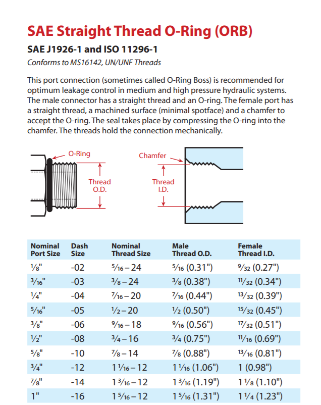

The left one looks like a MB fitting.....look for numbers on it.
MB = Male Boss; threaded fitting with an O-ring seal. MB is also
called SAE Strait Thread or “-AN”.
The other looks like a JIC
