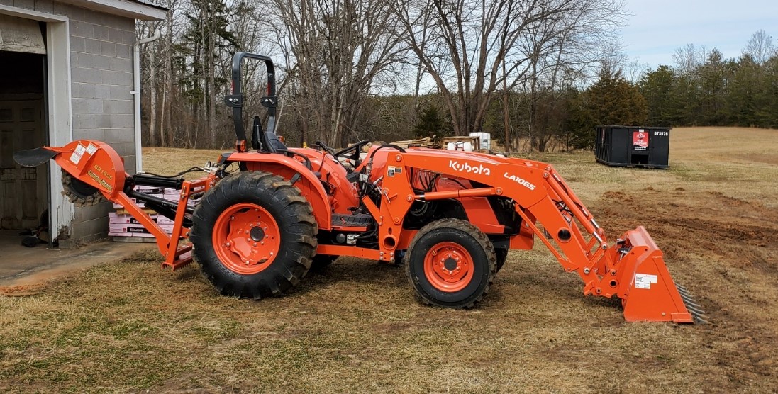

/ Independent PTO or gear driven #5
When running this stump grinder, live pto is the only way...
