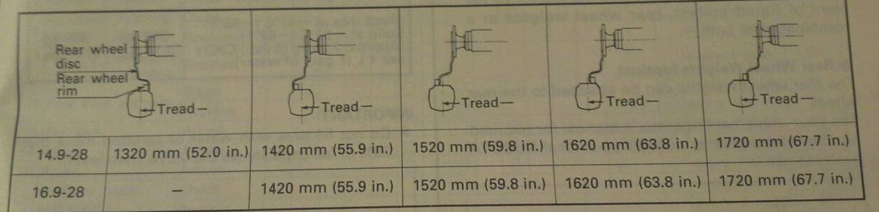

On my M4700 I've got about 5 combos of rim and disc to adjust spacing.

You can move the center hub flange to the inside and gain about 4-6 inches on width.
   / Increasing width of rear #6

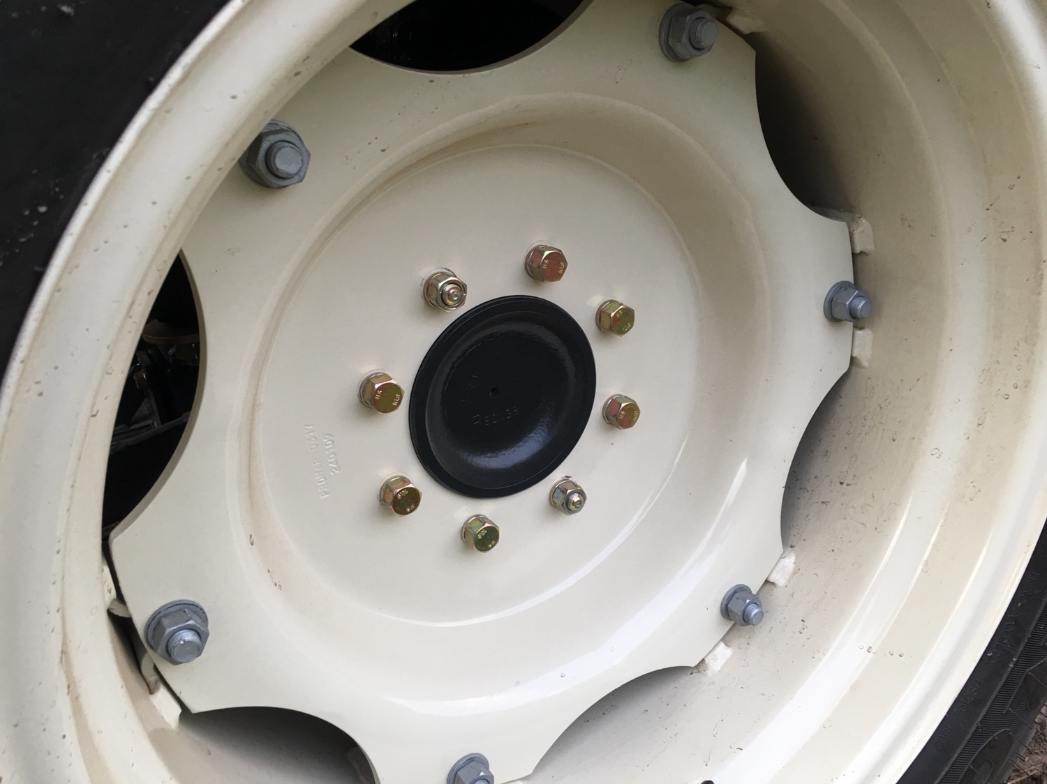

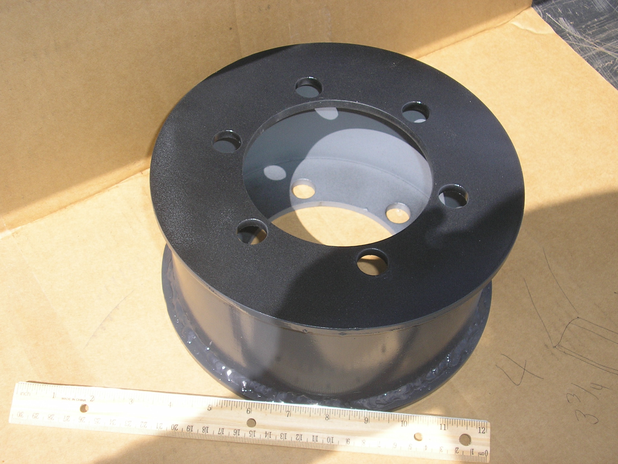

If it helpshelps visualize it, your rear tires can be mounted in different configurations to give you different spacing. Simplest is to look at the rim and see the "dish" in the center. If the dish is on the inside, the rim can be reversed so the dish is on the outside which gives you a good few inches. That's the simplest and cheapest way. Can you take a photo of your rims and post it fit us to look at?

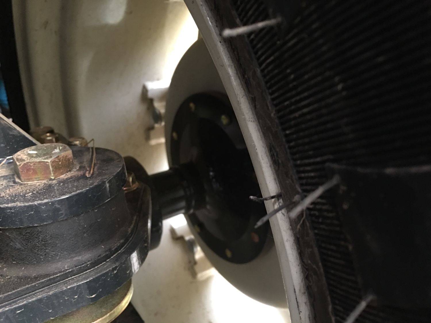

It looks as if I could swap sides with the tires and gain some width.IMG_3607.JPGIMG_3608.JPG

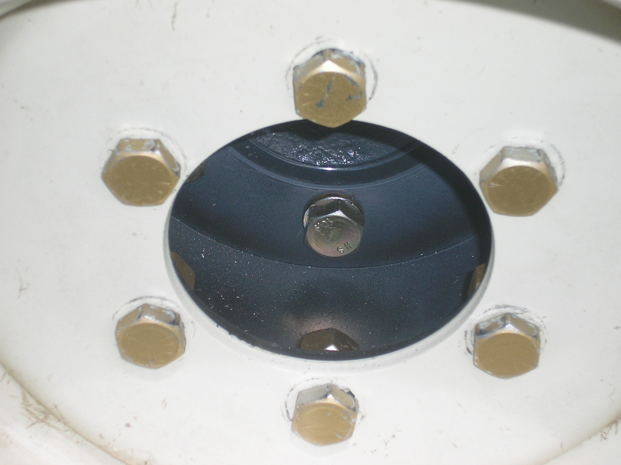

With your rims if you unbolt the outer section then rotate the inner and move the outer section out you will gain the width of the mounting which is usually 2-4 " on each tire,
which is what posts 4 and 5 mentioned.
If that is not enough adjustment then the rims can be flipped around as they are usually not centered with the mounting tabs.
Providing you with several optional spacings.
