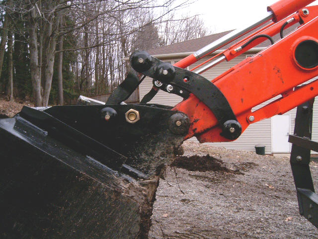

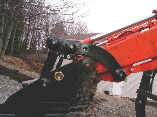

alright. there are no before pics but this is the curl after the modification. the brackets are brown. i couldn't get the 'float' on video but I'm hoping that you guys will say that the curl is about normal... either way, i did lift a few tons of dirt with it which makes me want a bigger bucket.. anyways hope you guys are doing good.

Nice job on fixing that angle. Do you think you could post some close ups of the bracket. I have the same problem with the same bucket. Thanks.

Hi, Its not pretty, but i could've grinded it and painted etc etc... but yes i'll send post a few pics to give you a closer look off hand i'd say it was about 5" from the previous hole. let me get a shot or two for you.

It wasn't much but it did the trick.
didn't touch the top hole at all.. good luck

That looks great, thanks for the pictures, I will let you know how mine turn out.
