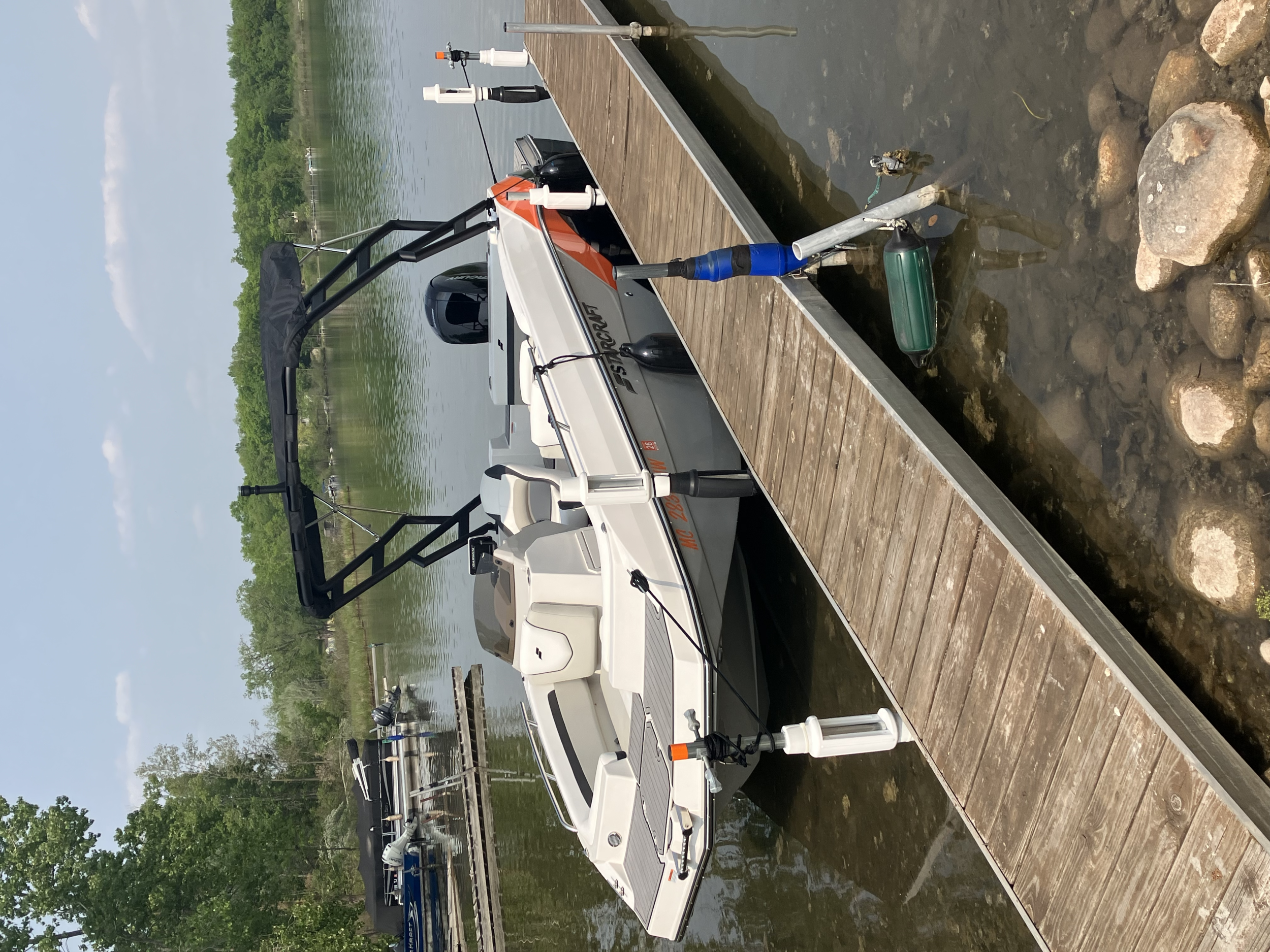

What is better in board boat motor setup merc-crusier or Volvo penta?Thanks for any info..
No ski tower.
